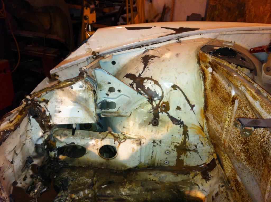

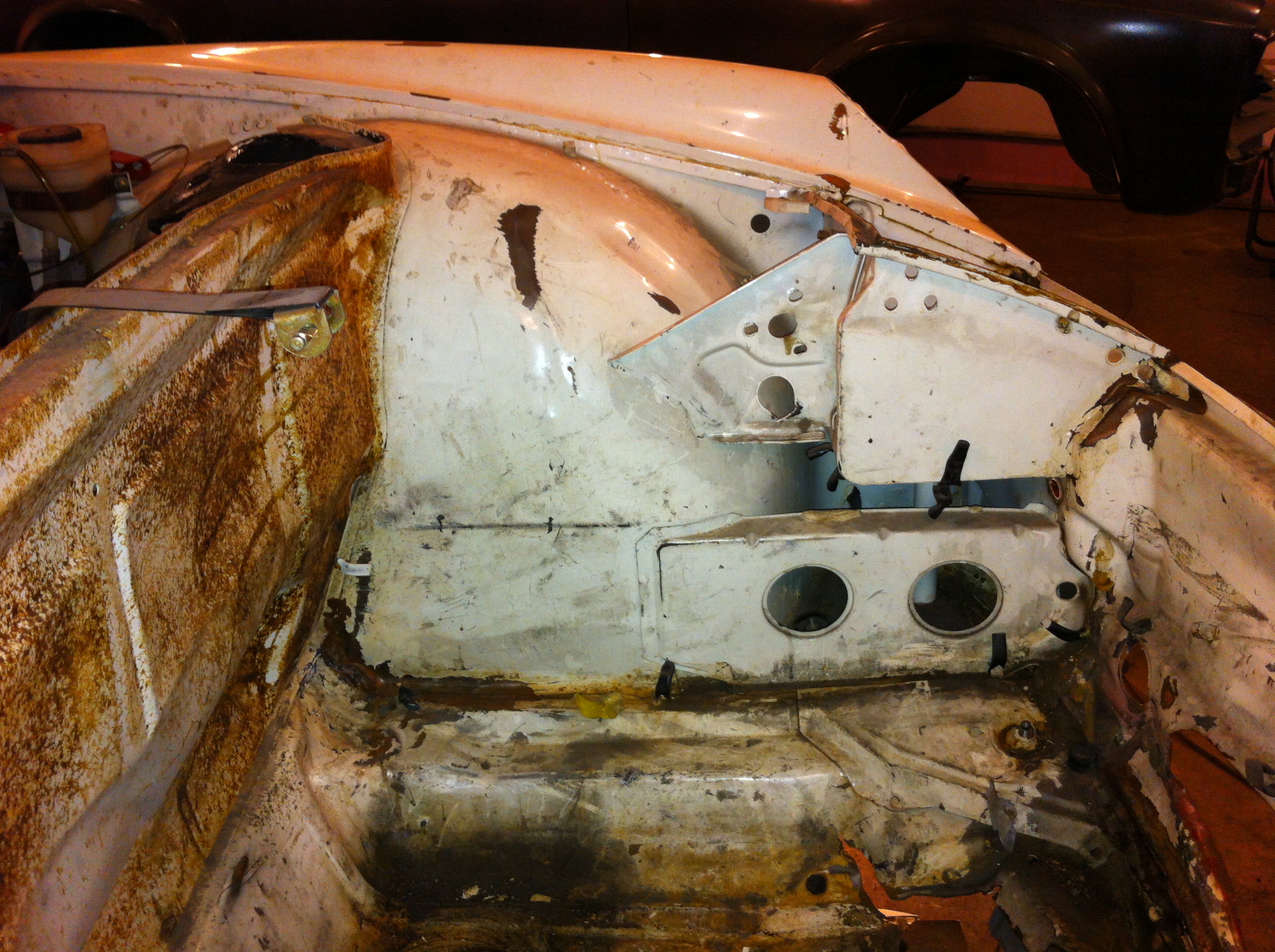

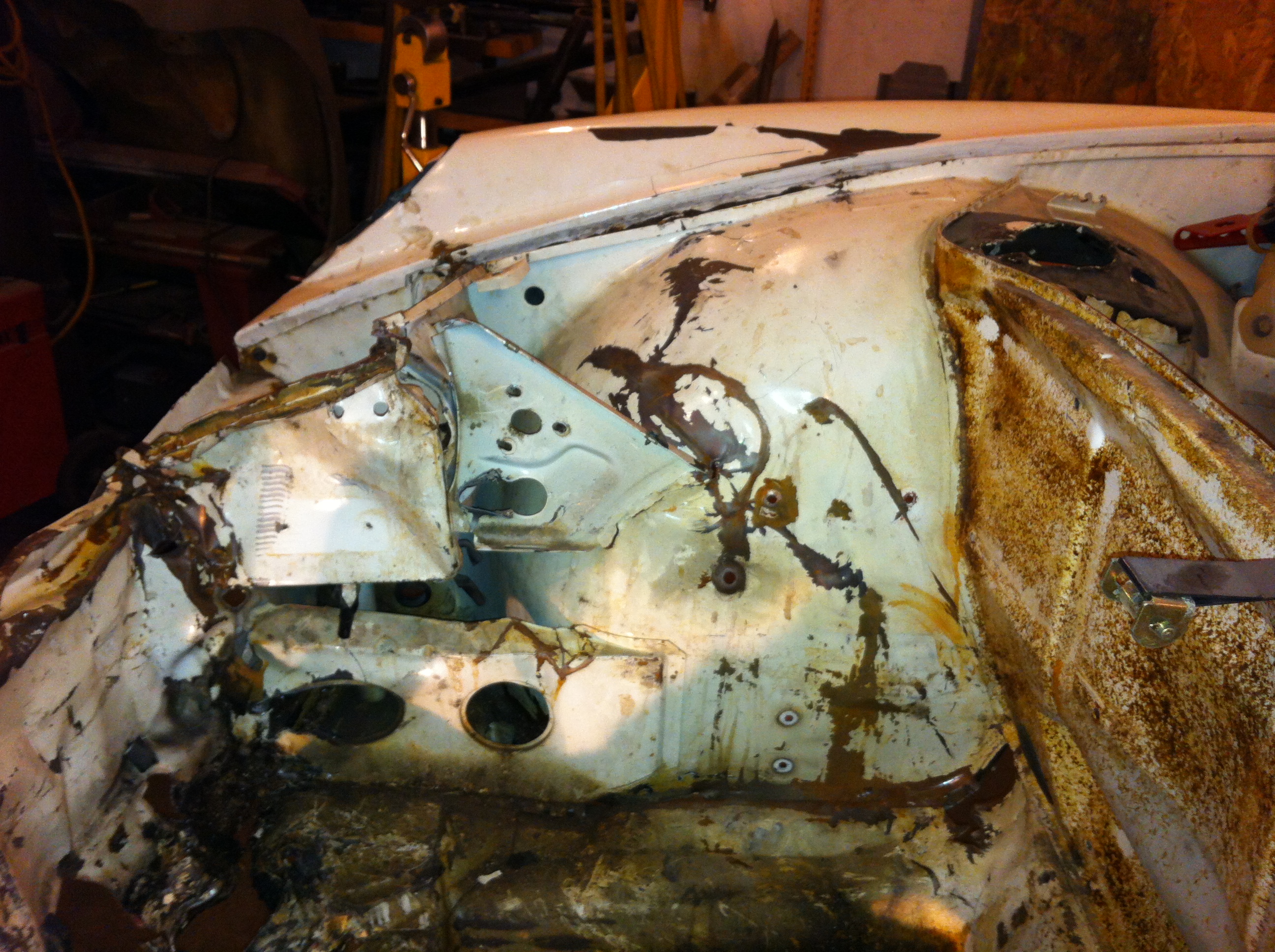

The car is set up on the Celette. There is a set of 4 clamps that are attached to the pinch flange on the bottom of the longitudinal members. They are tightened with an impact gun. During the pulling process I actually pulled the car out of the forward clamps several times. The pinch flange on the 914 is pretty small. Sometimes You have to weld an angle iron the chassis to get a good hold. I used a second set of chains running through the strut towers to help hold the car down during an upward pull.
Both inner wheel houses were kinked very deep. More on the right than the left Both the right and left wheelhouses where they arch over the rack had closed up and the pinch welds were split in several places. I have to say I am impressed the way the chassis took the impact and specially the way I was able to move the damaged metal back into place.
Some may say...Eeek! That looks like crap! Have no fear. Once I remove the front panel. the right and left fenders, the headlight buckets, the floor pan and the gas tank bulkhead I will be able to us an air powered planishing hammer on the damage and smooth it all out. Here's a link to some hand work I did before I got my hammer.

rick 918-S   Here's a few photos from our initial probing. ...   Oct 24 2013, 09:17 AM

rick 918-S   The car is set up on the Celette. There is a set o...   Sep 13 2015, 09:53 PM
