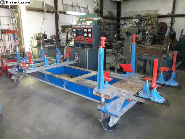

These are the towers for the newer models. They are generic for many models, you own them, then rent the top and bottom portions from Celette for your specific application. The red parts in the next pic are what you rent. Last pic is the actual 914 parts for the older benched like Ricks and one I'm looking at. I'm also pricing out to build one from scratch and so far, when I calculate my time, the materials, and the possibility of surface grinding the whole table, + the plates welded onto it, it makes the cost of a used or even new Celette look pretty reasonable (IMG:style_emoticons/default/sad.gif) You want to know anything about Celette's just ask....I've got more pics then you can shake a stick at. Rick and I have been going over this issue for quite a while now (IMG:style_emoticons/default/dry.gif)

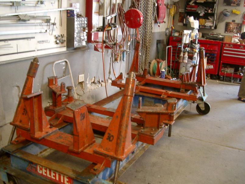

rick 918-S   Here's a few photos from our initial probing. ...   Oct 24 2013, 09:17 AM

McMark   Gonna rent fixtures for this one? Looks like fun....   Oct 24 2013, 09:25 AM
ConeDodger   Gonna rent fixtures for this one? Looks like fun...   Oct 24 2013, 12:47 PM
worn   Gonna rent fixtures for this one? Looks like fun...   Sep 15 2015, 10:46 AM
rick 918-S   Mark & Scotty, Yes. I will rent fixtures for t...   Oct 24 2013, 09:47 AM

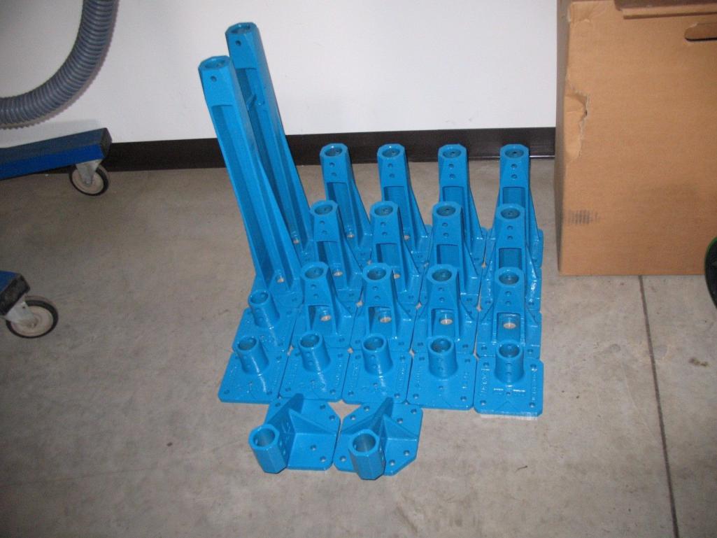

Jeff Bowlsby   What do the towers look like Rick? Do you have th...   Sep 14 2015, 01:24 PM
scotty b   These are the towers for the newer models. They ar...   Sep 14 2015, 01:38 PM
rick 918-S   Thanks for posting that Scotty. Yes, I just contac...   Sep 14 2015, 02:26 PM
