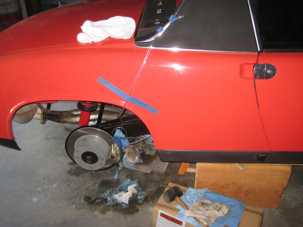

I kept drawing out old brake fluid and topping the car's brake fluid reservoir up with the DOT 4 fluid I purchased from PMB. I like the Eastwood brake bleeder's vacuum gauge as it ensured I had good vacuum while I did this operation.
Once I was satisfied that I had new clean fluid coming out I used the technique on the PMB tech page to ensure I had all the air out of the lines. I put a 7mm spanner on the bleed valve first. Then I taped another section of the clear 3/16" ID vinyl line to the car in several places and ran the line to the bleed valve. Be sure the line extends higher than the car's brake fluid reservoir! I cracked the valve open and watched while the fluid rose in the line until it reached the height of the car's fluid reservoir. I used a rubber mallet to tap on the new caliper to ensure any air trapped in the caliper would be released.
I was happy to see there were no air bubbles rising in the vinyl line and once I had verified that I had the air out of the line I closed the bleed valve and after draining the fluid in the vinyl line moved on to the driver's side rear caliper. Same procedure for the front, starting on the passenger's side and finishing on the driver's side.
A couple other notes: I taped over the caliper to ensure no brake fluid could drip onto the new pads. I also used a lot of paper towels stuffed below the bleed valve so any fluid that might weep from the threads of the bleed valve would be sopped up. Be careful that you don't get any brake fluid on your paint - brake fluid will eat paint!
