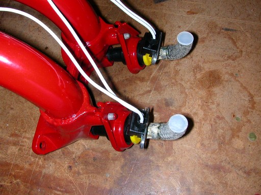

My #4 fuel injector connector on my '70 1.7 is routinely coming loose and falling out of the injector. I'd like to get a new connector to put onto my harness. Anyone know where I can get these? I'd rather not have to solder to the injector connector tabs (IMG:style_emoticons/default/wacko.gif)
-Tony

crash914   You can get the original D-jet type connectors...g...   Sep 18 2004, 07:35 AM
gklinger   Napa has the D-Jet connectors, part no. 2-17424. ...   Sep 18 2004, 05:20 PM
