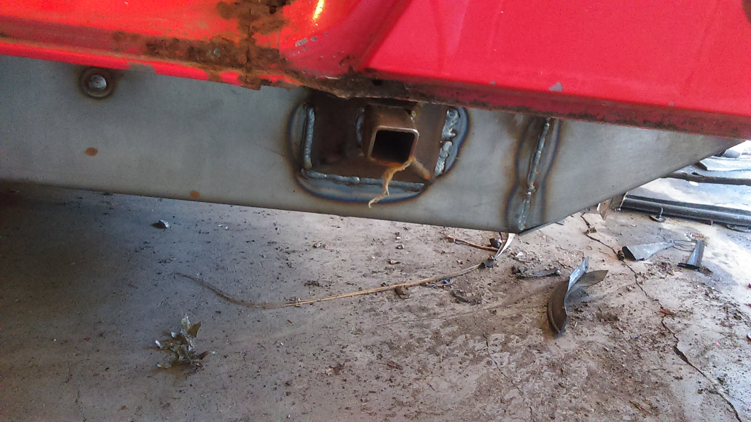

Stacks914   Anyways this project is back on....currently. I r...   Sep 28 2016, 12:49 AM
Stacks914   You can see in the last picture I have bent the re...   Sep 28 2016, 12:54 AM
Stacks914   Here suspension is put this under the car to get a...   Sep 28 2016, 12:58 AM
Stacks914   I think I might be able to get away with 3 inch fl...   Sep 28 2016, 01:10 AM
