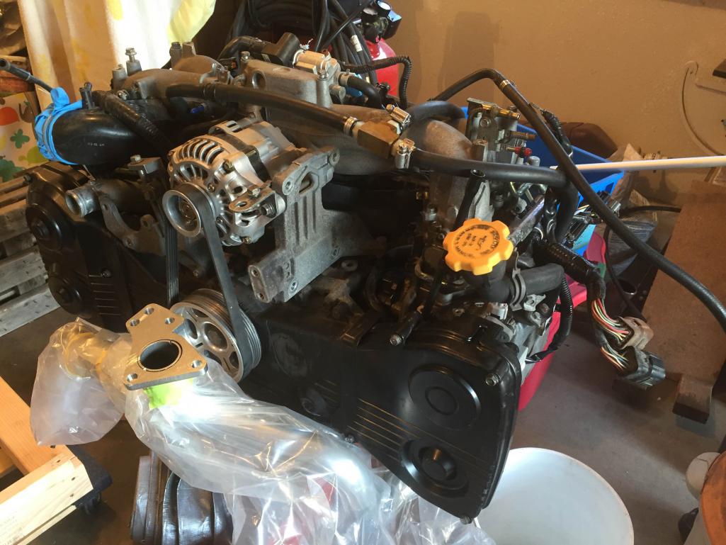

madmax914
post Oct 1 2015, 11:43 AM
Posts: 204
Joined: 16-February 14
From: Salem, Oregon
Member No.: 17,007
This is the motor, 2004 2.0L WRX turbo motor with 55,000 original miles. I picked up this motor from Jrust, Thank you Jamie!
