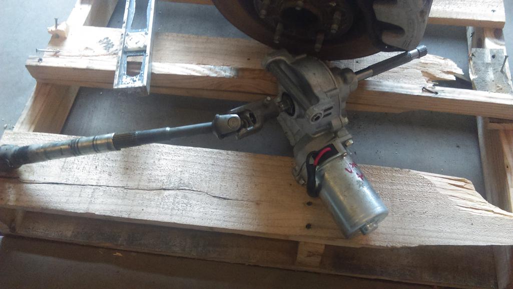

Got a power assisted steering column from an 05 equinox $50 at a junkyard. EBay has a kit that controls it. You can dial in more or less feel it's 75 shipped. Not a bad deal

Mueller   Neat PS controller.... For the suspension, how do...   Oct 11 2015, 10:38 PM
Stacks914   Thank you the bottom of the ps column fits right o...   Oct 12 2015, 01:59 AM
