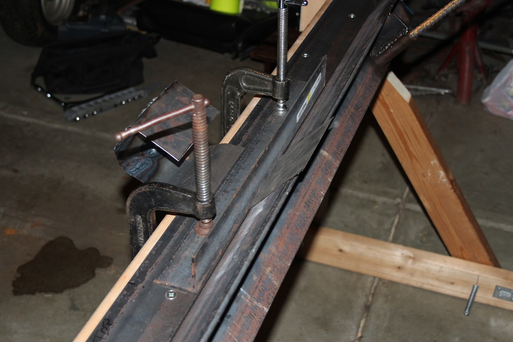

Took these after dark, hope they show it well enough. The brake is just three pieces of angle iron. Two are hinged together and bolted to the stand, the third is used as a clamp. This is what it looks like set up with a small test strip:
Once the sheet is clamped in place, you just lift up on the handles like so:
Of course it's going to spring back some. You can find tables that tell you how far to bend it so that it springs back to the angle you want. You can also muscle it after the fact.

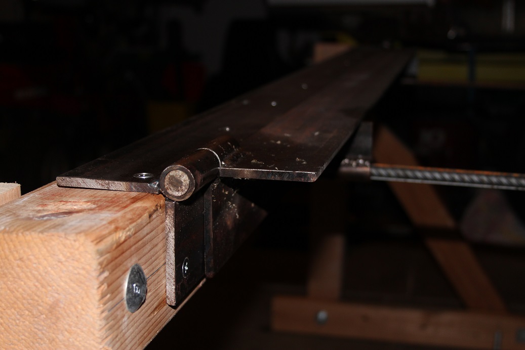

Here's a close shot of the hinge. It's very simple.

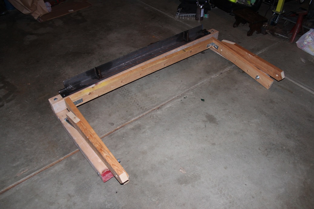

And the best part is, it folds up!
