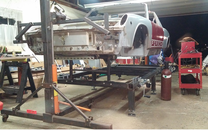

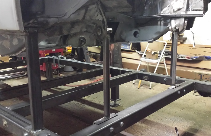

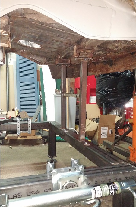

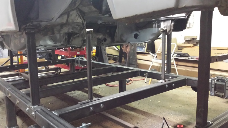

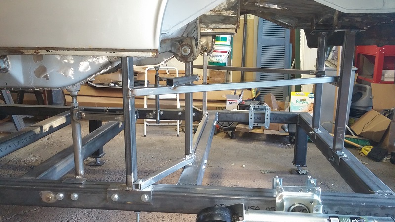

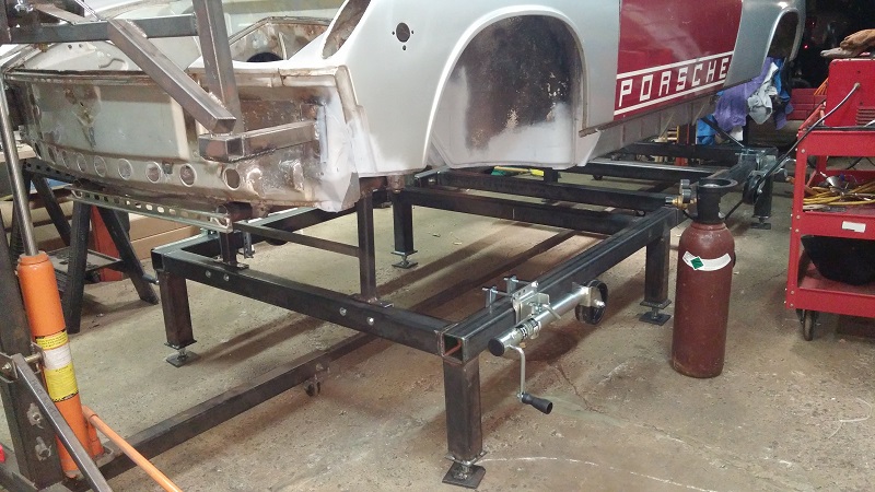

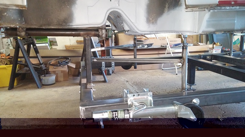

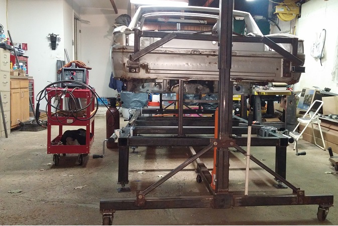

Started building the chassis jig and the brackets to attach the 914 to it.
Got the jig and 914 leveled out. Started to build the mounting brackets. I should be able to finish making them up today. (IMG:style_emoticons/default/sawzall-smiley.gif) (IMG:style_emoticons/default/welder.gif)
