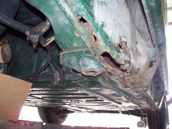

Luke M   Here's a few pics of the car when it was purch...   Jun 22 2013, 11:44 AM

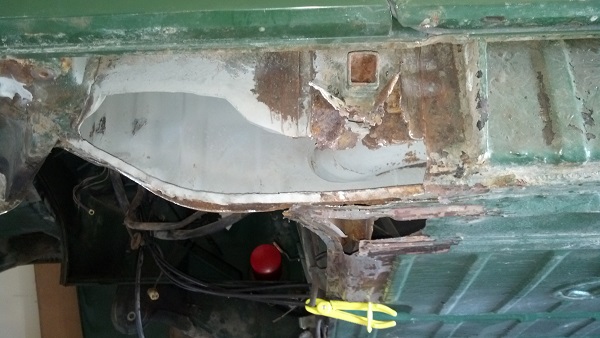

Luke M   Rust repair in the works.. :sawzall: :smash: :w...   Jun 22 2013, 12:26 PM

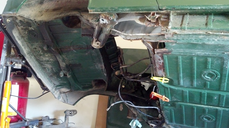

Luke M   Replacing the r/r inner control arm mount was a re...   Jun 24 2013, 07:08 AM
