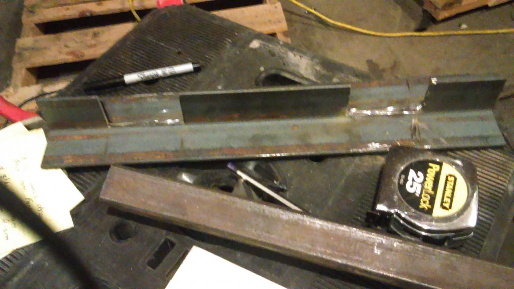

Stacks914   Only a few hours today got front a arm supports st...   Oct 11 2015, 08:06 PM
Mueller   Neat PS controller.... For the suspension, how do...   Oct 11 2015, 10:38 PM
Stacks914   Thank you the bottom of the ps column fits right o...   Oct 12 2015, 01:59 AM
