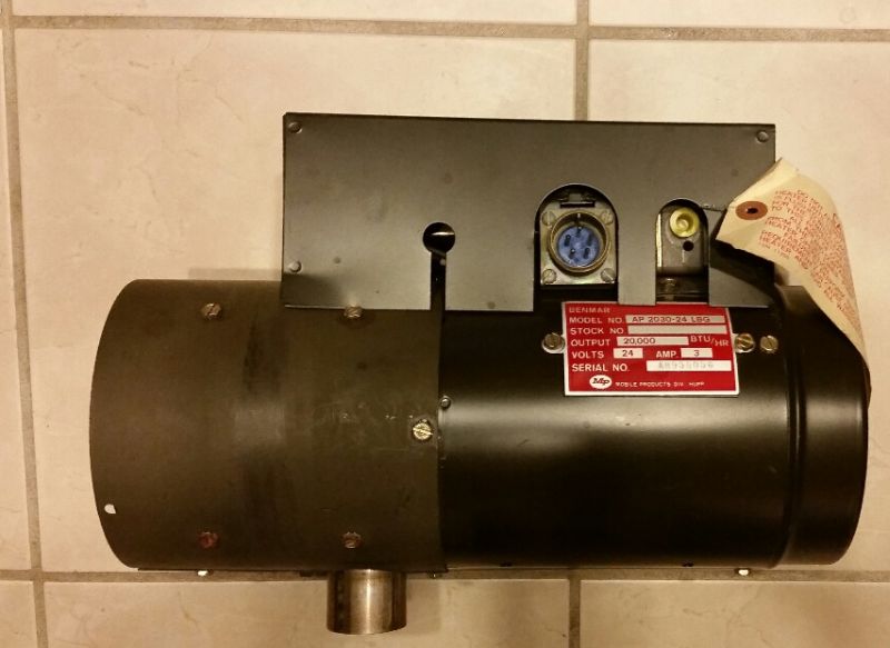

If it does not rain this weekend, I will see how the heater I have fits in the front trunk.
edit...Ouch....lowest price on on eBay is $450 with shipping for same exact model.
edit again (IMG:style_emoticons/default/smile.gif) I just placed an order on ebay for a a 12vdc to 24vdc power supply.

What kind of heater is that? I can't make out the brand. Please keep us posted on your progress. I've been thinking of adding a gas heater for the last couple years. It never occurred to me to locate it in the rear trunk or in the engine bay. The rear trunk is appealing to me. Is your heater gas or diesel? Are you going to use a separate fuel tank? Mostly what you see on Ebay are diesel heaters because all the semi-trucks use them for heat. The gas heaters are not nearly as common.

Benmar is the brand, gasoline for fuel. I think it is too big for the rear trunk , but I could be wrong. Will try and snap pictures of it sitting in both front and rear.
