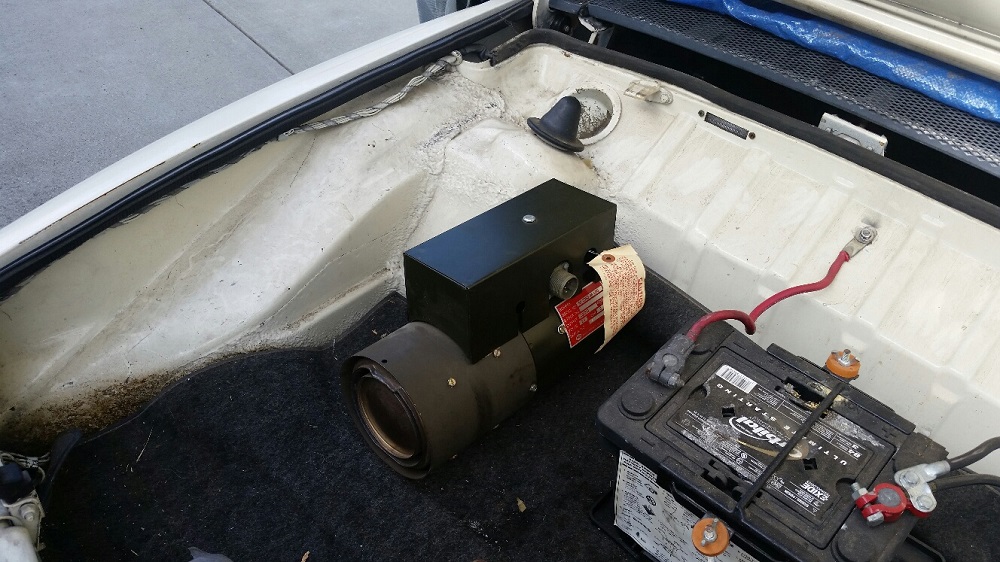

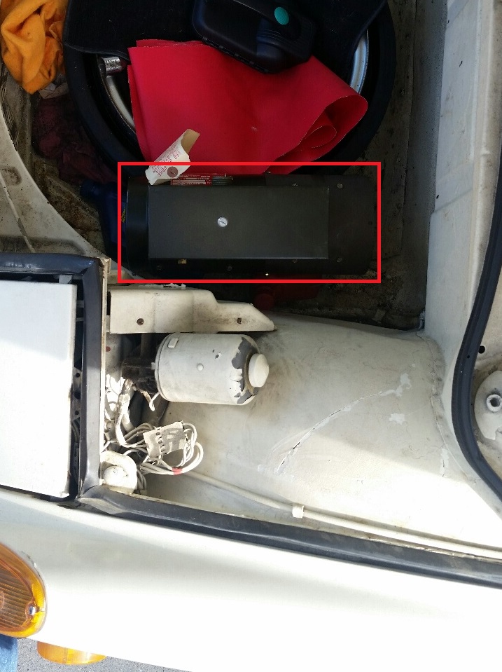

Pictures as promised....pic 1 and 2 inside front trunk.

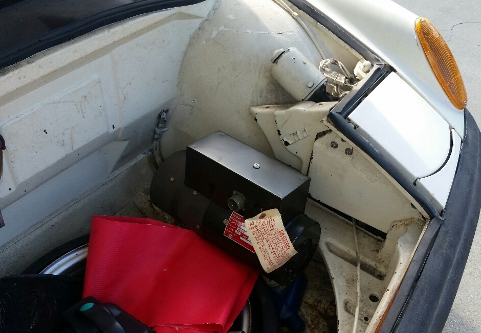

Last pic in the rear trunk, looks like it would fit with no real problems, I'd cut a hole in the trunk floor for the exhaust to gain another 2 inches of space. Rear lid would close like shown in the picture.
