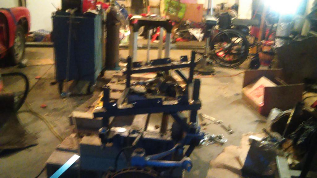

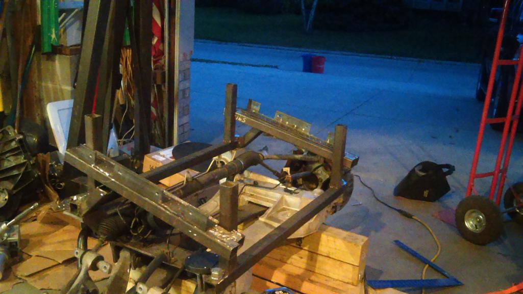

Well this is the second time doing the passenger and there will be a third things go crooked when they get hot. Progress has been slow but I am having progress. I did get 100ft of 1-1/2 DOM and my bender in. Learning a lot...like I need a chassis jig ...lol

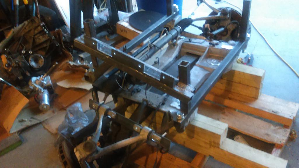

Stacks914   Only a few hours today got front a arm supports st...   Oct 11 2015, 08:06 PM
Mueller   Neat PS controller.... For the suspension, how do...   Oct 11 2015, 10:38 PM
Stacks914   Thank you the bottom of the ps column fits right o...   Oct 12 2015, 01:59 AM

Stacks914   Ok the front is almost done. Took A LONG time of ...   Oct 28 2015, 09:06 PM

Stacks914   Anyways this project is back on....currently. I r...   Sep 28 2016, 12:49 AM
Stacks914   You can see in the last picture I have bent the re...   Sep 28 2016, 12:54 AM
Stacks914   Here suspension is put this under the car to get a...   Sep 28 2016, 12:58 AM
Stacks914   I think I might be able to get away with 3 inch fl...   Sep 28 2016, 01:10 AM
