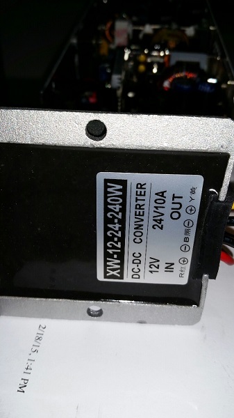

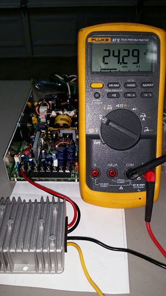

Need to find a low pressure fuel pump now....
Hooked it up to 12VDC and thru magic, 24VDC popped up on the other side of the wires!

Mueller   Need to find a low pressure fuel pump now.... Hook...   Oct 21 2015, 11:07 PM
