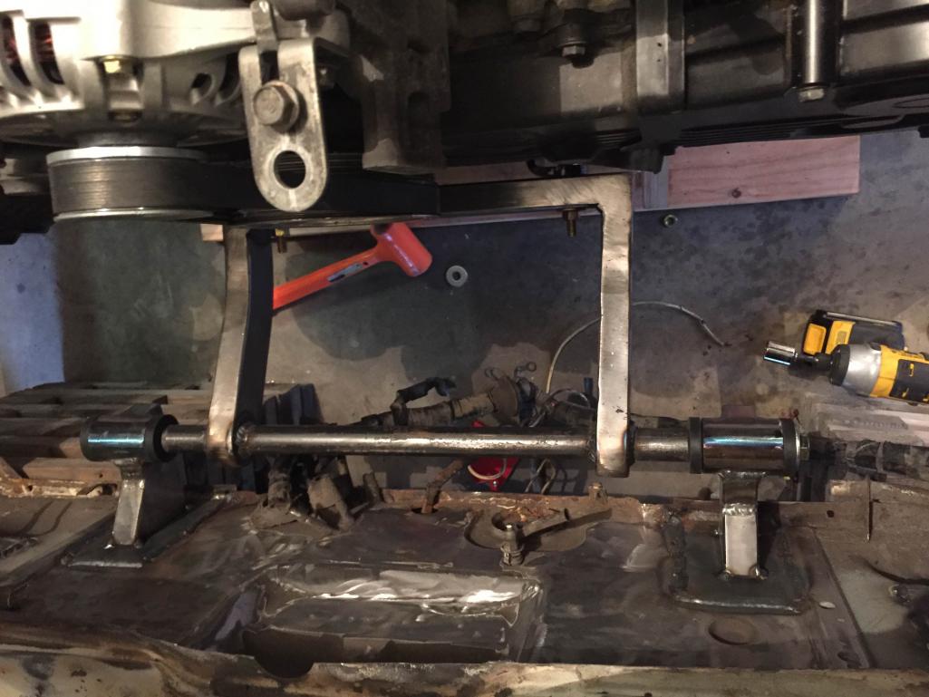

Finished the front bulkhead motor mount.

madmax914   Finished the front bulkhead motor mount.   Oct 25 2015, 07:19 PM

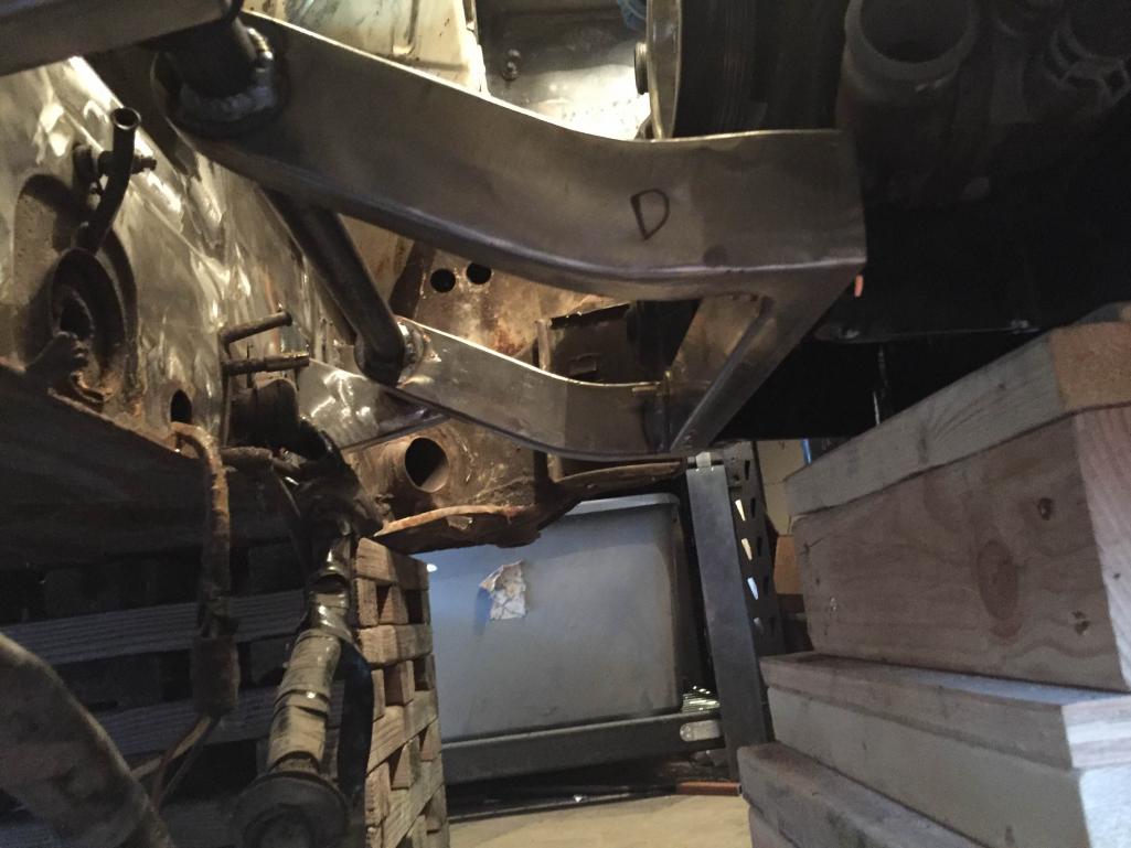

madmax914   If you look close you can see the Small Car motor ...   Oct 25 2015, 07:23 PM
madmax914   It's difficult to see but the oil pan is just ...   Oct 25 2015, 07:33 PM
Mueller   Nice looking mount!   Oct 25 2015, 07:51 PM
madmax914   Nice looking mount! Thank you, it is working...   Oct 25 2015, 08:35 PM
Andyrew   Good job on the mount!   Oct 25 2015, 09:54 PM
mgp4591   The mount looks pretty slick! What did OF char...   Oct 25 2015, 10:41 PM
madmax914   The mount looks pretty slick! What did OF cha...   Oct 25 2015, 10:54 PM
