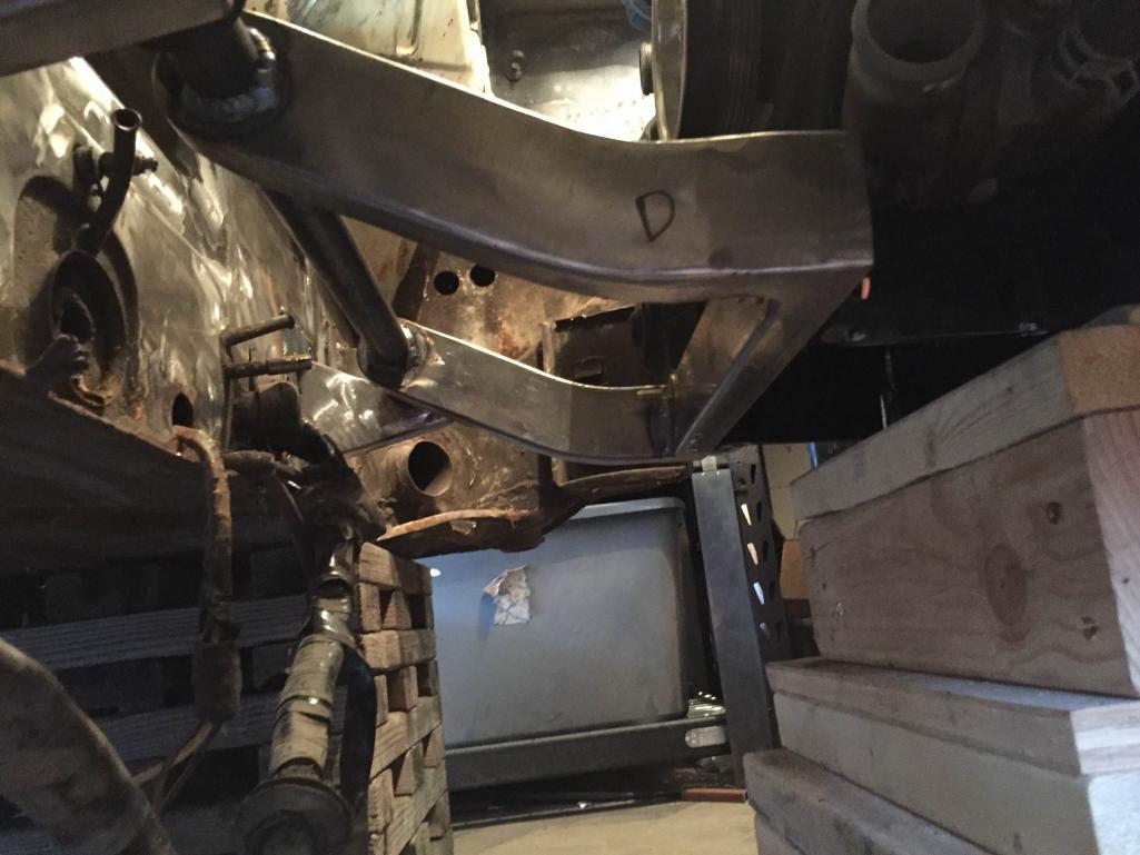

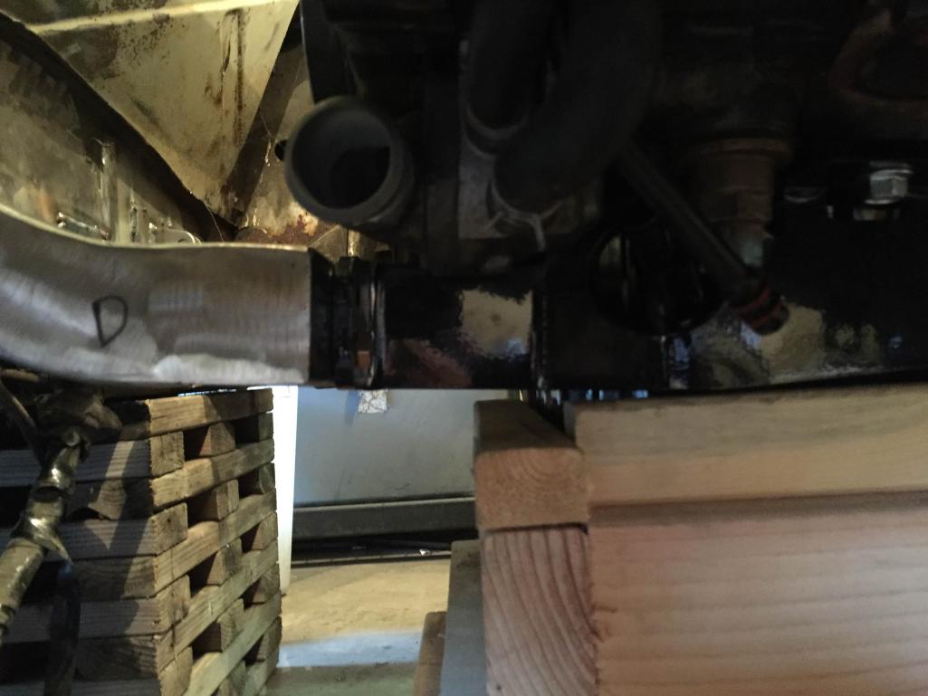

madmax914   Finished the front bulkhead motor mount.   Oct 25 2015, 07:19 PM
madmax914   If you look close you can see the Small Car motor ...   Oct 25 2015, 07:23 PM
madmax914   It's difficult to see but the oil pan is just ...   Oct 25 2015, 07:33 PM
