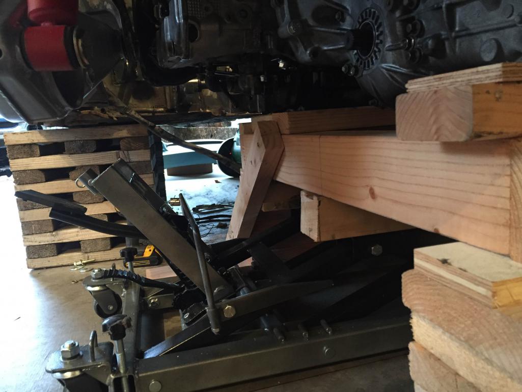

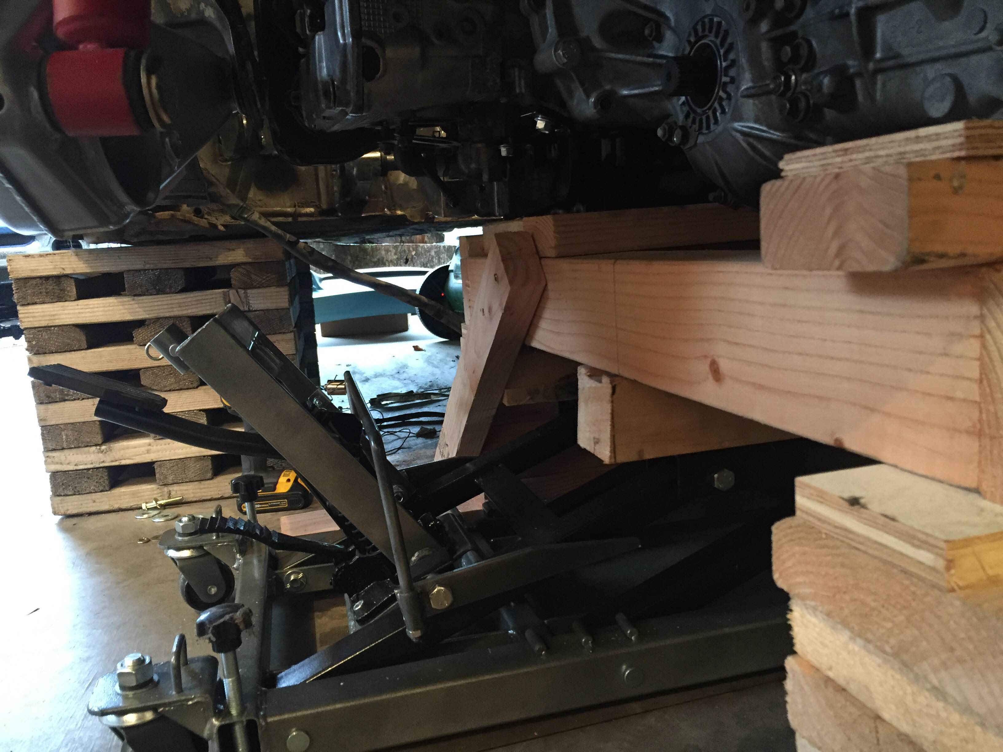

It's difficult to see but the oil pan is just about level with the bottom of the tub.

madmax914   I have the motor and transmission in place so I ca...   Oct 13 2015, 09:56 PM
porsaru   I have the motor and transmission in place so I c...   Nov 13 2015, 11:46 AM
madmax914   I have the motor and transmission in place so I ...   Nov 13 2015, 01:58 PM
