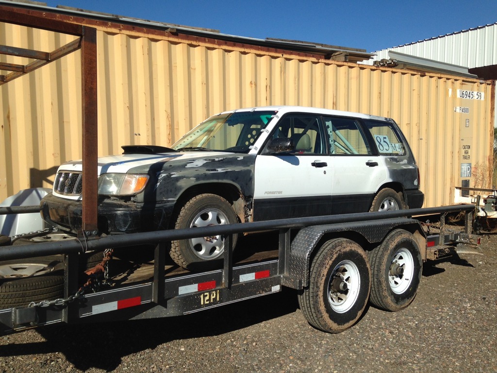

Getting ready for my winter project. (914) Been a little off track with old project's.
Just finishing up a Rally Forester that I used the Sti motor in. Now I will need to look for another motor ? Did a Rally-X in Tucson and had a blast. Using this motor in a 914 will be so very "COOL" ! Still needs paint but that will come.
