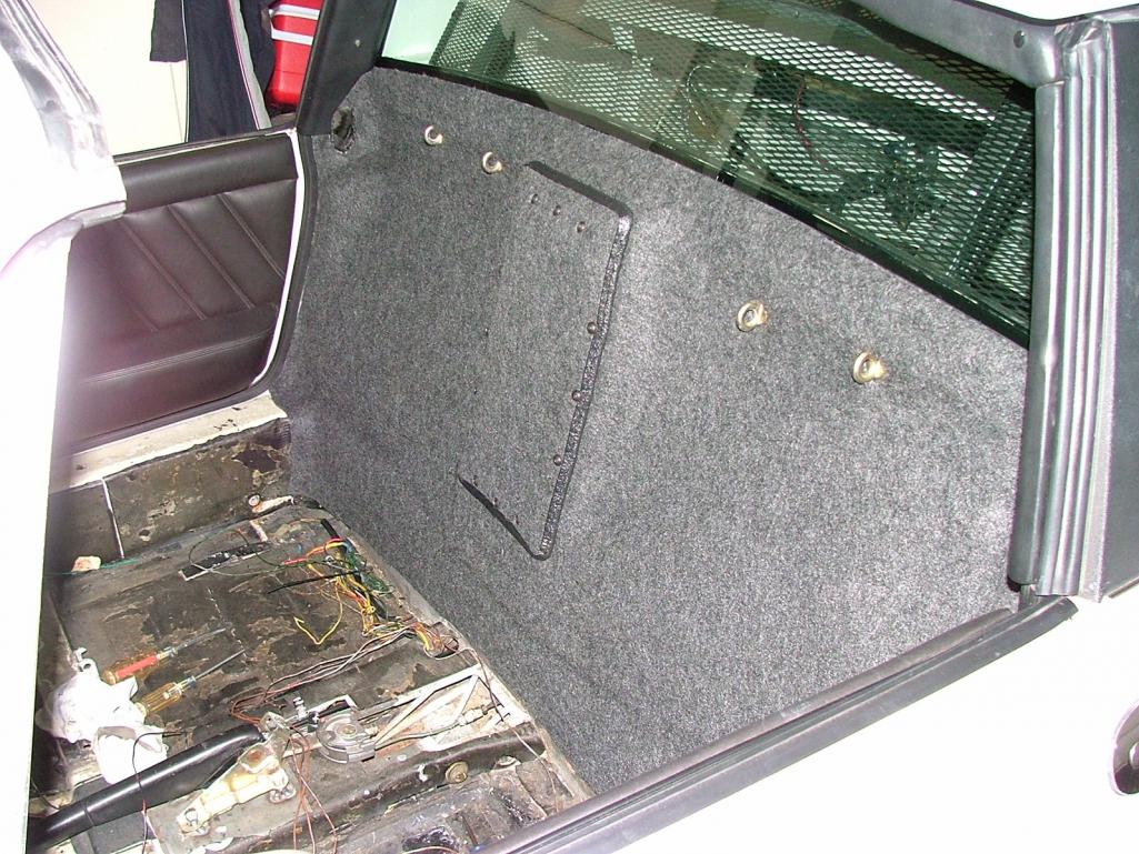

My last post was mid August so it has been very slow with mostly wiring. And lots of it.
But before I get to that, I did carpet the back interior wall and access cover.

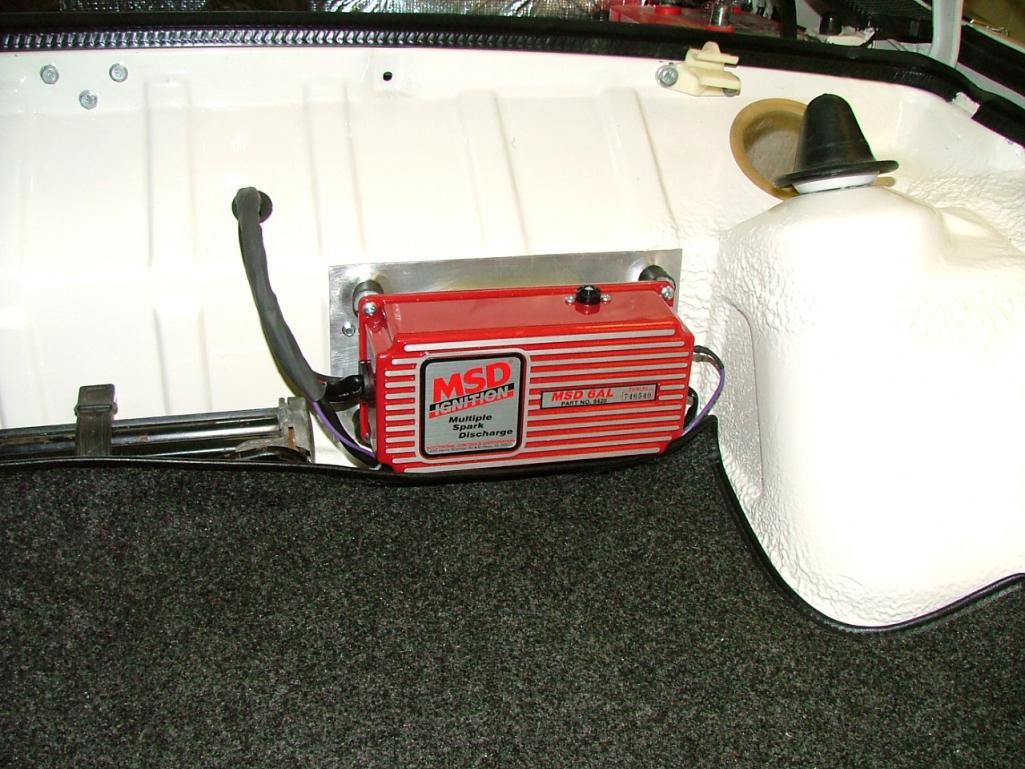

The first of the wiring challenge was locating and installing the MSD in the trunk. Wiring the MSD in, coupled with the engine conversion wiring Harness from Perry Kiehl, proved to be quite the challenge. For me anyway. Have to say that Perry Kiehl was extremely helpful in getting through it. Especially so, since I did not buy it from him directly, the PO did and Perry really came through to help out. I made a aluminum mounting plate as seen in the picture to adapt to the trunk forward wall.

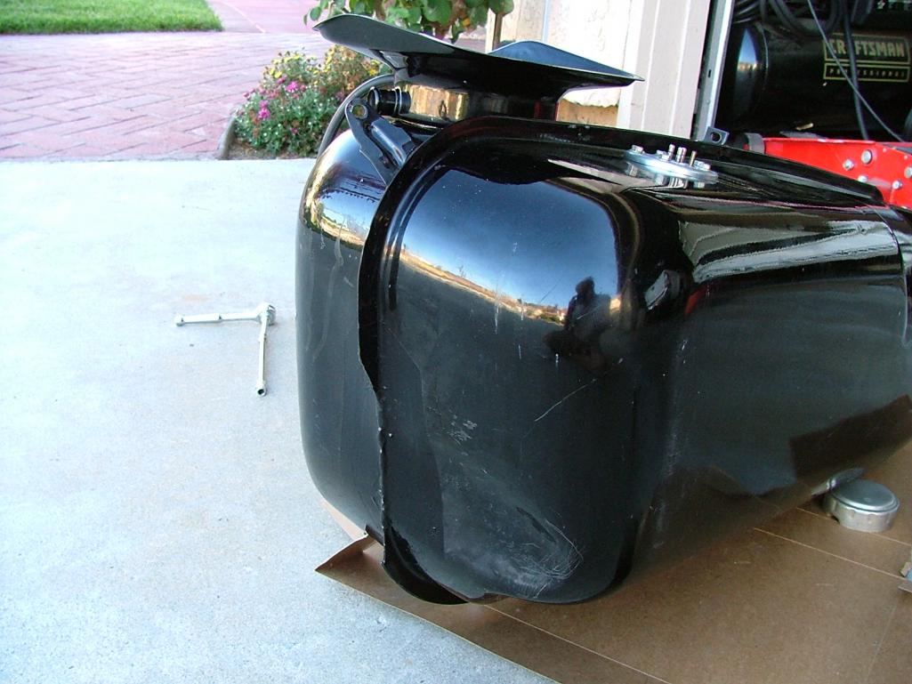

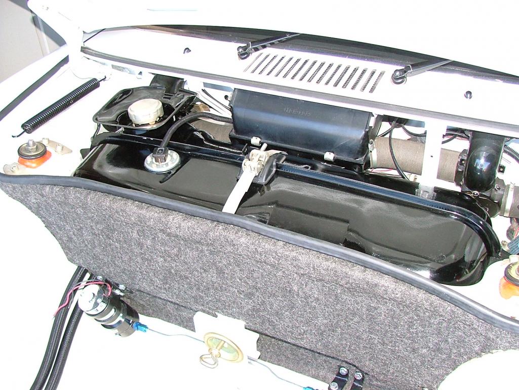

Had to modify the Gas tank to make room for the oil cooler lines heading to the longitudinal as mentioned earlier. Local radiator shop did excellent work and resealed the tank as well. Thought it was going to take more modification than it did mostly cutting the flange off and a small indentation provided enough room.
Also carpeted the wall in the front trunk.
