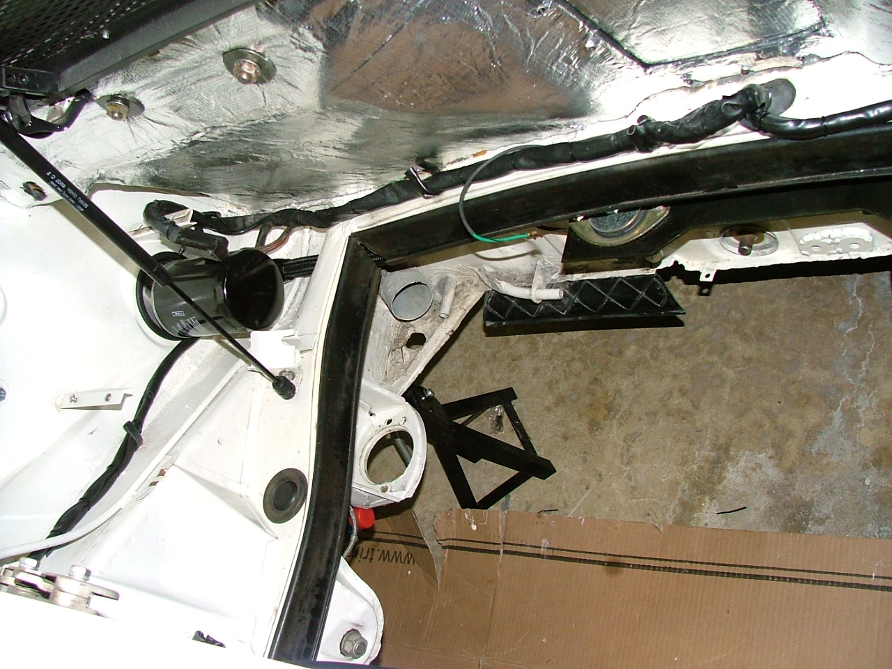

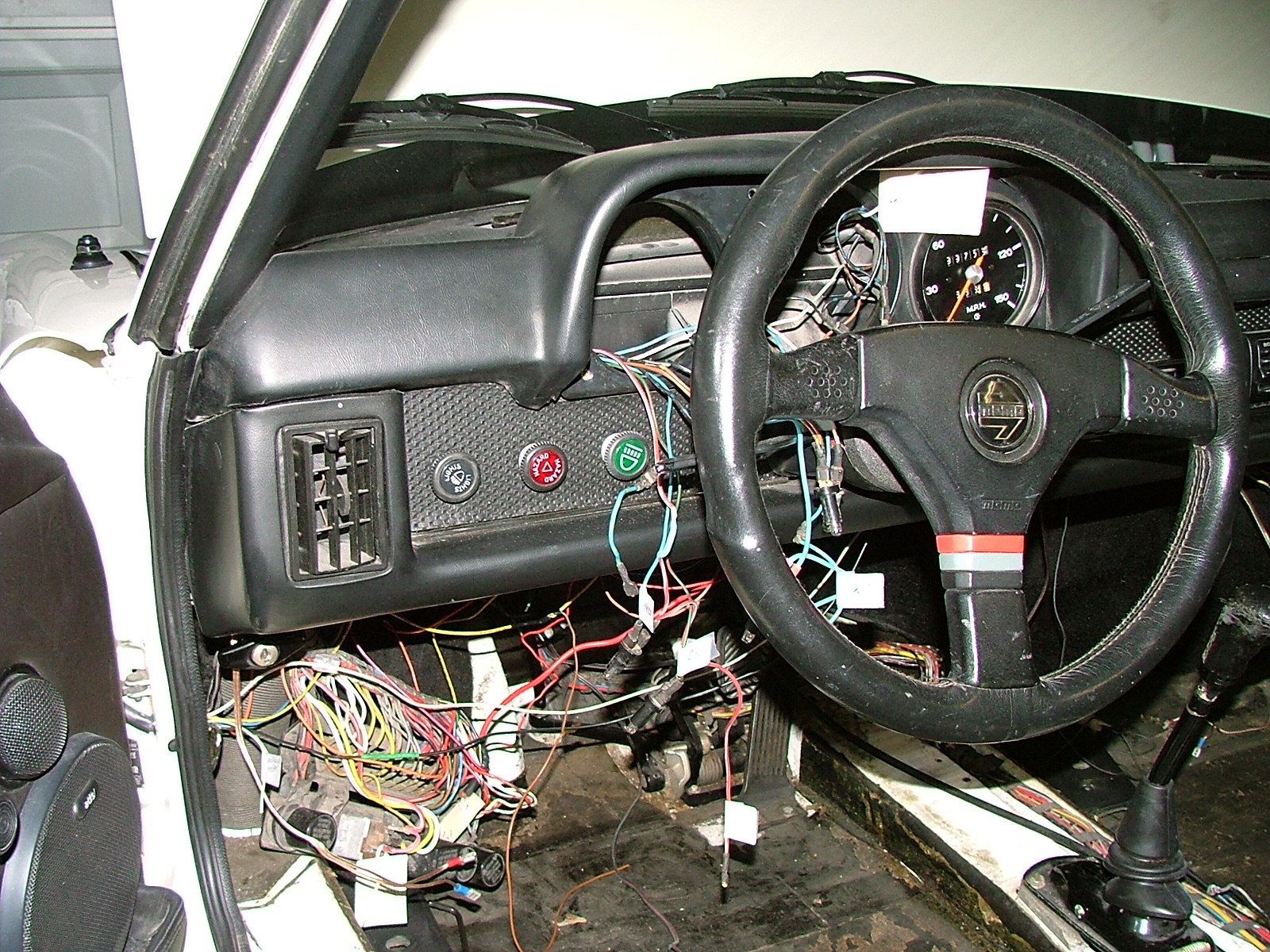

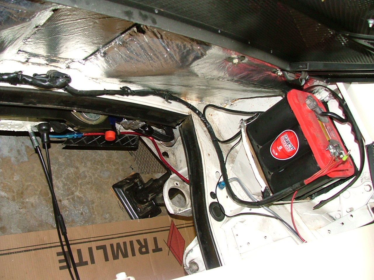

The engine compartment is all wired now and very cleaned up looking. I like how it came out. Hid the wires to the original fuel pump and also hid the wires to the blower, ran the new wire for the oil temp in eng compartment too. Still want to keep my options open as far as putting the engine in, so holding off for now. Looking to still add a starter relay.

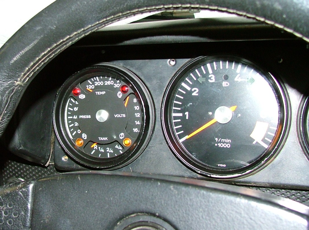

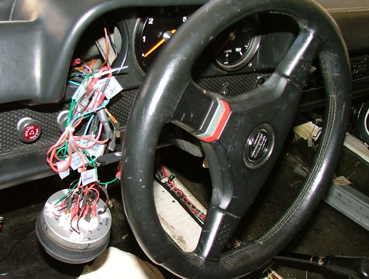

Quad gage wiring completed recently. What a challenge that was! It is actually a quad gage with 4 warning lights, pretty slick. 4 days invested here on this alone. Lots of calls to New Vintage Gage in Detroit. Ben was very helpful. Again, the gage was not purchased by me directly, it was puchased by the PO. So Ben went above and beyond to help sort out a gage they sold about 4 years ago. Pretty cool. Had to run several new wires replacing wires and additional wires. Also thanks to Matt at CPR and Dave Walker toolguy.
