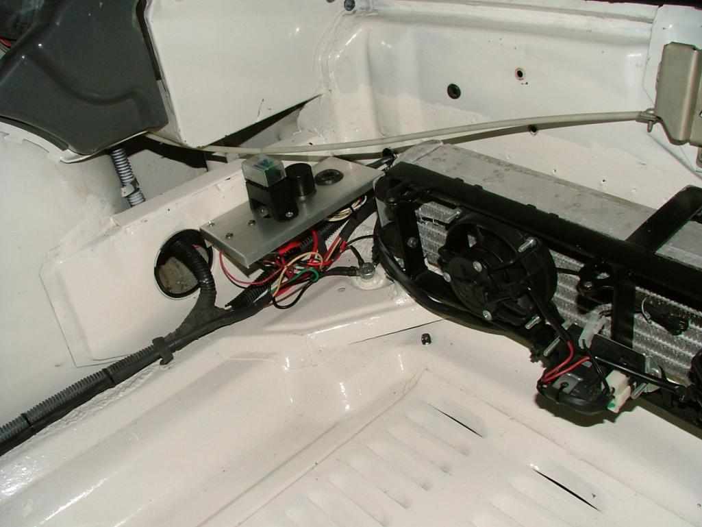

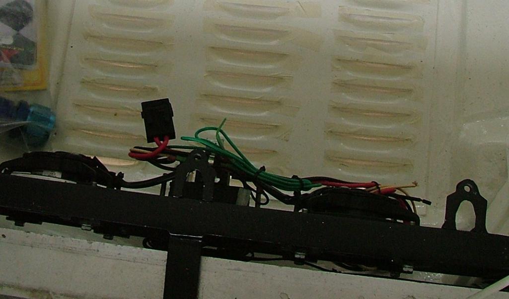

Put power to the chassis recently for the first time since I have owned the car! This car has not seen power in 18 years!!! Matt at CPR suggested a good systematic approach to applying power for the first time. No fuses blew, no melted wires and a lot worked, some not so much. Had some burned out bulbs, bad ground, and normal stuff. The reason I had not put power to the chassis is there were a bunch of extraneous wires to figure out, sort out, and rip out. Plus there were a couple of previously burned/ blistered wires to replace. (picture) Thanks dlewis for the box of 914 wires to use. Also read here on world from a guy who burned his harness not once but twice, freaked me out. It is nice to see head lights, running lights, gage lights, flashers, horn, wipers, fog lights, and turn signals. Still bugs to work out like parking brake light, and interior light. I even got the radio and power antenna working!
This car originally being a 4 cyl had the single bulb blinker in the tach. With the 6 cyl tach it actually has a left and right. I needed to run wires from the flasher area the grn/blk right turn and grey/ blk left turn. Now the white/blue original wire for single turn signal is now not used!?? oh well. I have correct turn signals now on the 6 cyl tach!!! Blink normal and everything!!! There is hope for me yet. (Disclaimer: It didn’t work first time). Wiring diagrams from Dave Walker toolguy sure helped.

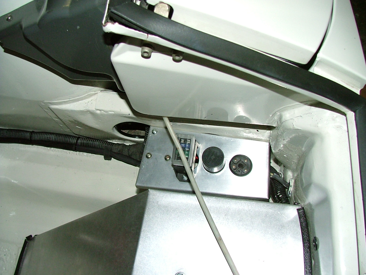

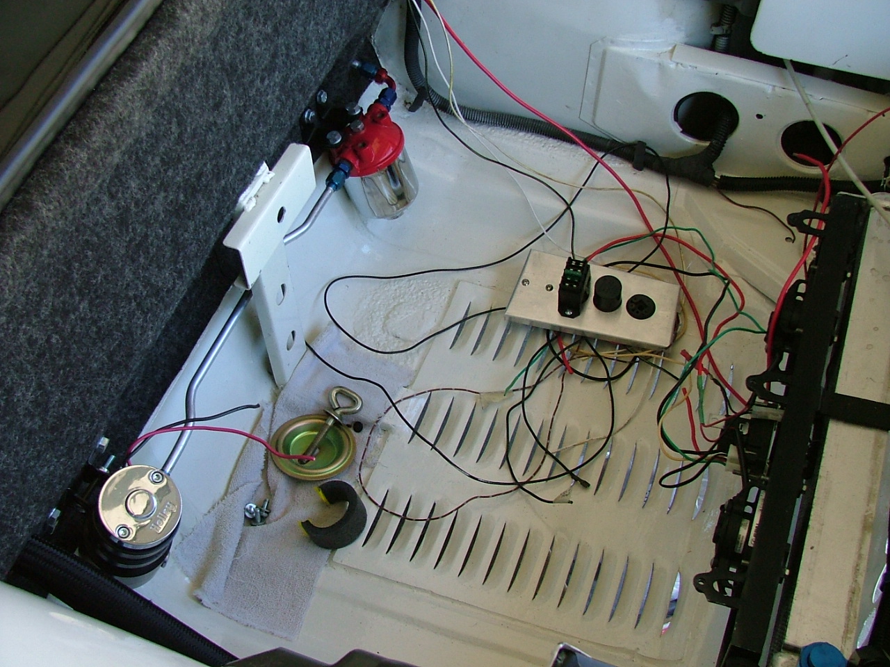

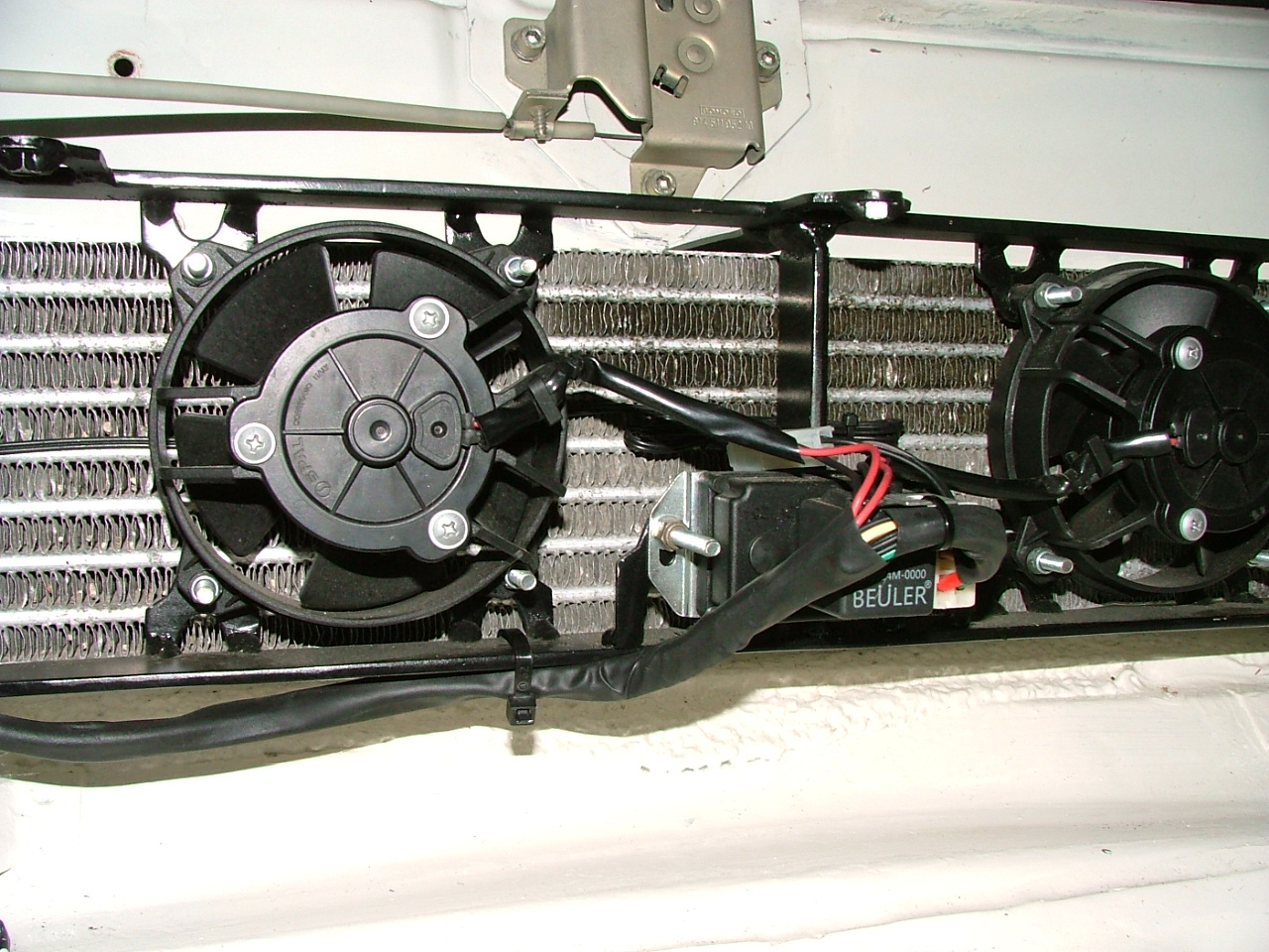

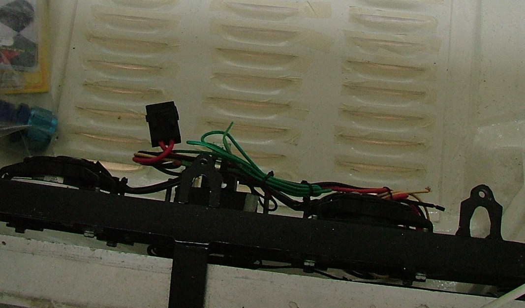

Next focus was wiring on the oil cooler fans and fuel pump. I finally get it! Thanks to Dave Walker toolguy I finally do get it how the wiring is suppose to work with a relay. So re-did the wiring to the fans because I thought it could look way better (before and after pictures) Want to use the small 4 fuse block and took the in line fuse previously installed for the fans and moved it to a small fuse / relay panel. It will be so much easier to see on that little fuse block than bundled up in a wiring harness under the oil cooler shroud.
Used Porsche relays on the panel since I had the bases (thanks dlewis) and relays so made a fuse box/ relay tray out of aluminum, toolguy helped me out with his slick machine shop in punching and bending the alum panel. The 4 fuse panel has a fuse for the fans and fuse for the fuel pump with 2 empty fuse positions for anything future. Note that the fan had its own relay so that is still located on the fan frame. Also I left myself a spare relay base on the panel to potentially run a relay for the headlights or anything else.

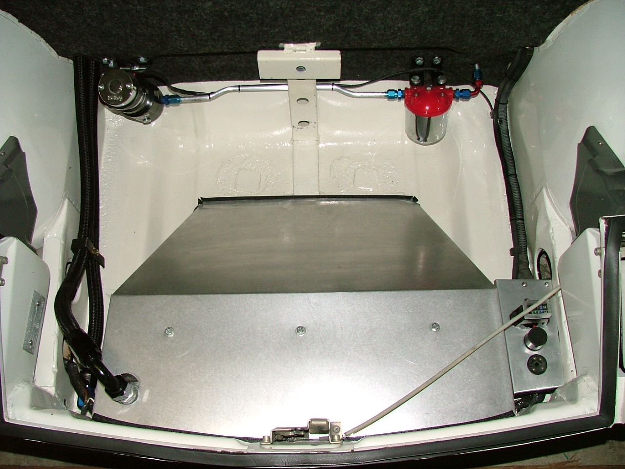

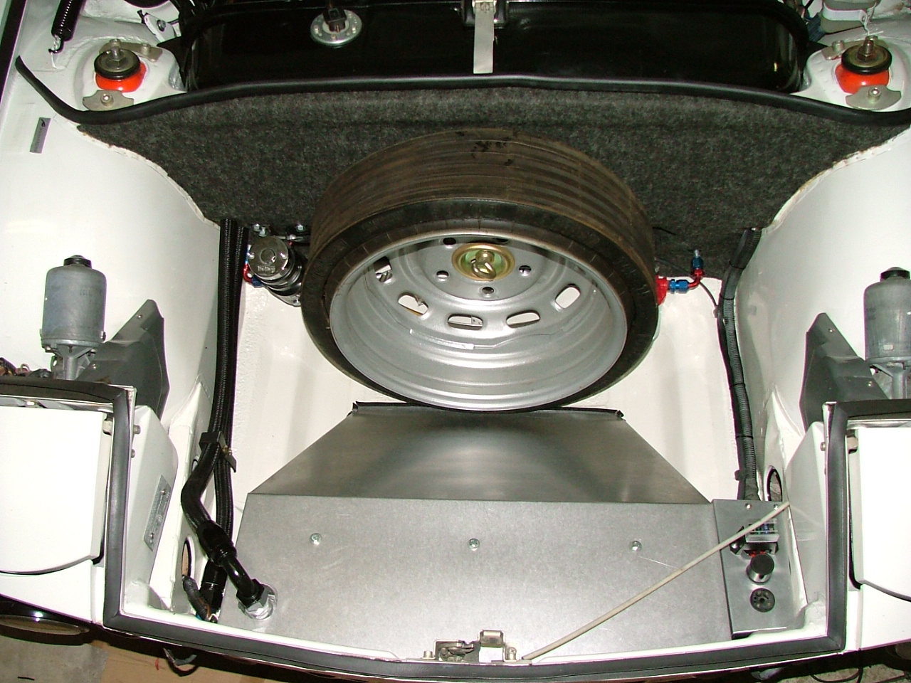

Lucky9146   Pictures of front trunk as received. Louver was i...   Aug 6 2015, 05:13 PM
Lucky9146   Minimal rust was treated with Pour 15, louver was ...   Aug 6 2015, 05:19 PM
lonewolfe   I like how the spare tire mount was added for a sp...   Aug 6 2015, 05:22 PM
Lucky9146   I like how the spare tire mount was added for a s...   Aug 6 2015, 05:53 PM

Lucky9146   To continue on with the front trunk, oil cooler, a...   Aug 8 2015, 12:29 AM
Lucky9146   The PO installed oil cooler and card board mock up...   Aug 8 2015, 12:41 AM
Lucky9146   So I started with the mock up and some spare galva...   Aug 8 2015, 01:09 AM

Lucky9146   The real elephant in the room for me is the wiring...   Aug 9 2015, 11:49 AM
porschetub   The real elephant in the room for me is the wirin...   Aug 9 2015, 12:46 PM
Lucky9146   I can't help but laugh @ your comments ,I...   Aug 9 2015, 01:13 PM
