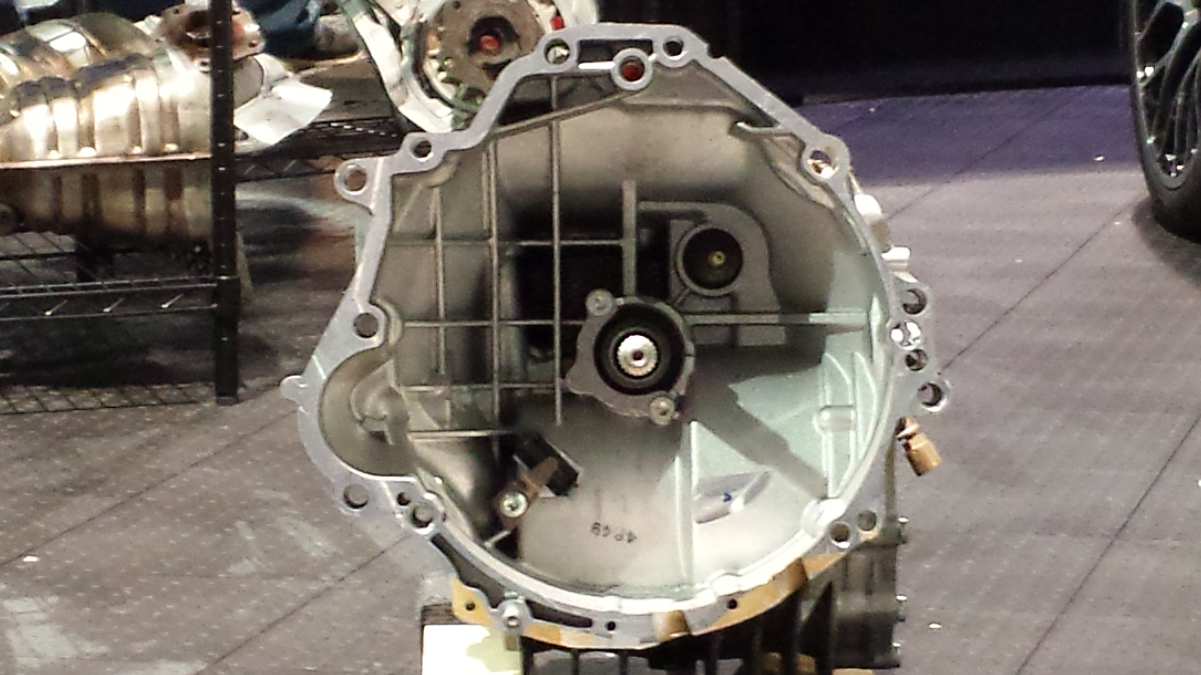

LA Dismantling had a booth at SEMA. Technically a new 911 but I think it's the same holes.
