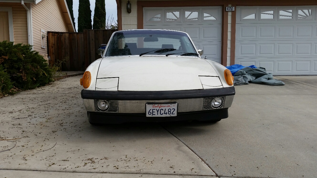

The car:
1973 which originally had a 1.7 in it. The PO installed a 2.0 bus motor with megaquirt on it and drove it for a few years and parked it about 4 years ago due to no more compression in cylinder #3.

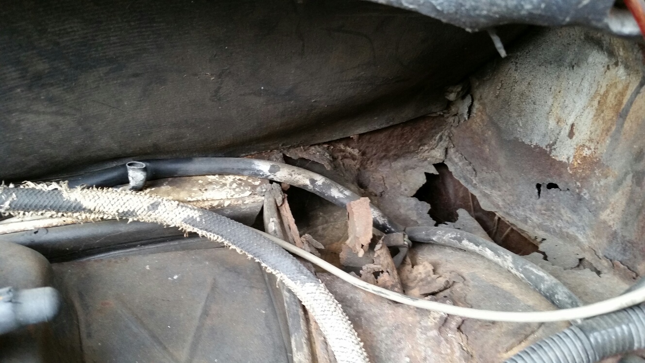

I knew the car had some engine compartment rust in the hell hole, but it is worse that I thought it had, but I still think I got an okay deal on the car considering I was able to make payments and I knew the history of the car before I even considered buying it.
5x130mm redrilled /4 hubs with extra long studs up front with slide on spacer and bolt on 5x130 to 5x130 bolt on spacer in the back, not keen on either end.

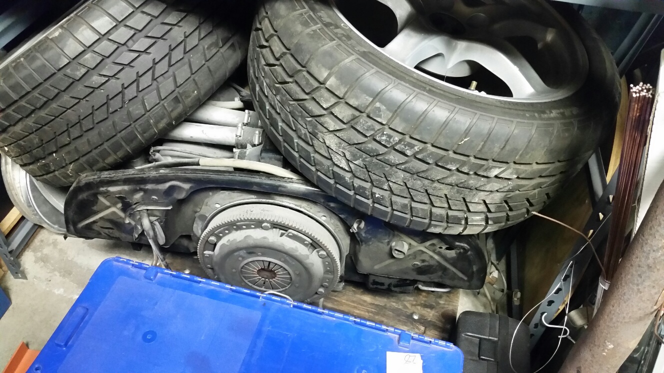

Install 1.8 motor I picked up from McMark after I fix a few broken exhaust studs (not Marks fault)

Below are pictures as the car sits across the street. Why across the street and not at my house? Well, I made a deal with the wife that my on going 6 year project car will be driving before I bring the 914 home, that will happen once I install the entire front suspension, install a wiring harness and finish building the engine and install that also.
So possibly before the end of the year the 914 will be home!

Oh yea, my 1.8 motor underneath the wheels and tires that belong on the Volvo 242 I should be working on!

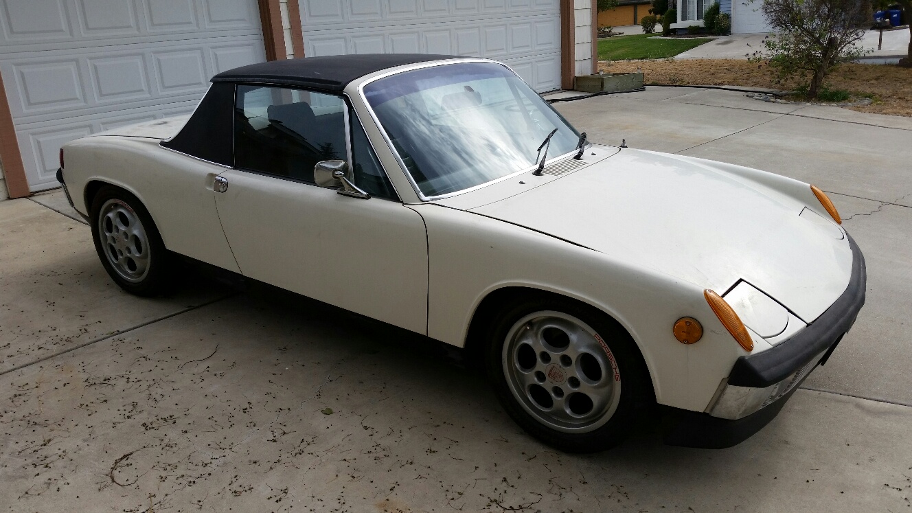

You know Mike, that's a lot of 914 for 2 bills, should clean up nice. Get that 1.8L in there running on the MS after the peripheral repairs.
Thought about losing the JC Whitney mirrors?
Mueller
To be honest with you, I couldn't have told you if those are stock or aftermarket mirrors...been out of touch for so long wink.gif

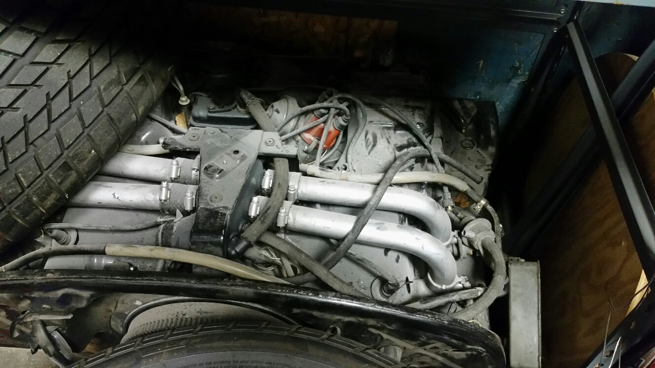

So Mike was the motor built by McMark? What internals are lurking in there? Looks like an awesome build, can't wait to watch the progress!
Mueller
QUOTE(madmax914 @ Oct 2 2015, 11:27 AM) *
Nope, supposedly built by HPH, no idea what was done to it. I was told the PO kept chasing fuel injection problems and out of desperation bought a complete running 2.0 to throw in there.
The motor looks great, all powder coated parts, the screws that hold the sheet metal on look brand spanking new. I'll pop off the heads to get the broken studs fixed and do a quick inspection.

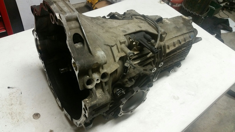

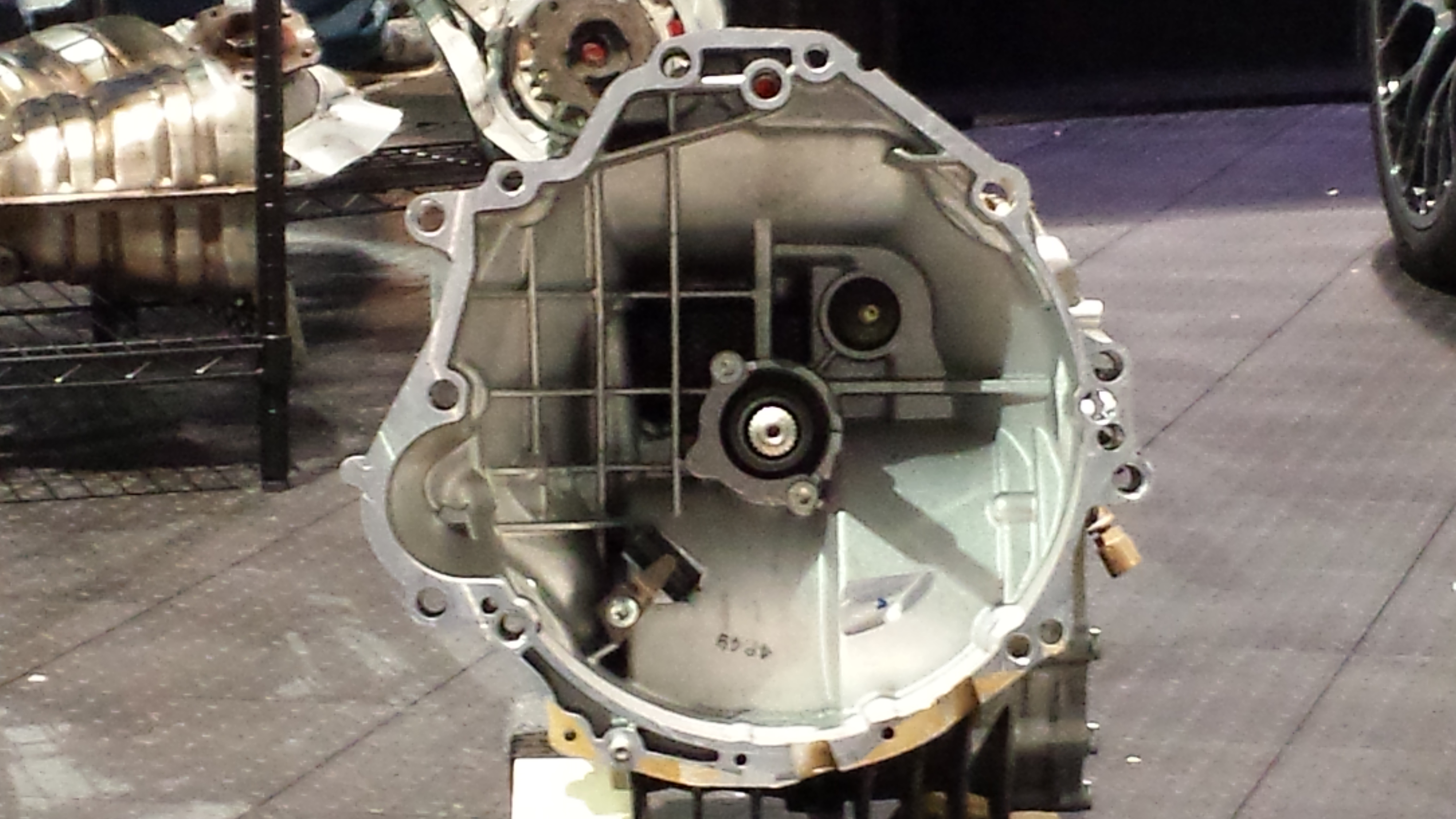

Picked this up tonight...$200 for low mileage '03 Passat gear box....more or less the same transmission as used in the base Boxsters, just at 1/3 the price smile.gif
Chris H.
Dang that's almost junkyard cheap. You gonna look for an engine to bolt that to or use your Type 4? KEP will make any adapter but it will cost some dough. 2.8 is a nice engine if you like v6's. Almost went that way myself.

I might go that route, I have an extra 13c from my Volvo build that wouldn't be too bad on this 1.7...might be better choices but this one is paid for smile.gif

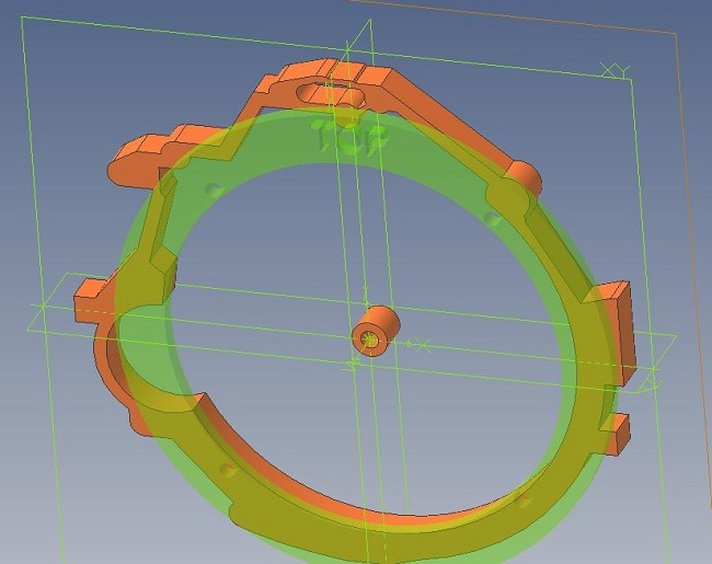

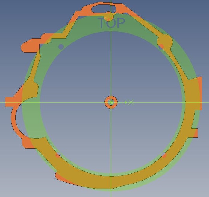

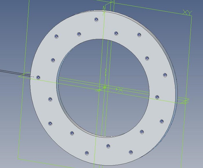

Playing on the computer tonight, overlay aircooled (green) on the Audi gearbox bell housing.
Need a 914 transmission so I can see where the starter mounts and see where to move it or clock it relative to the input shaft.

Did you get that cad drawing from somewhere or did you make it somehow?
Mueller
I found a drawing online that has the bolt hole locations and I imported it in and manually traced the outline. I will add the holes later on.
That was drawn using Geomagic, it used to be called Alibre...a poor man's version of Solidworks.

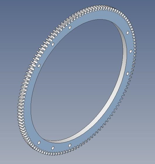

Mueller
Ordered a 964/993 starter gear and friction surface for the aluminum flywheel I'll be making to adapt my motor to the Boxster transmission.
I should be getting the pressure plate and clutch next week and will model those up as well.
I just made these based on some dimensions I found online and will correct them once I get the parts in hand. I know the teeth are off for sure. Still researching starters.....

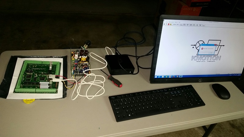

First I need to install the new motion contoller on the BP mill....need to learn some C++ 1st for the interface...
My old tower PC with Win98 finally bit the dust (I could replace the capacitors on the motorboard)
So I bought this $150 Dell mini-PC you see in the middle running Win8.1 and boards on the left is an 8 axis motion controller (only using 4 axis right now, XYZ and rotary table)

Nice! What CNC mill do you have? Can you mill steel or only aluminum?

Early 1970's Bridgeport knee mill, currently steppers (open loop) , soon to be servo driven (closed loop)
I can mill steel, it just takes longer due to having to go slower with the feds and speeds.
trojanhorsepower
I like the little computer, where did you get it? What kind of A V IO's dose it have?
Mueller
Best Buy, I'd bet you can find them cheaper on Amazon but it was one of those I gotta have it now moments..hahaha
HDMI and DisplayPort for video output.
Came with wireless mouse and keyboard and Wifi (will be going with cable keyboard and mouse when I have it connected to my mill, a little safer that way)
trojanhorsepower
Cool. Does it have mic and headphone/speaker ports?
Mueller
QUOTE(trojanhorsepower @ Oct 25 2015, 05:34 PM) *
Headphone/speaker port only.

Chris914n6
LA Dismantling had a booth at SEMA. Technically a new 911 but I think it's the same holes.
