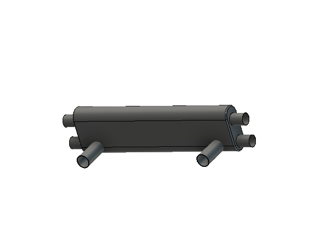

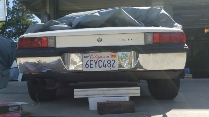

Test fitting muffler ...... Flowmaster 80 dual in, dual outlet. Want to make a poormans GT muffler. $50 brand new on Amazon for the muffler.
I found a company in Germany making these for 911's (cannot find the darn link now)
Plan is to cap the lower outlets on the side.

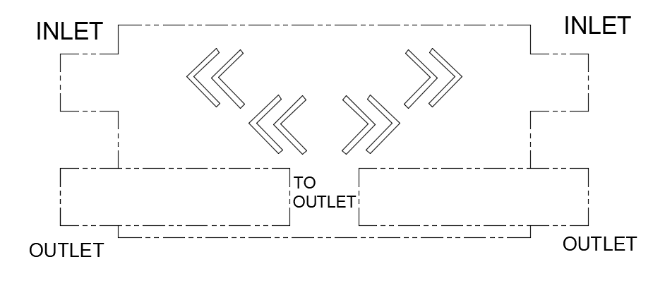

So that muffler has an "X" pipe inside, like this one?
I'm looking for something like this pic, a true cross over that I can use to have an inlet and and outlet each end - but I'm limited to about 5" height/thickness.
This schematic is for a 370Z muffler but it's 6"...

No, not a crossflow
Roughly like the pic below. Harry with the 3.5 Honda/Acura V6 powered 914 has this muffler however his only has one outlet. He didn't know of the 2 outlet option when building his car. Sounds great with his motor.

Sounds like you want the Magnaflow I've been eyeballing for my 3.5L upgrade.

Why not just build one yourself?
I believe your looking for a Camaro style muffler. I believe magnaflow and flowmaster make one similar. Various sizes.

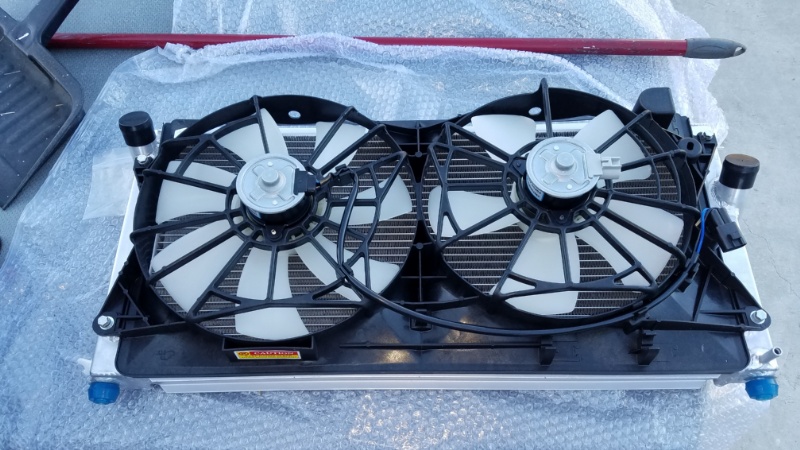

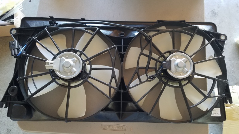

Going with Celica GT based radiator and fan setup.
Radiator should be here this week and then I'll start cutting holes and picking up the aluminum sheet for the shrouding.
Now to see if I can unload the 1.8 I was building, lots of nice parts for it.
Anyone know off hand which is the primary and secondary fan?

Yes, 901 which I have 2 to choose from
It uses a factory Honda ECU with a modified Honda harness so only 8 wires needed to hook up to the engine or something crazy like that. No need to tune or dyno which is nice.

What water pump does it use? What ECU does it use?
My Davies Craig water pump and controller is awesome... Highly recommended and let's you pick the maintained temp....
The fan wiring should be really simple. Just link them together and go. Run a big enough wire to the relay and to the fans themselves to deal with the load and you won't have anything to worry about.

Factory water pump is all that Harry ran and he was told it was good enough for the sand rail guys.
Factory ECU, uses a MAP sensor in the manifold. Should be very reliable and depending on serial number of unit, can be data logged and tweaked with a Hondata $300 program/hardware.
For the fans I have an older SPAL pwm controller that I got dirt cheap due to a bad assembly procedure at the factory. They soldered a few capacitors too far off the board and the leads would break due to vibration. Easy fix.
or just going old school with a temp sensor and simple relays.

Pretty sure I figured out 1 is drivers side, 2 pass.
I ran an 8 gauge from the battery to the frunk --> fuse distribution block --> relays to fans and headlights with a couple extra for amps.
Also ran the fan trigger wires past idiot lights in the gauges just to be in the know.

I am using one of these cheap controllers for the intercooler fan. Seems to be working fine and I dont see why it cant work for something bigger like a radiator with an appropriate relay setup.
https://www.amazon.com/outstanding-Temperat...+controller+12vIf I were to do it again I think maybe I would go with this one, as I cant find the one that had my nice black lexan overlay with buttons.
https://www.amazon.com/dp/B008KVGWT4/ref=ss...customerReviewsMy radiator fan controller, electric pump and electric pump controller were all Davies Craig which was completely awesome.

Sand rail guys aren't pushing water 16' in a loop. Their rads are mounted closer to the engine. My Audi pump was not up to the task. I don't have a fancy controller for my pump like Andyrew but I don't need it. Both of our cars run cool.
My fan controller is just a dual relay with a thermistor on the radiator. On temp is adjustible on a mini potentiometer for each relay. Simple and effective.
I hit up a junk yard for the Toyota plugs for the fan harness.

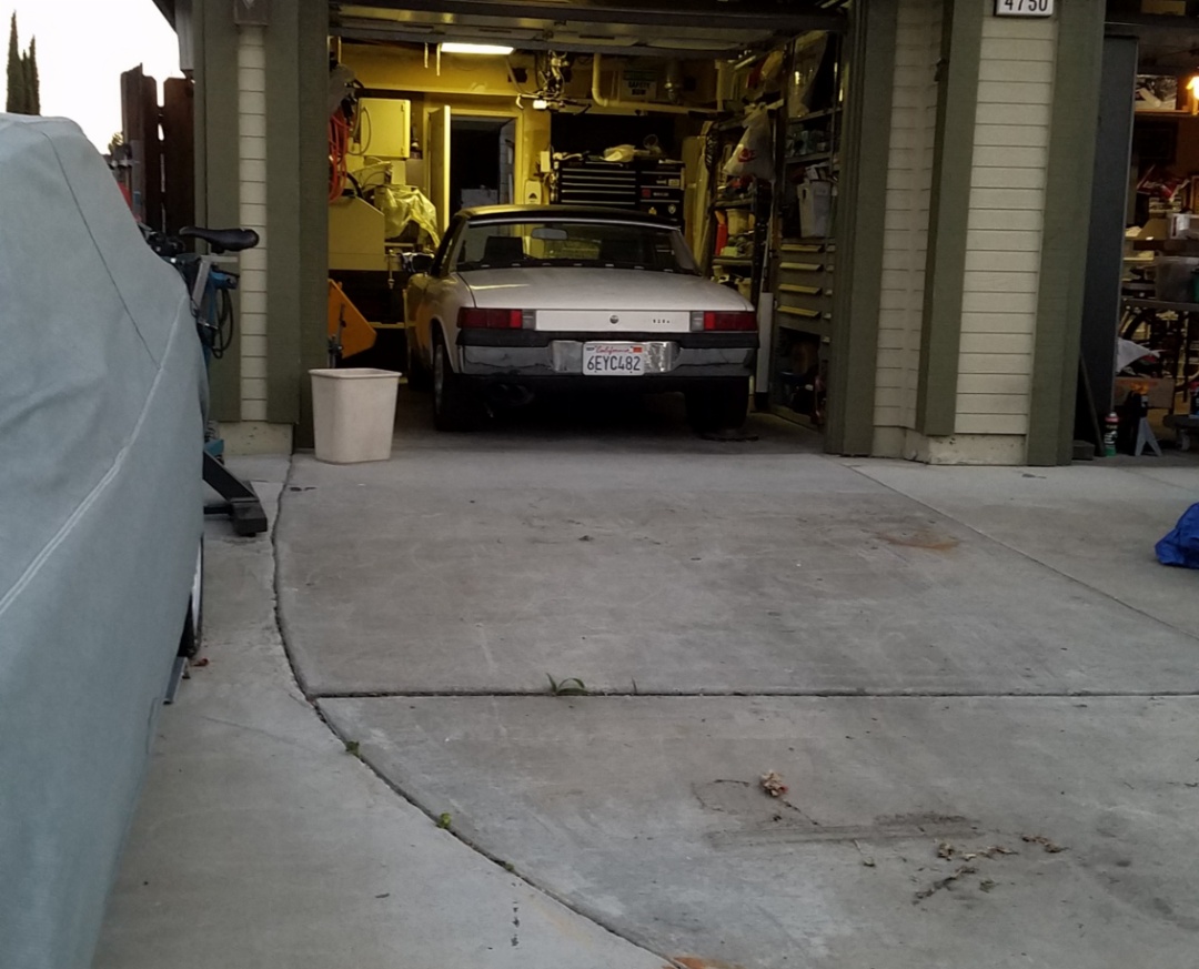

Jul 12 2018, 12:15 AM

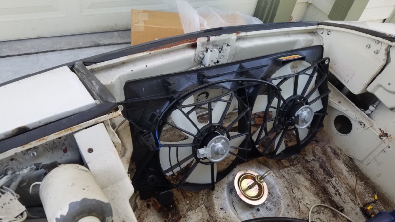

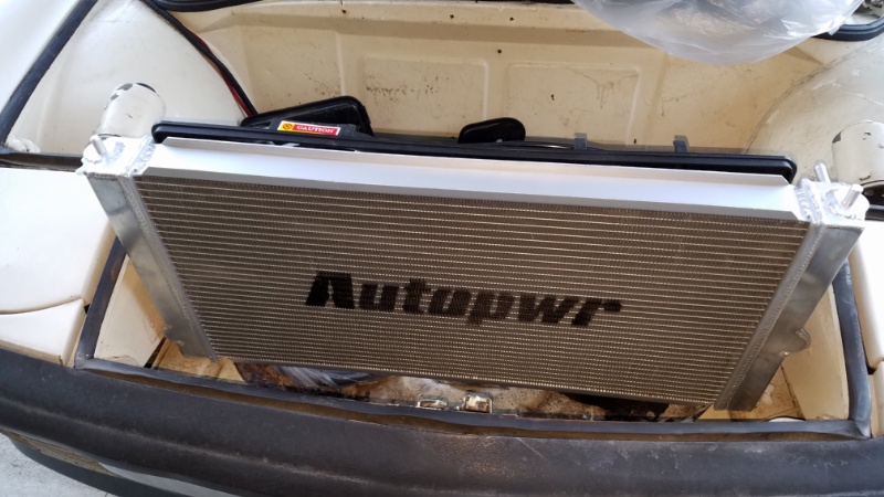

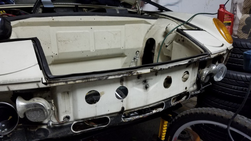

Radiator came in today.

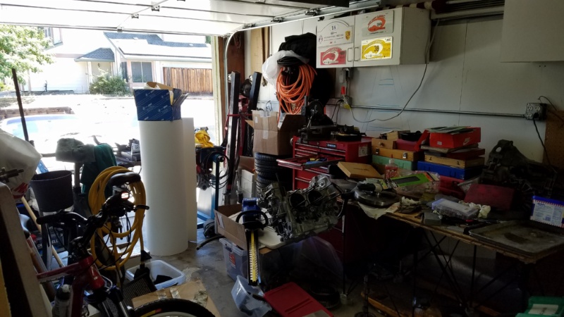

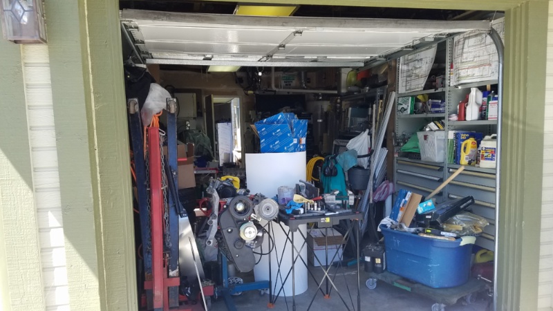

More importantly is that I got the 914 moved into the garage. Took all day to move and organize all that crap.
Removed axles and shifter tonight, hope to drop motor/transmission in the morning.
A few before pics of garage.
Click to view attachmentClick to view attachmentClick to view attachmentClick to view attachmentClick to view attachmentClick to view attachment
maf914
Jul 12 2018, 06:28 AM
Impressive looking radiator and fan set-up. Looks like you will need plenty of exhaust air outlet area from the front trunk.
My Nissan pumped just fine. Ran the fans off the ECU and it kept itself cool. The hoses will cool 5-10F just being in the airflow under the car, so adjust the controller accordingly.
The fan terminals are a common size, I just bought crimp connectors for mine.

Jul 12 2018, 04:37 PM
QUOTE(maf914 @ Jul 12 2018, 04:28 AM)
Impressive moving stuff to make it work. That is back breaking challenging stuff, cause everything needs to find a home. Well done!

QUOTE(Mueller @ Jul 12 2018, 01:15 AM)
Reminds me of our garage. 10lbs of
in a 5lb bag.

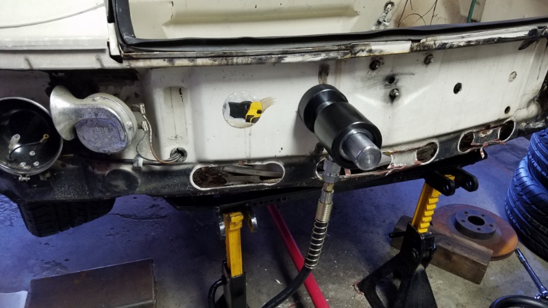

Jul 18 2018, 10:58 PM
Cut out the inlet and outlet holes for the cooling system.
Need to trim the valance, not sure if I need to cut the bumper or not. A few Subaru guys have not needed to cut the bumper so I might get lucky.
Chris914n6
Jul 19 2018, 01:08 AM
You have seen mine right? Air enters thru the fog grills and gets directed towards the center. I had to rivet a piece of plastic to the bumper bracket to block flow the wrong way. I also didn't cut between the holes. Cooling air volume in the sweet spot. You should be fine with what you have so far.
edit: added pics. No fogs obviously and 75 so horns under chassis.
Jul 19 2018, 07:26 AM
Looking good, Mike!
Don't you just love the knock out punches? I've been wondering if I could get away without notching the bumper on my car so I'll be interested to see how your plan works out.
Take care and keep up the great work.
Chris H.
Jul 19 2018, 07:43 AM
Great start. It's easy to cut more if you need to but that should be fine.
What's with those horns man
Jul 19 2018, 08:17 AM
Mike - I forgot to ask: What size holes are those? I have some dimple dies that you're welcome to borrow, if I have the right size.
That press is looks to be the same one I have and it should work fine, again, assuming I have the right size die.
Let me know...
Chris
Jul 19 2018, 08:42 AM
You'll rely on your fan more than you would otherwise but I think that it'll still be fine
that Honda motor runs pretty cool being all aluminum. If you shroud your exit you'll have much better flow, and ducting or shrouding your entering air would increase your flow as well.

Jul 19 2018, 12:06 PM
QUOTE(tygaboy @ Jul 19 2018, 10:17 AM)
Let me know...
Chris
The harbor freight punch set is for pipe sizes and most dimple die sets are for tubing sizes and won’t work.
Jul 19 2018, 12:35 PM
That being said
these will work with the punches and press you have if you want to dimple dies them.
click here.
