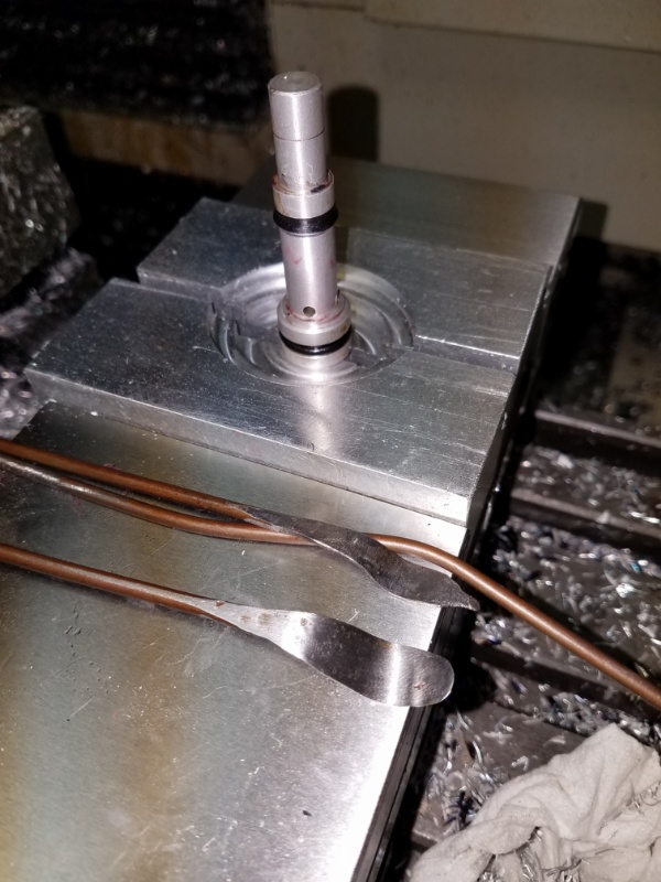

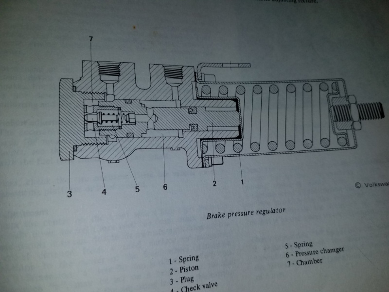

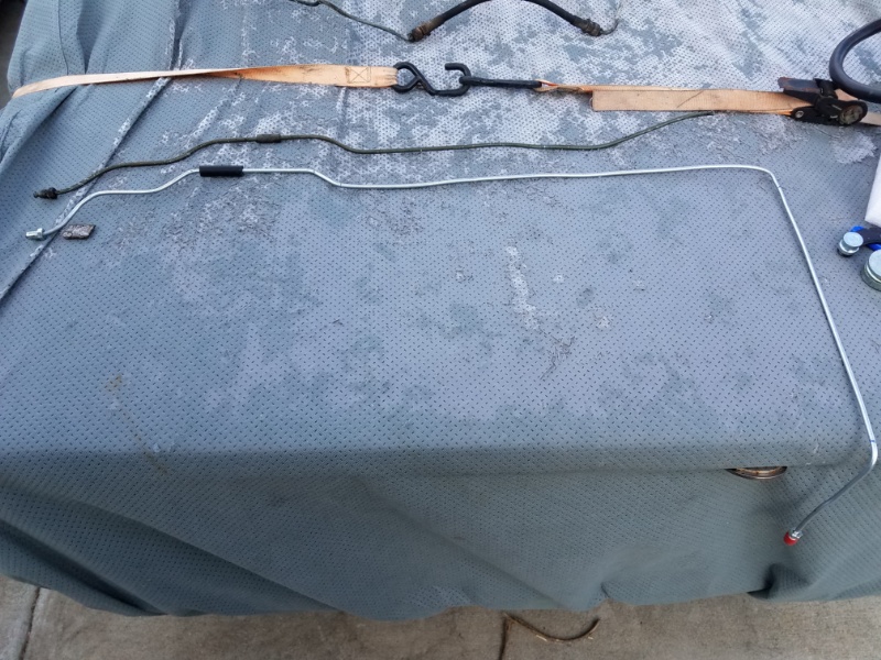

Got the pressure regulator back together with the new seals from @pmb.
New hard lines installed for the rear brakes.

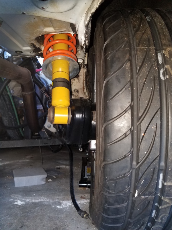

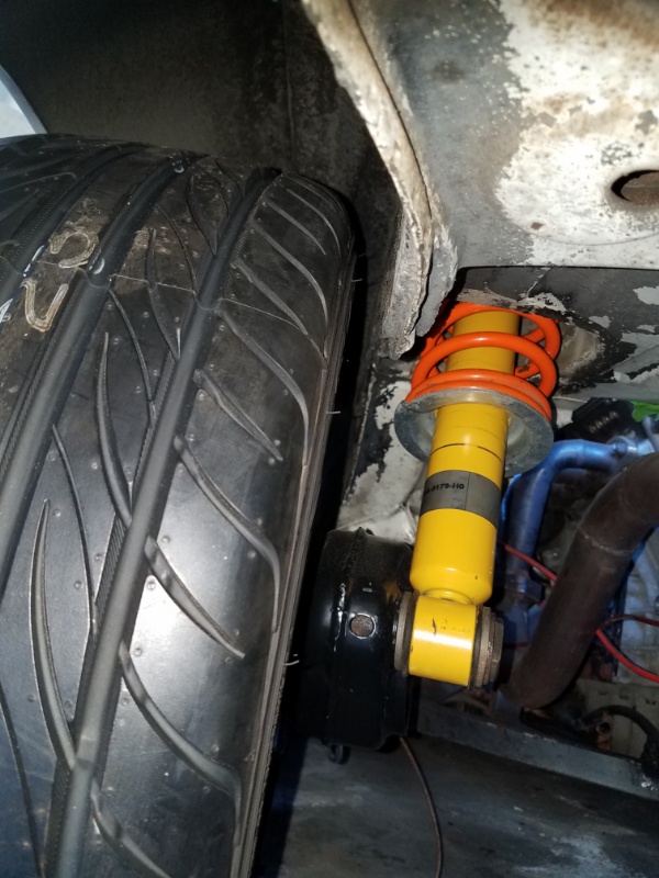

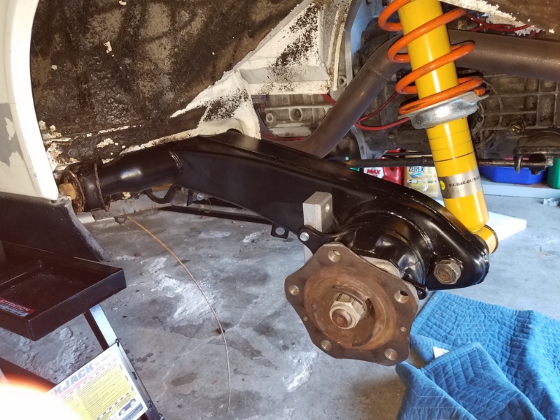

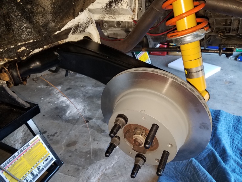

Great progress, I have a question about your Bilstein's ,,,Are those lower perches upside down ?? The old ones have a recess to hold the ring clip contained ..and the shoulder keeps the spring centered.. see pic beerchug.gif
QUOTE(sixnotfour @ Apr 1 2020, 03:14 AM) *
They are upside down. Sorry.

Mueller
Dang it, they are upside down. I kept thinking to myself what a terrible design. Will fix that today. Thanks.

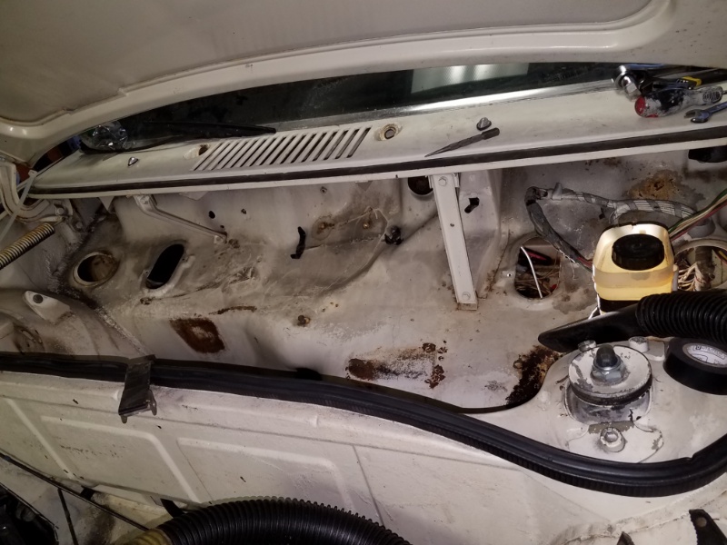

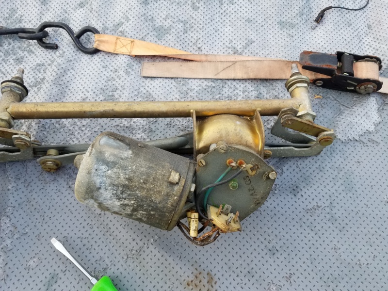

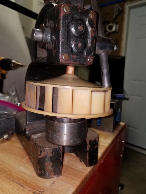

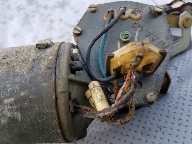

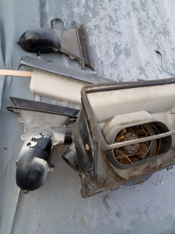

Tracing an electrical problem, it lead me to the wiper assembly.
Also notice the nice over spray on the ducting.

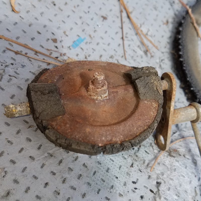

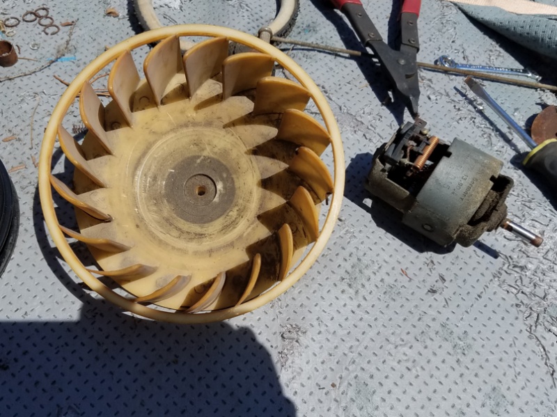

Even with the leaves cleaned out of the fan it does not turn easily. 1st time taking one apart to this level. Cast steel impeller from what it looks like in there. Wonder if a lighter fan with BLDC motor would work in there?
Picture does not show how filthy the other side of the wiper system is..nasty.

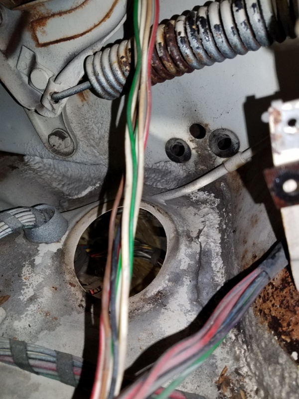

Did they really need 3 holes for the antenna cable?

Retroracer
RE: "three holes for antenna cable"
So I have the same three holes on my car; IIRC two of them were for hoses running to the engine intake to the carbon canister and back, routed down the rockers. Plus one for the antenna. Now in hindsight: I wish I'd welded all those shut before paint.... sad.gif
Good luck with the blower motor. I found a cheapish modern equivalent that needed some slight tweaks to fit.
- Tony
Mueller
QUOTE(Retroracer @ Apr 17 2020, 10:35 AM) *
- Tony
So right you are, I totally forgot I pulled those lines while I was installing my brakes. I kept them all so I can put them back later on in the build.

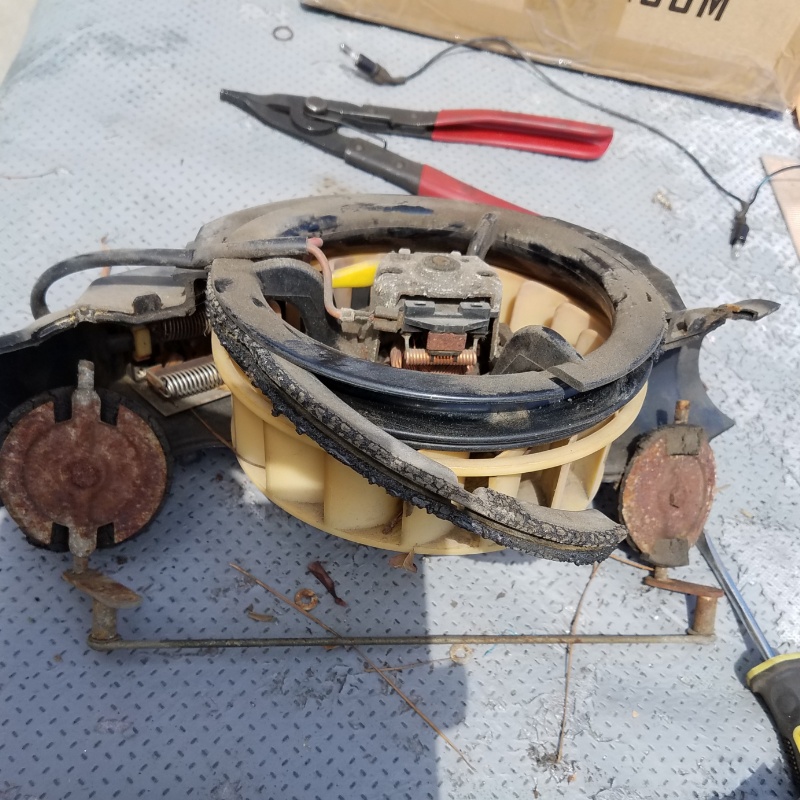

Took the blower apart. Found a replacement Bosch motor for $84 or so.
I did get the blower motor to spin freely by cleaning it with Brake Parts Cleaner. I'm sure if I clean the commutators and oil the bearings it'll live for a while longer. (sometimes you can use a pencil eraser to clean commutators)

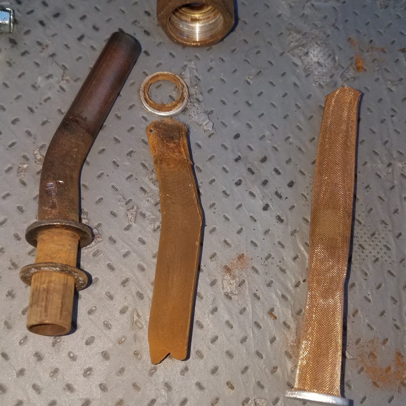

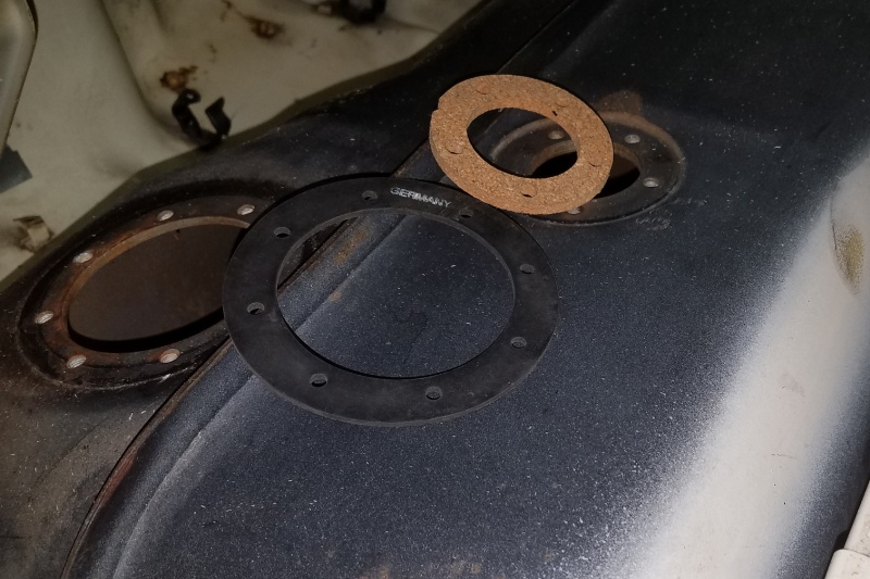

Put gas tank back in, new seals for the sending unit and filler.

Nice work on that motor and blower rebuild! IMHO the heater and fresh air system on the 914 is more complicated than the damn T4 motor...
Mueller
QUOTE(Andyrew @ Apr 22 2020, 11:10 PM) *
It's those darn ring clamps and all those circular rings that are a pain.

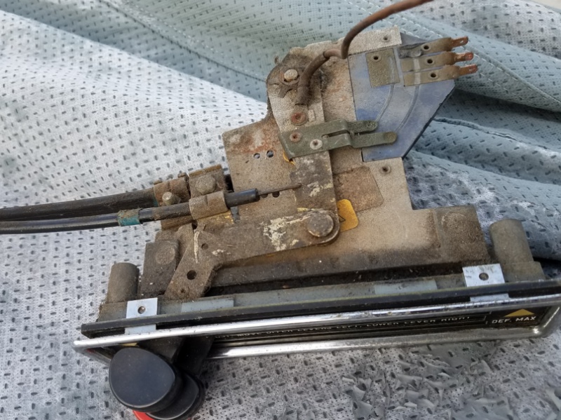

Did you find any pencils or pens in the defrost ducts? If the slide control only moves half way then one has dropped in there. BTW, the white erasers clean better than the pink erasers. They have a little grit in the white ones. Keep after it. beerchug.gif

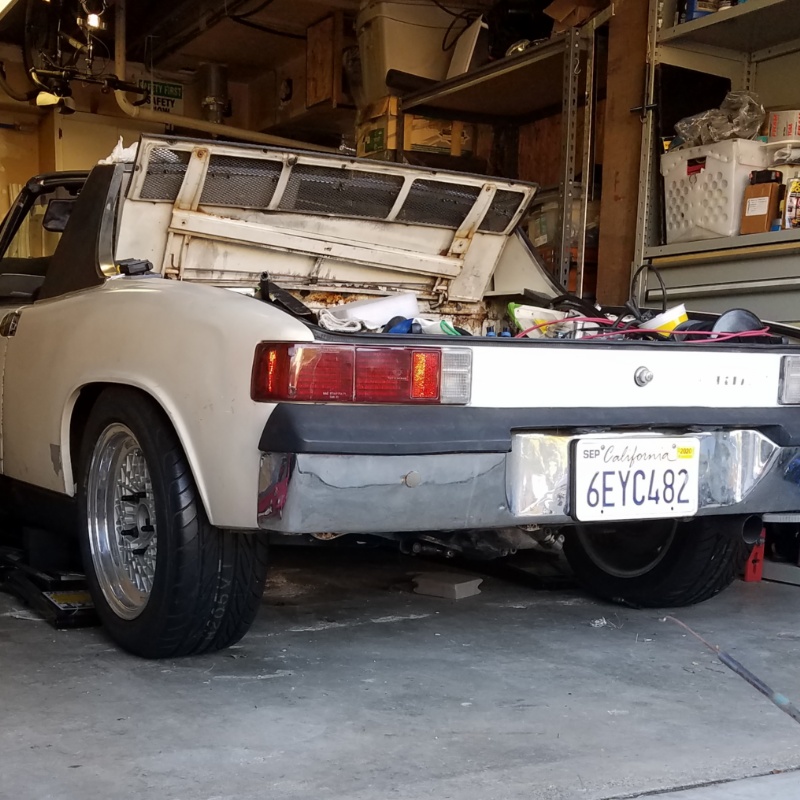

1st time on the ground with the new wheels and tires.
205/55-15 on 15x7 23.3mm offset

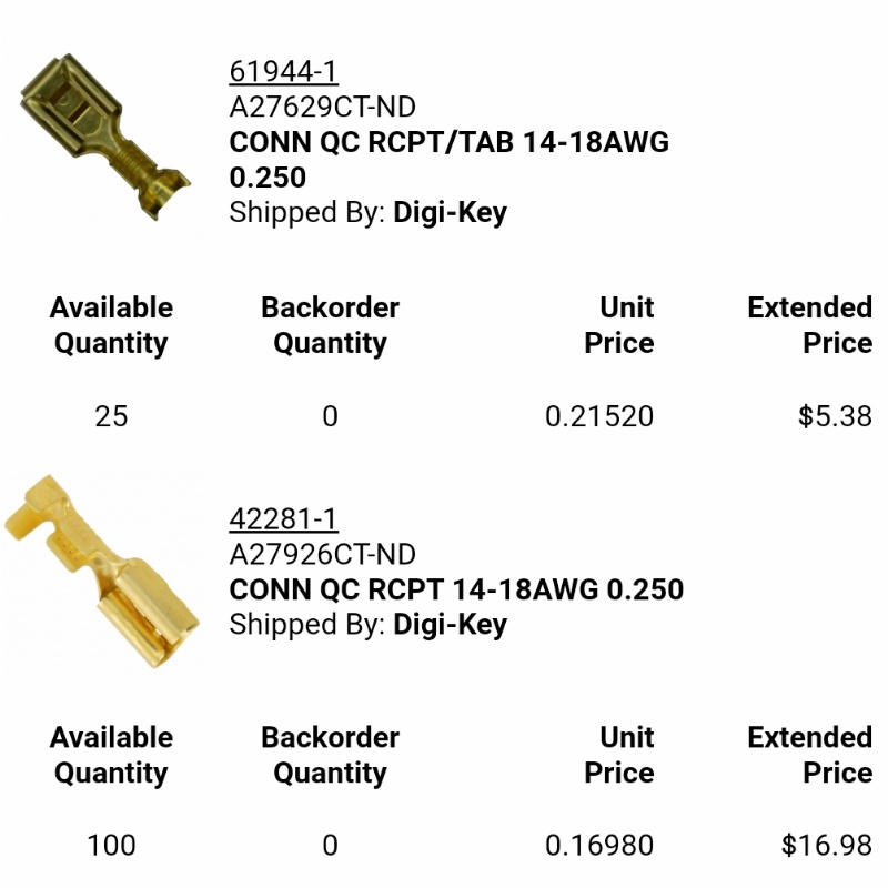

Watching with interest since I'm about to wire up, too. I'd be interested in hearing about the tools you use, where you source the little bits, etc.
Mueller
QUOTE(tygaboy @ May 10 2020, 07:31 AM) *
These solderless terminals are from Digi-Key, I wouldn't waste my time and money on cheaper ebay/Amazon pieces. I'll post some pics later on comparing a few.
The Digi Key terminals are the only way to go. You should also get the corresponding male pieces.
I use the Tool Aid krimper
https://www.amazon.com/Tool-Aid-18930-Ratch...k/dp/B000K1CFXO

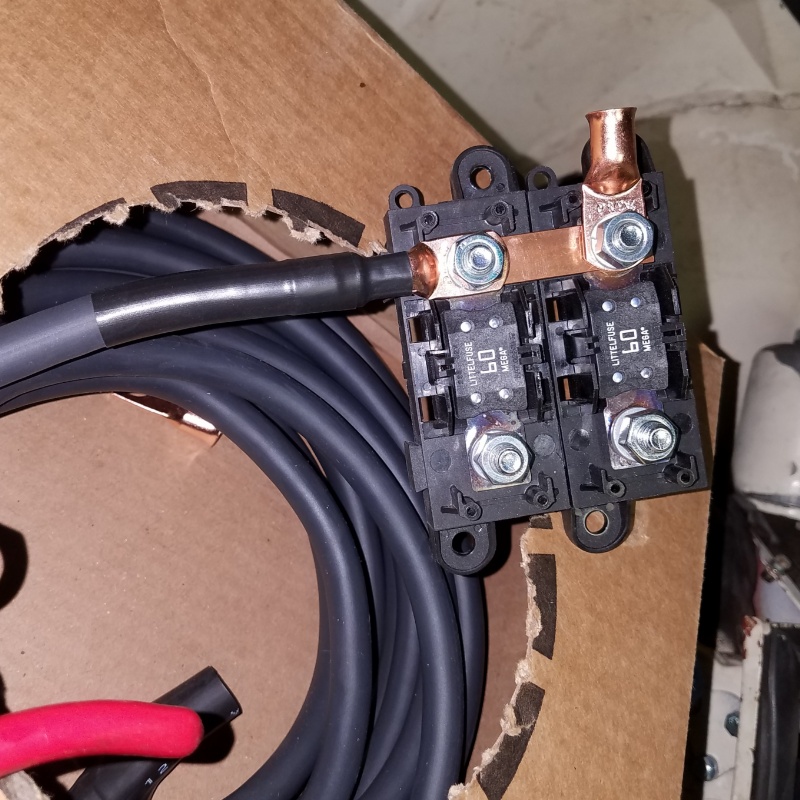

Got to run some bigger wire for the front power module, gave me a chance to use my $40 special crimper from Amazon. That is a #2 wire.
cali914
Damn Mike what are you running 15 speaker 4 amp Bose stereo. 60amps seems like a lot. Looks damn good though. We fired up car got it running but the engine had a blown head gasket. Pulled it all apart and rebuilding thats life.
Mueller
QUOTE(76-914 @ May 29 2020, 03:11 PM) *
I have another 70amps that I am going to daisy chain off the end of that line. I already had this cable and I'm tired of spending money on the car so I figured I'd use it.

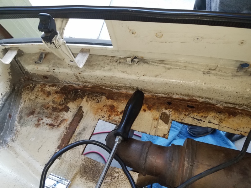

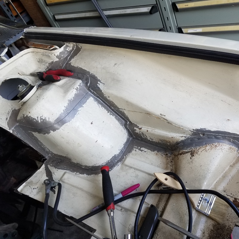

Removed the rest of the seam sealer in the rear trunk.

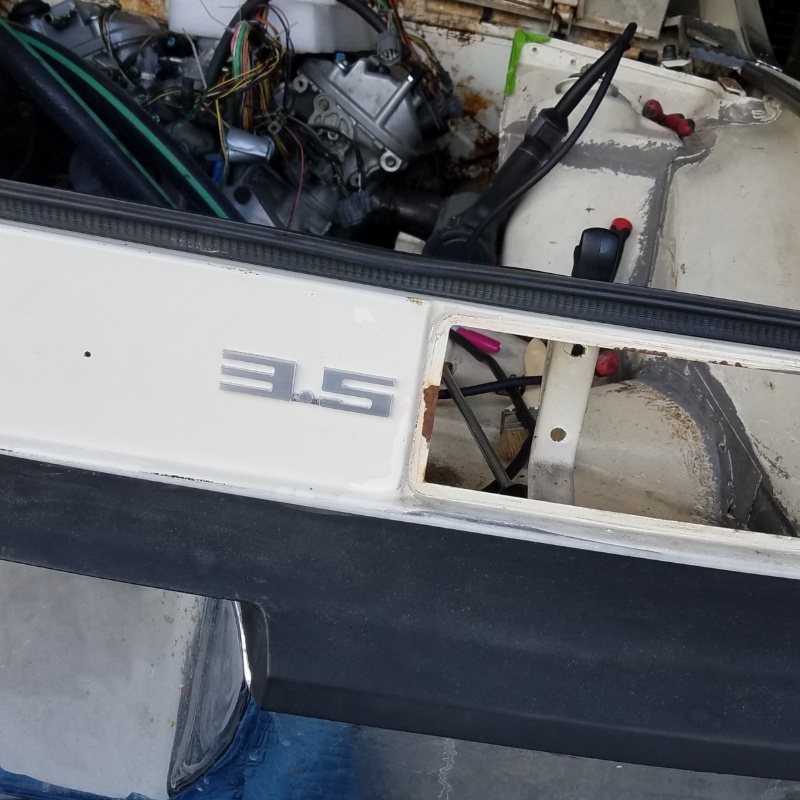

Threw a 3.5 emblem on the back...

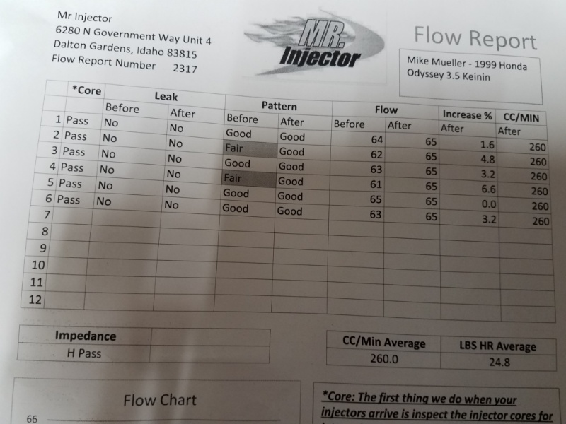

Cleaned injectors back to me.

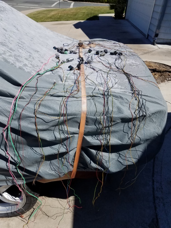

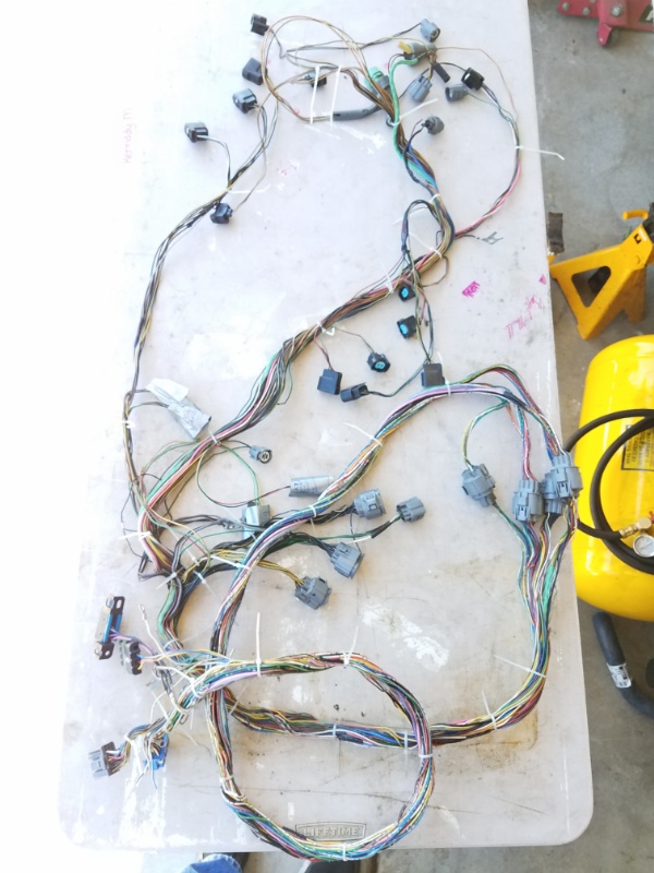

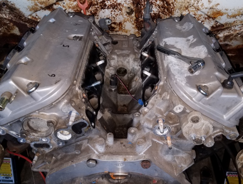

More wiring harness work, on table is stock engine harness.
After dissecting the harness I have each component separated.

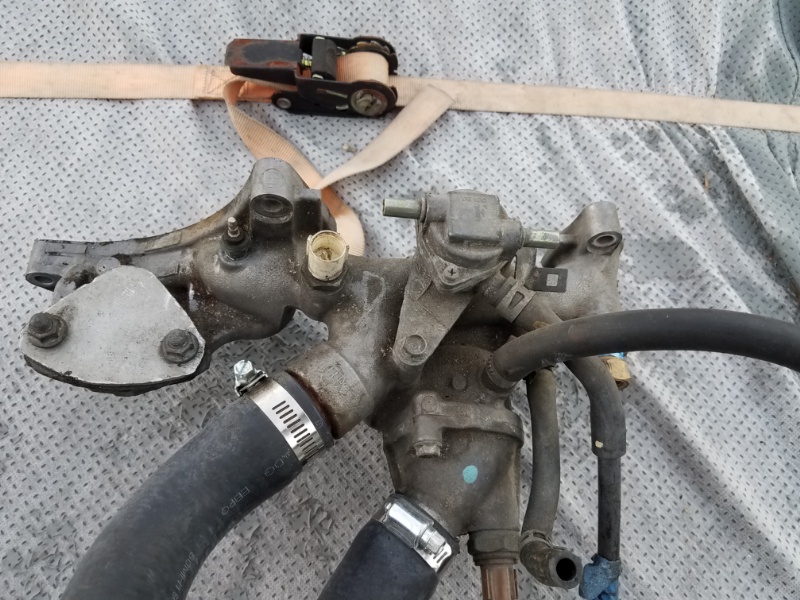

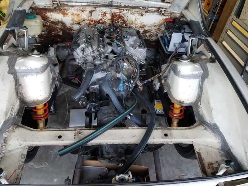

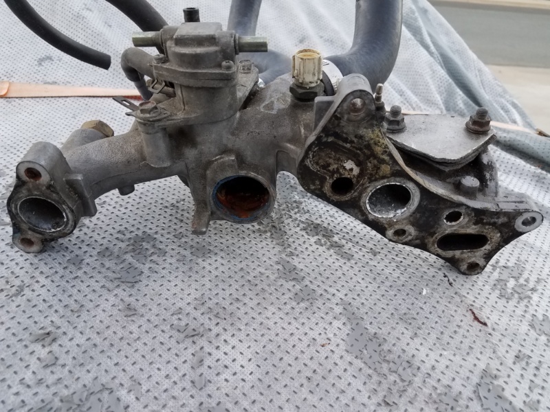

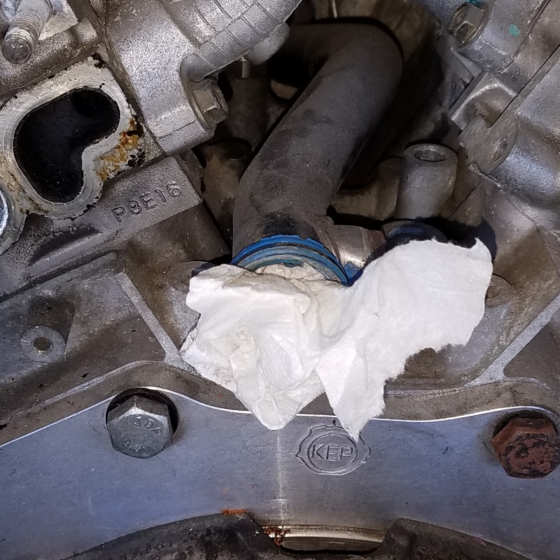

Decided to do some PM and replace some gaskets, glad I took it apart. The water crossover tube from the water pump (front of motor) to the water manifold (rear of motor) has some rust so it'll be replaced. Luckily I can get a factory replacement for $20.
