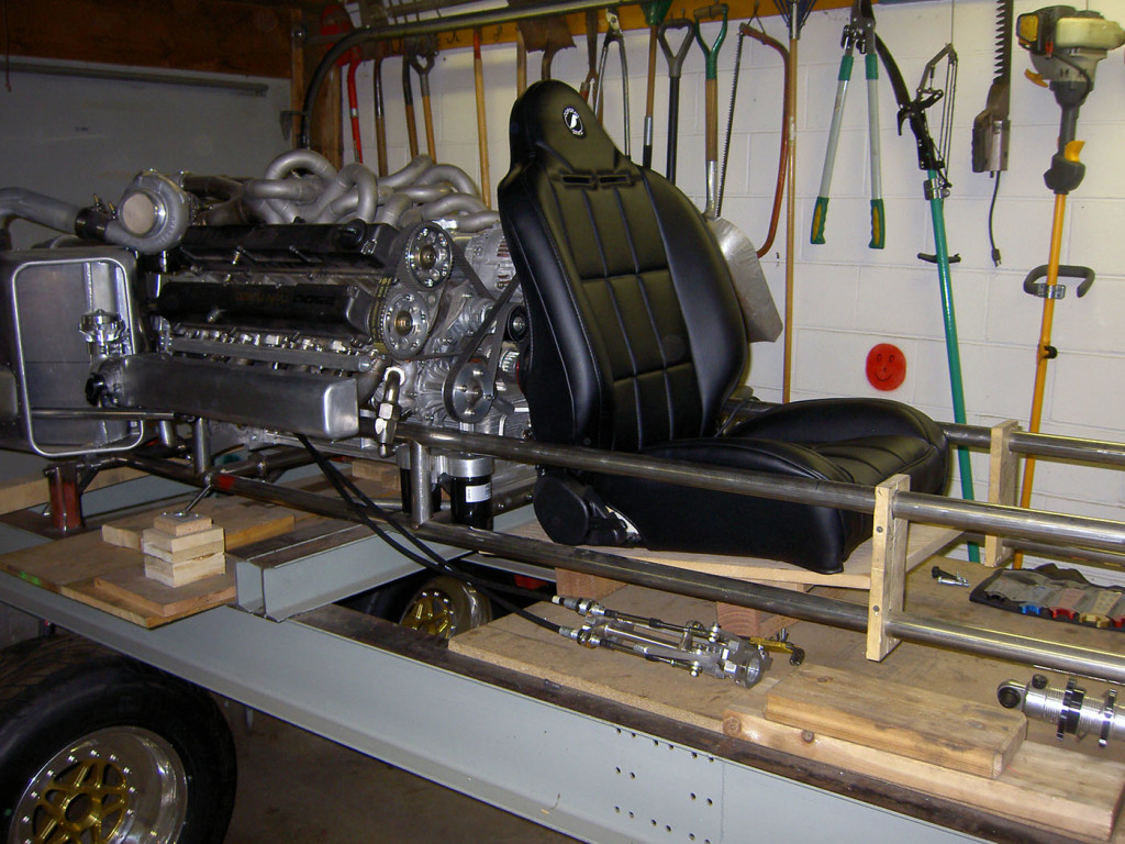

> Flat 8 ? I've seen pics of the Lind one, how about a running one here!

If VW made a flat 8 (IMG:style_emoticons/default/smile.gif)
Brazilian Flat 8
I know, not a Type IV, I would think it would be close enough to a Type I to be done the same way?

This crankcase is steel!Probably to test layout of 120* Vee angle of the cylinder banks.

dlestep   "908 firing orders (taken from a Bill Oursler...   Mar 4 2015, 11:20 PM
veekry9   This is drawn as an an interlaced crank.10 main b...   Mar 5 2015, 12:13 AM

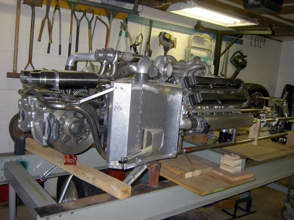

veekry9   'The Jamaro'. Back in 1969, the brothers J...   Mar 5 2015, 08:25 AM
Mueller   So it looks like it took 3 engine cases for the Br...   Mar 5 2015, 10:16 AM
veekry9   RfnN5Xna2Kc The journal is prepared by machin...   Mar 5 2015, 11:49 AM
Mueller   The journal is prepared by machining a "j...   Mar 5 2015, 12:01 PM

veekry9   Before you cut: :D Leave excess material for fi...   Mar 10 2015, 04:13 AM
veekry9   Corvair cases tig welded to an 8 cylinder config...   Mar 10 2015, 06:26 AM
