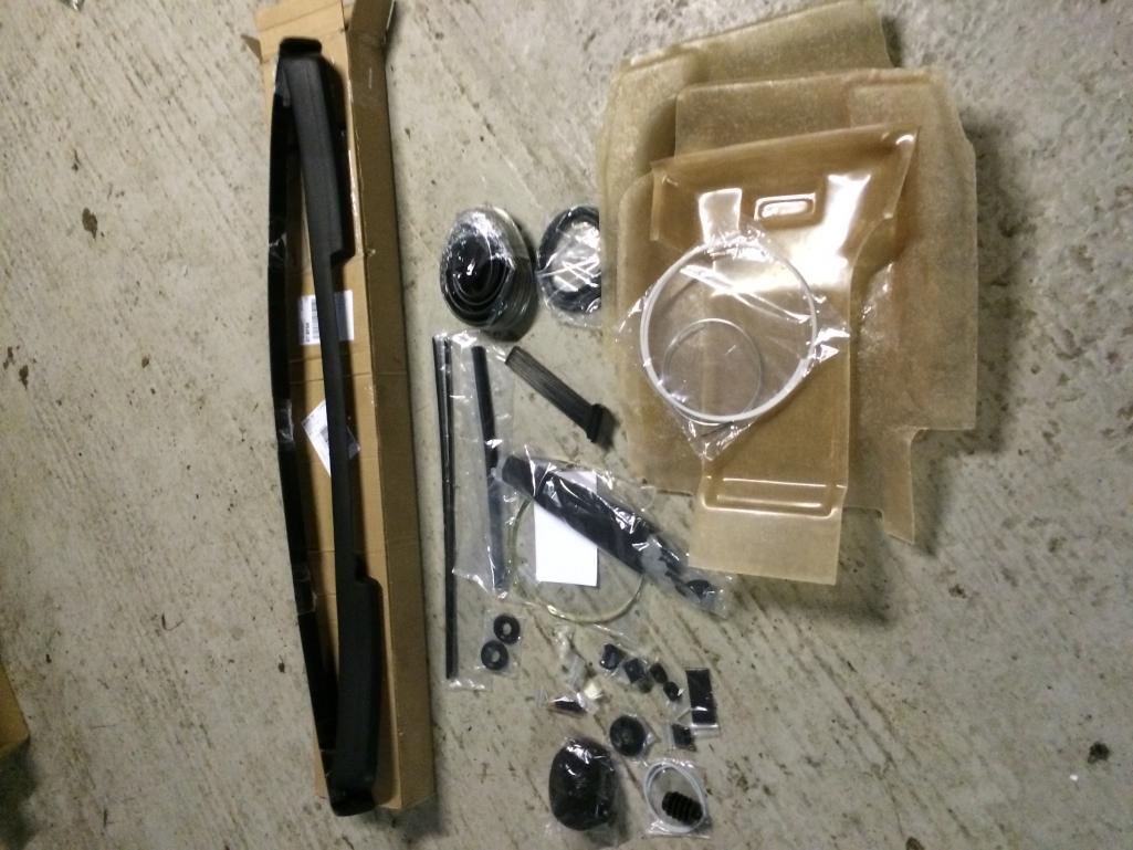

Evening all, well Santa arrived early today (aka FedEx) with a load of bits from 914 rubber , cheers Mark all arrived safe and sound
