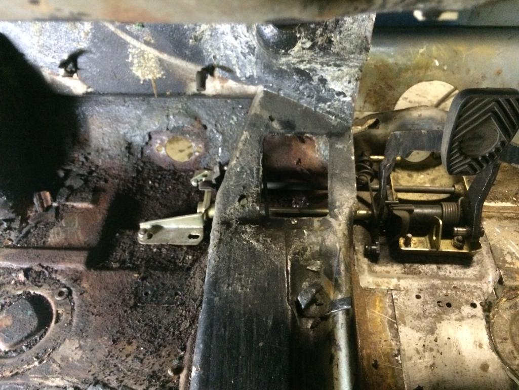

post Nov 10 2015, 04:03 PM
Posts: 139
Joined: 17-August 14
From: Uk Northern Ireland
Member No.: 17,784
It's looking like I managed to get the measurements right ! The end of the pedal rods mounts on the old LHD pedal mount !
