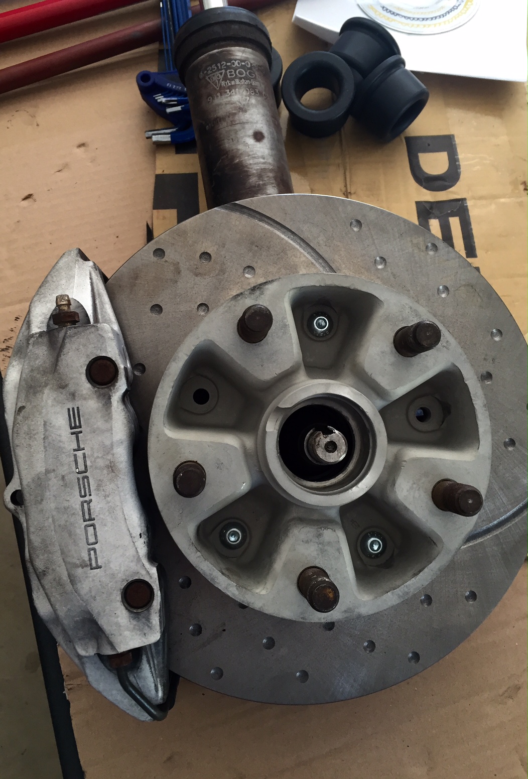

Boxster caliper stuff arrived today from rebel - all fits perfectly on my boge struts & 5 stud hubs (IMG:style_emoticons/default/smile.gif)
Picked up the calipers a couple of months back for $600 shipped from Poland ! Of all places ....
I do have a question about bolts through hub / brake disc - the book appears to say m8 x19mm with a spring washer & regular nut - all assuming in iso8.8. Is this right? And which side does the nut go ??
