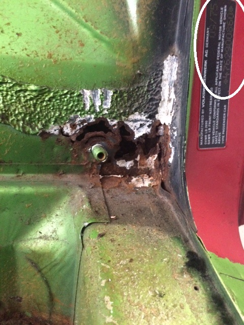

Is your car titled as a 1975? Because it looks like it's a '76.
Which explains the color thing. It didn't look like a '75 color but lime green was '76 only. Now that we know it's a '76, it's most likely lime green after all (similar to viper green).

Chris H.   It's the VIN number that tells you what model ...   Nov 11 2015, 03:34 PM
barrym   Ahh- that makes sense thanks :)   Nov 11 2015, 04:30 PM
