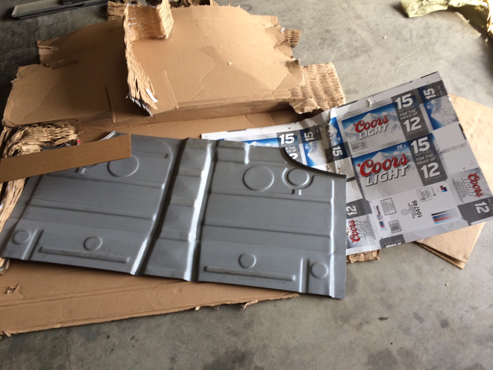

So maybe not as perfect as first assumed. Got the tar pads out only to find a PO floor repair that I've decided I want to correct. So an order goes in to our great friends at Restoration Designs. The order shows up way sooner than I expected! (IMG:style_emoticons/default/piratenanner.gif)
So I open it up and think, "Should I be concerned they consume enough beer to use the packaging to pad up their shipments?" (IMG:style_emoticons/default/lol-2.gif)
