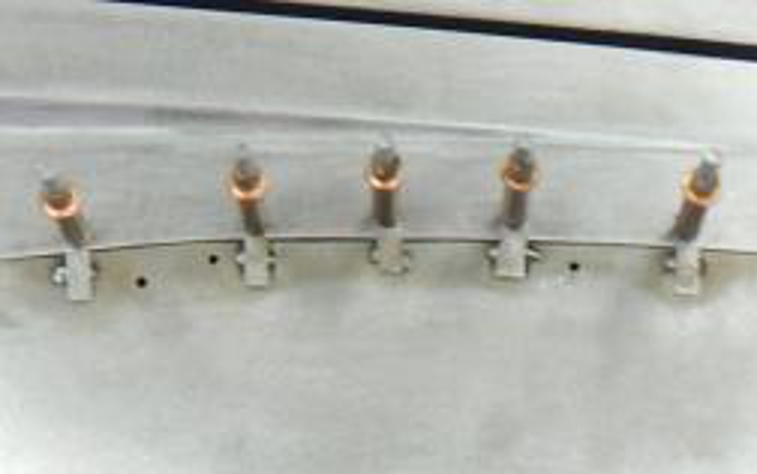

I did a closeup to show the flanging technique with the tig torch,stitch-welding the sheetmetal to circumvent a warp factor.
(A phrase all too familiar from the '60s StarTrek,originally used by Rodders chopping T's n A's).
With a O2C2H2 torch we used the same 'Trick' to make butt and lap joints with bronze fillrod.Small bronze Robertson screws did the job too.
