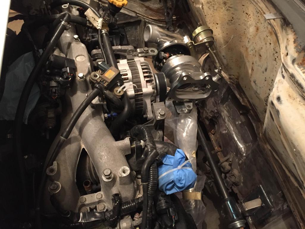

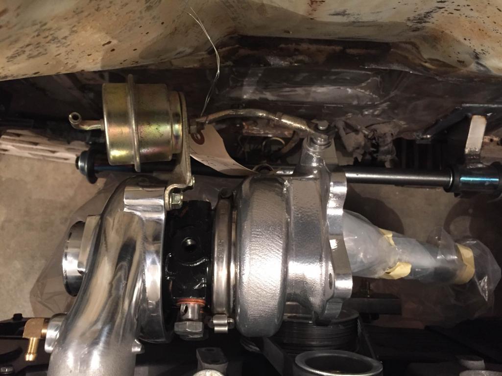

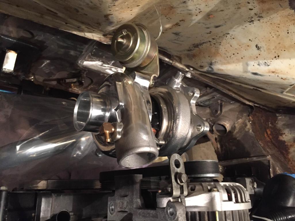

I have the motor and transmission in place so I can finish the motor mounts. The good news is the header and turbo fits nice between the motor and the firewall. There's about an inch between the turbo and firewall.

QUOTE(madmax914 @ Oct 13 2015, 08:56 PM) *
Are you considering flipping the intake manifold to shorten your charge pipe? Or possibly adding a water to air intercooler because the airflow for the air to air intercooler is not that great. I would recommend this addition while your at it.
madmax914
post Nov 13 2015, 01:58 PM
Posts: 204
Joined: 16-February 14
From: Salem, Oregon
Member No.: 17,007
QUOTE(porsaru @ Nov 13 2015, 09:46 AM) *
I have an air to air innercooler and tubing that came with the motor that I may work for me. This motor was previously in a 914 and he didn't have the intake flipped, I'll have to wait when at that point to see what I'll need to do. The passenger side of the motor will have the pipe coming off the turbo so there will be an issue with heat on that side so that leaves me with mounting one above the motor on the left side or even the rear trunk area. I'm very fortunate about an hour north of me is Extreme Turbo Systems, they can build custom innercoolers and the plumbing to maximize the effectiveness of the turbo. Stay tuned this just staring to get interesting.

madmax914   I have the motor and transmission in place so I ca...   Oct 13 2015, 09:56 PM
porsaru   I have the motor and transmission in place so I c...   Nov 13 2015, 11:46 AM
madmax914   I have the motor and transmission in place so I ...   Nov 13 2015, 01:58 PM
Andyrew   Pretty nice fitment! What are you going to do ...   Oct 13 2015, 10:27 PM
madmax914   Pretty nice fitment! What are you going to do...   Oct 13 2015, 10:37 PM

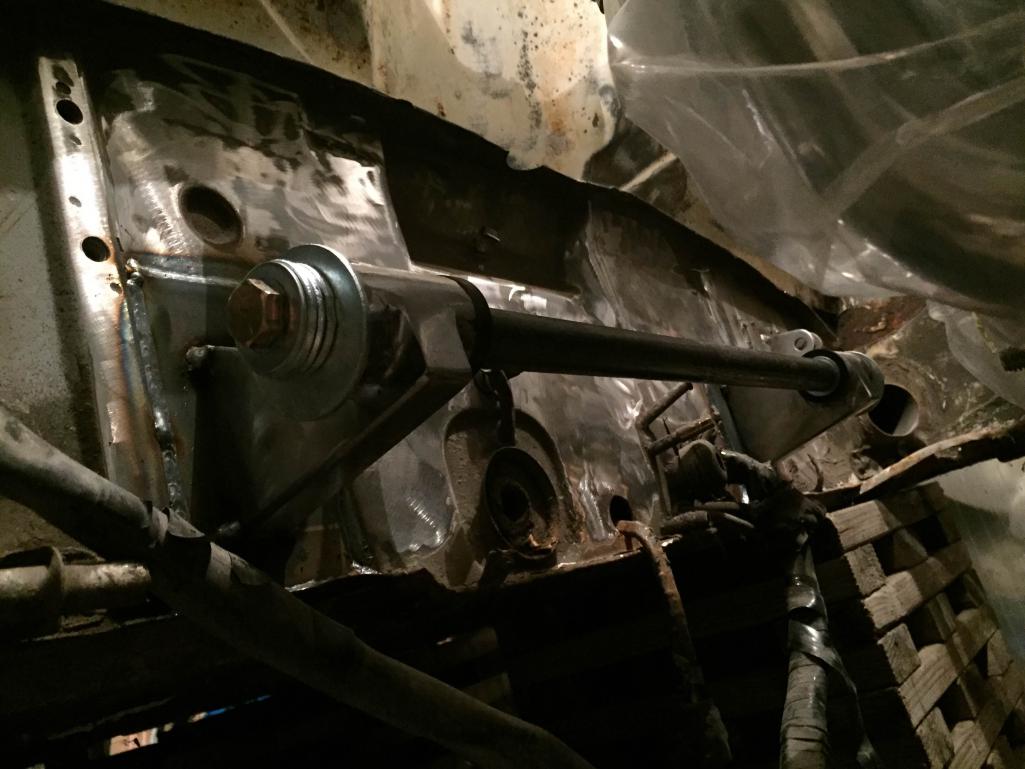

madmax914   Finished the front bulkhead motor mount.   Oct 25 2015, 07:19 PM
madmax914   If you look close you can see the Small Car motor ...   Oct 25 2015, 07:23 PM
madmax914   It's difficult to see but the oil pan is just ...   Oct 25 2015, 07:33 PM
Mueller   Nice looking mount!   Oct 25 2015, 07:51 PM
madmax914   Nice looking mount! Thank you, it is working...   Oct 25 2015, 08:35 PM
Andyrew   Good job on the mount!   Oct 25 2015, 09:54 PM
mgp4591   The mount looks pretty slick! What did OF char...   Oct 25 2015, 10:41 PM
madmax914   The mount looks pretty slick! What did OF cha...   Oct 25 2015, 10:54 PM
