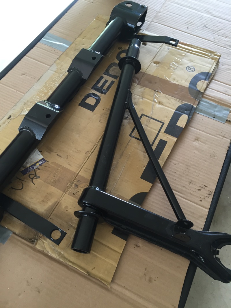

barrym
post Nov 14 2015, 03:04 PM
Posts: 88
Joined: 12-October 14
From: Australia
Member No.: 18,008
Cross bar & control arm back from powder coating - like new !
