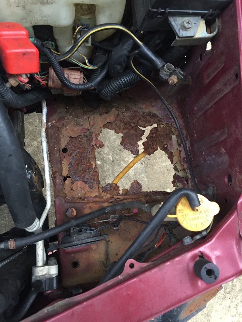

I bought a my2000 wrx for the engine/ gearbox etc- I knew it had a little rust in the roof, but wasn't prepared for this when I took the battery out !
