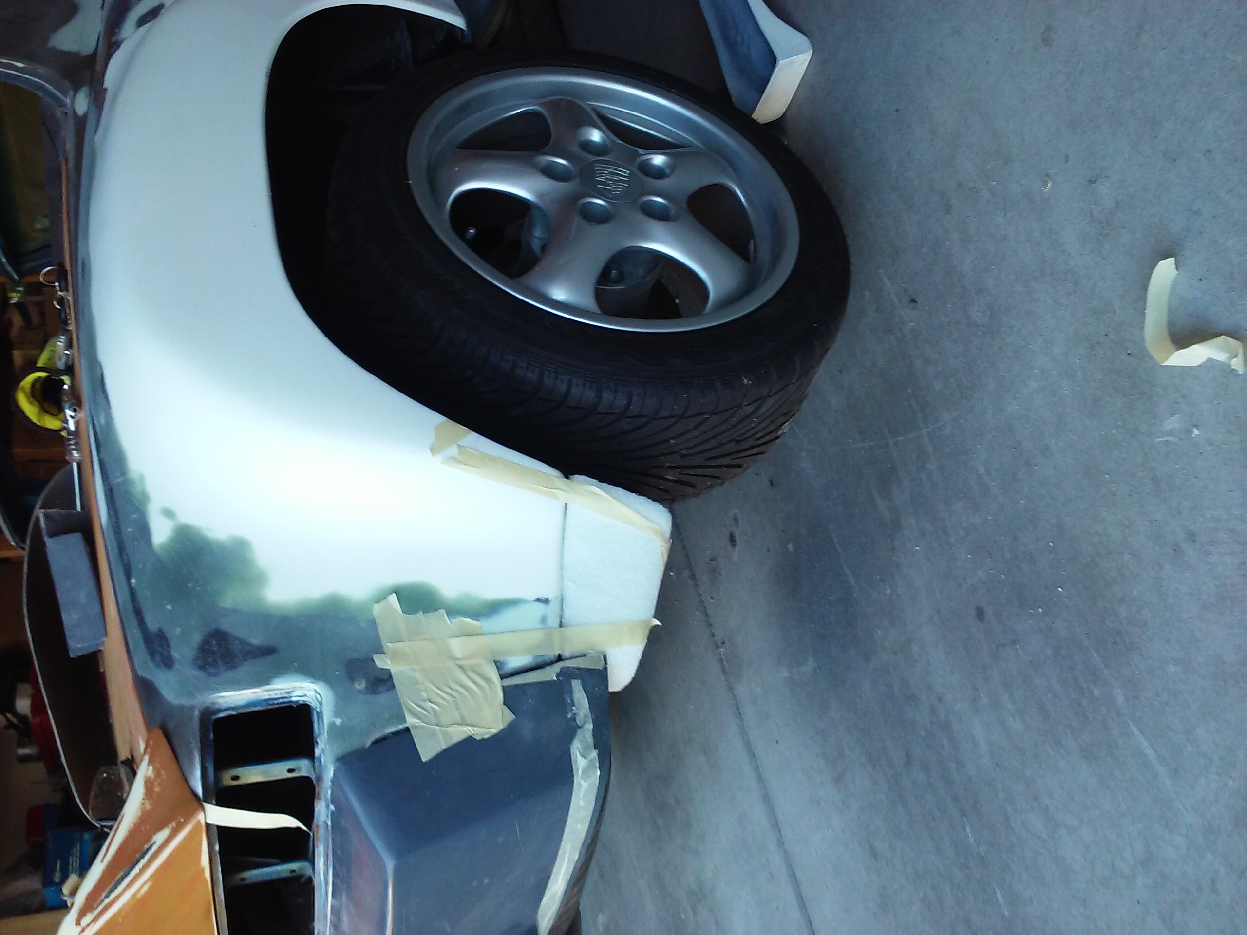

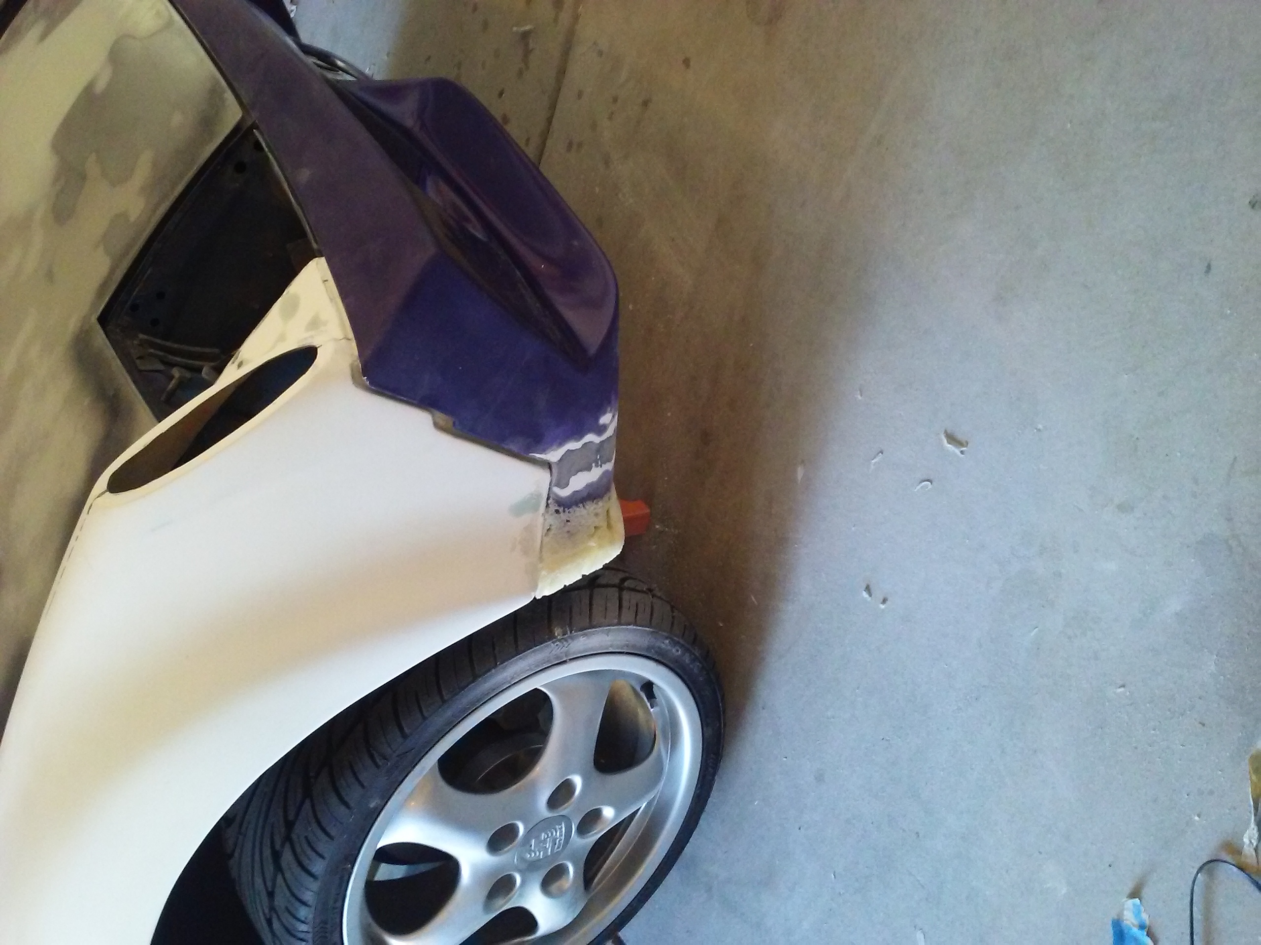

Starting to fabricate flares into the bumpers. Using foam cores as a trial run. I will blend the rear as it is in first pic into the flares in second pic. Making progress in other areas as well. Getting ready to install front sway bar.

raw1298   Starting to fabricate flares into the bumpers. Usi...   Nov 14 2015, 03:22 PM
raw1298   After forming the foam and coating with bondo its ...   Apr 6 2016, 01:26 PM
