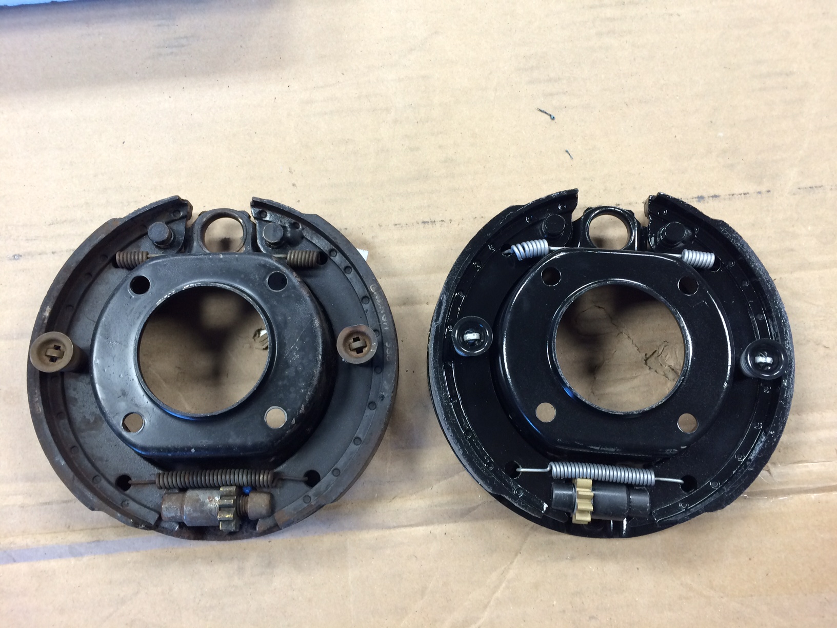

Working on the 911 e-brake set up. Got so excited about getting one done I spaced out on the fact that I have to modify the backing plate to fit the 914 trailing arm. Oh well, it's only paint and I wanted to powder coat them anyway!
