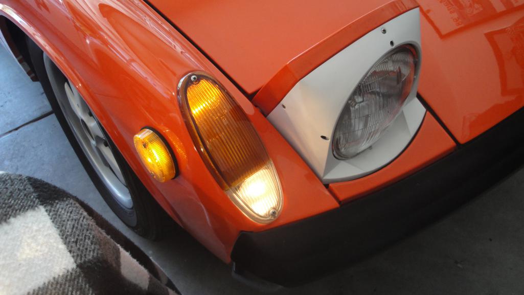

I have typical cruddy, yellowed white headlight surrounds on my repainted car and I want to restore them the best I can.
Painting them would be easy and look o.k. but I know it is kinda frowned upon by the purest because it is not original and I agree.
Any known tricks out there ?

These are painted. using the Krylon plastic primer and Rustoleum Shell White Satin Finish, 7793830 - 12 oz. Spray Looks far better than my original set on my 914/6.
http://www.rustoleum.com/product-catalog/c...in-enamel-spray
