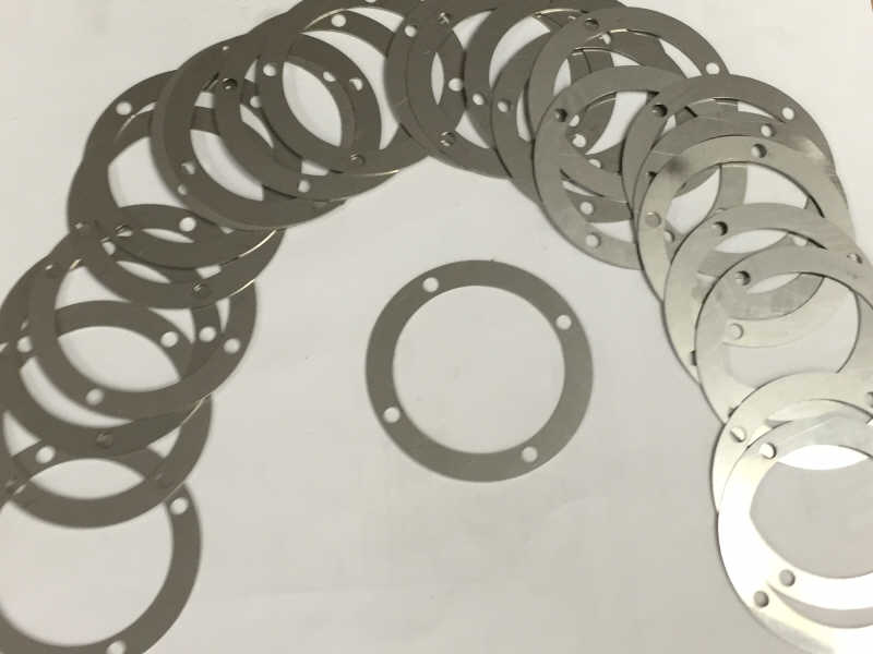

Pic of the 2.0L spacer ring
Pic of many 2.0L spacer rings

These gonna be available on your web site Chris?

Bleyseng   Pic of the 2.0L spacer ring   Feb 22 2015, 05:35 PM
Racer Chris   Pic of the 2.0L spacer ring Pic of many 2.0L spa...   Nov 19 2015, 09:07 AM
914_teener   [quote name='Bleyseng' post='2150304' date='Feb 2...   Nov 19 2015, 12:48 PM
Racer Chris   [quote name='Bleyseng' post='2150304' date='Feb ...   Nov 19 2015, 03:28 PM
