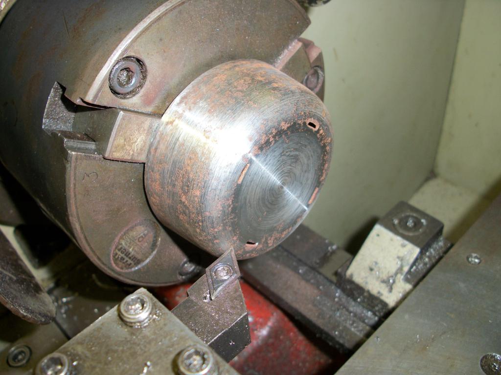

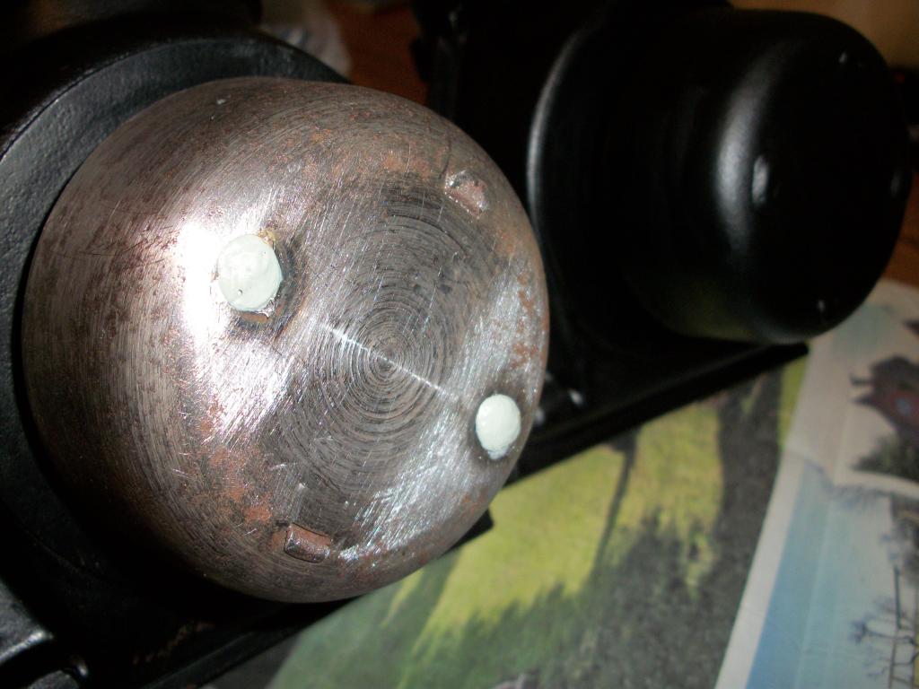

I managed to put a second coat of paint on the fuel expansion tank securing ring, and a final coat of fuel resistant lacquer (for those few occasions at the petrol station when the fuel pump doesn’t cut out soon enough or the angle causes flood back in the filler neck). I used an engine enamel black paint which should be fuel resistant, the lacquer is belt & braces.
Then in my bloomin cold shed I did a bit of tin bashing on the cover plate that I took off to access the master cylinder. There were a few scrapes and dents in it from contact with road debris over the years. I got it reasonably presentable and hope to drop it off at the powder coaters for a bead blast and re paint. Just need to source some new lip seal to go on it afterwards.
I called the local Porsche Centre and ordered a new cap to replace the hairline cracked one on the brake reservoir. Still available and only a shade over £6! I also ordered a new seal as I’m not sure if it comes with the cap or not. The guy was ok about it and said if the cap has a seal then he’ll hang onto the extra one.

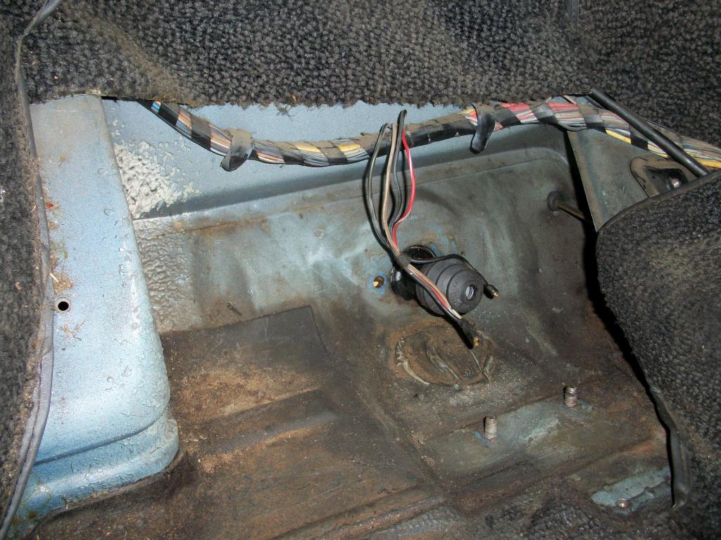

Next I took a meter to the electrics and ended up under the passenger seat. Seat removed I tested the safety belt relay and plugs. I opted to make a 6mm yellow cable link wire between pins 50 and C.
The relay was actually working but the solenoid was not happy. I suspect that the contacts inside the relay are burnt/dirty with age or the pull from the coil inside is weak causing a bad current flow & voltage to the starter solenoid.
Ignition on (I took the brake light switch off and taped the wires to stop the brake lights being on constantly until I get a new switch, and isolated the brake pressure warning to stop the constant light and sound effects) Eureka the engine spun over freely, no more “rurr…..rurr…..click…..rurr”. Result!
I then checked power on the relay board in the engine. Very strange? I kept getting some dodgy readings a few volts then 13V then nothing? Trying again I found that if I put pressure on the meter probes while testing the fuse pins the voltage varied.
I popped the fuse out and the end cap fell off!
When it was in the holder the wire looked fine, but in reality there was a break. (So Battery off yet again)

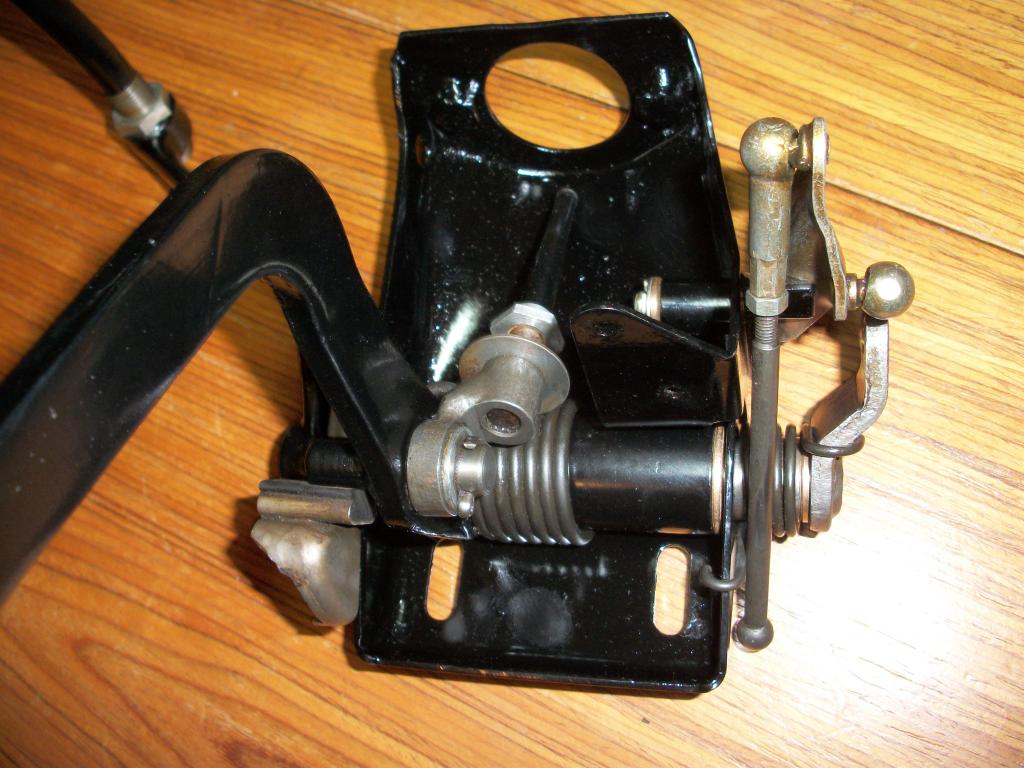

When I arrived home I had a nice new set of Original Porsche pedal rubbers waiting (ebay purchase) ready for the pedal assembly rebuild. Having thought about the pedal assembly I opted to go for a bronze bush set to replace the missing/failed ones in my car.
While waiting for them to turn up, I spent a couple of hours rubbing down the pedal mounting bracket and gave it a coat of primer. Hanging on a wire hook over my hall radiator it was good to topcoat the following evening. I also cleaned up the front brake pad pins in the lathe again like I did the rears and gave them a zinc spray. I was hoping to x-ref new ones but they seem to be too long to match all those at my local motor factors. The rear pins are particularly unique to the 914 caliper with the two diameters and the shouldered sections.
To be fair my originals have cleaned up really well, so it was just the spring clips that were urgent since some were completely missing.

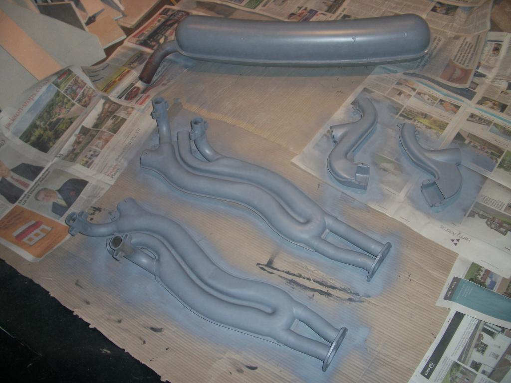

After the pedal mounting bracket primer was dry I gave it a wet & dry key and a coat of black satin engine enamel. (engine enamel resists oil so any greasing of the pedal assembly wont attack my nice new paint job).
After hanging the bracket back in front of the radiator again (too cold in my shed for paint) I started sanding down the pedals and shafts themselves. As my original bushes were non-existent the pedals had “fallen” over to the sides and rubbed on the wooden floor cover plate. So much so that there was a whole load of sawdust under it on the floor and the slots in the wood had a nice worn bow in them.
Anyhow I sanded them all down and gave them a coat of primer in my shed and brought them into the warm to dry once they’d gone tacky to stop them stinking the house out.
I also tracked down a nice new Dansk rear exhaust box on ebay. While under the car at the 1st weekend of the month working on getting the clutch cable out I found a hole in the backbox opposite the RH heat exchanger connection point at the bottom of the box. Most probably where the hot gasses enter and any water from combustion would collect.
I also found that the rear exchanger gaskets to back box are no longer available from Porsche, but the exchanger to cylinder head are!
Managed to track some down from Roger Bray who still has stock of both gaskets, but no exhausts.

Next I put a clear coat on the pedal assembly bracket, rubbing down the primer on the pedals themselves and giving them a coat of black. Wire hooks over the hall radiator and it was a bit whiffy again in the house!
I also sorted out some nice new split pins for the accelerator & brake pedal shafts and put another zinc coat on the brake calliper pins.
A parcel arrived with my new clutch and accelerator cable and exhaust gaskets from Roger Bray. I’d also called into Porsche Centre Portsmouth and picked up the two handbrake cables (for info, they were cheaper than anywhere else I tried and the longer cable was the same price as the short cable, everyone else wanted more for it?) I also got some new round relays as I had to play musical relays on the relay board at the beginning of the month. A new flasher relay (I think that’s what’s wrong with the hazards and indicators and at £12 it’s worth a punt, plus changing it after so long sitting is a good idea)
Looking through Porsche PET parts catalogue before I ordered anything I worked out that the handbrake cables come with the concertina gator where the cable goes into the car (in front of engine) but not the gator/bellows at the calliper? Why this is I don’t know? But anyway I got a pair of these from Porsche centre £3 each. Well worth it as my old ones are completely shot and they stop all the dirt getting into the cable, so a no brainer to change them.
Next I have given the pedals a coat of clear lacquer and hung them back over the radiator. I also cleaned up the pedal springs and fittings. The coils were full of 40 years of grit from the soles of shoes so needed a good sorting out before they went back on.

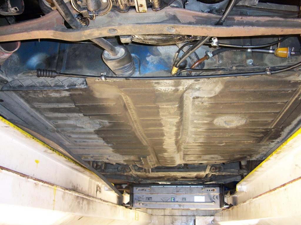

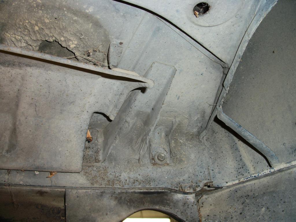

The floor where the pedal bracket was removed was very dirty full of sawdust, sand, grit and general gunk. I gave it all a good clean with the intention of painting it before the pedals went back, but once I vacuumed it and wiped it with a damp cloth, blue paint was revealed. No rust at all, just the original factory primer with a dusting of blue exactly as it left the factory. I’m a sucker for keeping stuff original so instead of painting over the floor I gave it a coat of clear waxoil just under the area where the wood panel covers. I was careful not to apply too much and keep it off where the carpet goes as it never really dries. It was just basically applied where the bulkhead meets the floor and under the pedal bracket itself.
As promised I took a few photos, so you can see how rust free this little car is. I was in two minds whether to post them or not as I haven't had chance to clean up underneath yet. This is pretty much how it came off the boat.
Floor with pedal box removed
(IMG:http://www.914world.com/bbs2/uploads_offsite/i265.photobucket.com-18255-1448744909.1.jpg)
The other side showing new Master Cylinder
(IMG:http://www.914world.com/bbs2/uploads_offsite/i265.photobucket.com-18255-1448744909.2.jpg)

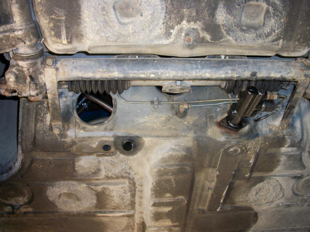

The rear of the hell hole from underneath
(IMG:http://www.914world.com/bbs2/uploads_offsite/i265.photobucket.com-18255-1448744909.3.jpg)
The Floor pan
(IMG:http://www.914world.com/bbs2/uploads_offsite/i265.photobucket.com-18255-1448744909.4.jpg)
Behind bumper
(IMG:http://www.914world.com/bbs2/uploads_offsite/i265.photobucket.com-18255-1448744909.5.jpg)

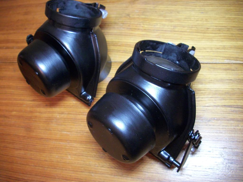

Next after work I started to clean up the heater flap boxes. One was coated in oil so barely rusted at all, the other was bone dry, so a lot of surface rust. I spent a good 3 hours cleaning them with a combination of emery, sand paper and various wire brushes before soaking them in phosphoric acid to get the bits other methods can’t reach. After a good wash off, they are currently in my oven at 100C to dry out completely. I hope to paint them black, to match the remaining original colour.

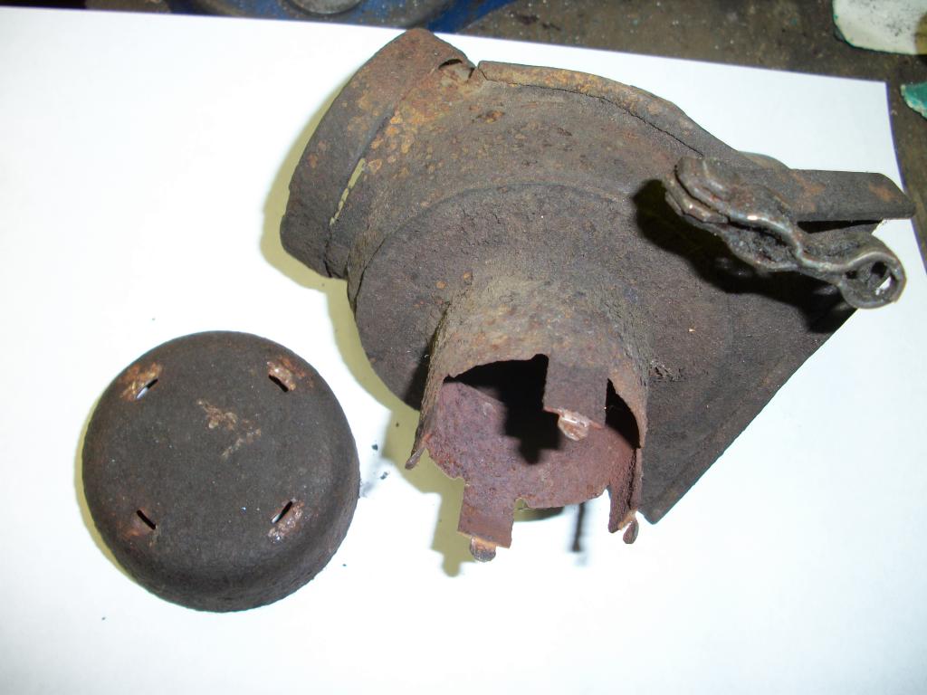

The RH Heater flap box has the dome "mushroom" cap missing and had some open ended hose connected to it? We seems to think it was a California Modification to take heat away from the fuel pump possibly. But here in UK it shouldn't be needed.
I posted on a UK forum for an old knackered heater flap box that I can rob the mushroom cap off to replace mine.
While they were soaking I set about stripping all grime, rust and paint off the spring wires that hold the rocker covers on. Rubbed down to bare metal I degreased and gave them a coat of primer.
I’m going to have to get things put back on the car soon as parts are now in 3 rooms at home, my summer house, the car mats are on the garage floor and slowly but surely the 914 is taking over.
I got home the following evening to find 6 tins of VHT grey paint, some new M7 nuts, and another packet of slotted stainless cheese head M6’s (I’d ran out when putting the engine tinware back on and thought I’d order more for the plates and ducting around the heat exchangers).
After checking all my deliveries I started to clean up more parts. I started with the “Hoop” shaped clamps that hold the ducts onto the fan housing under the car. I gave them all a good degrease, sand and wire brush up before coating with a silver zinc paint. (to match the original finish on these parts) I was also very careful to retain the cork gaskets that sit in these brackets as they were in good condition.
Next I cleaned up the clamps that hold the heater lever operating wire onto the Flap Boxes. I spun them in my lathe to clean, re tapped and then a coat of zinc silver. I got some new M5 bolts, cut them to length and faced the ends off neatly with a chamfer in the lathe.
The heater flap boxes were bone dry after last nights baking exercise after washing off the acid. I gave them a prime with some VHT primer. Apart from the missing “mushroom” cap that I fellow owner is mailing over, they came up great. I’ll let them dry overnight and paint them black tomorrow.
While still in the mood for painting I gave the spring wires (for the rocker covers) a nice coat of engine enamel black over the primer. Hanging over the radiator (yet again with other stuff) they’ve come out like new.
I’ve left the 4 x legs that hold the mushroom cap bare metal for now and cleaned them all up. Hopefully as soon as the cap arrives I can weld it on and finish the paint job on it.
The following day I was up early and put a coat of black paint on the heater boxes, then cleaned up and went to wait outside the Post Office Depo before they opened at 7am. Time was tight as I have to be at work for 7:30, but I just made it in the nick of time.

(IMG:http://www.914world.com/bbs2/uploads_offsite/i265.photobucket.com-18255-1448744910.6.jpg)
After a combination of emery and sand paper it was obvious the rust pits had really gotten hold of it, so I ended up turning it down in my lathe to get as clean a surface as I could without going too thin.
(IMG:http://www.914world.com/bbs2/uploads_offsite/i265.photobucket.com-18255-1448744910.7.jpg)
My original cap (judging by the one that’s left and the mess that is my other one) has the 4 tabs that pass through it with two spot welded. Since the PO removed it and clamped on some hose, he must have ground the spot welds and the other 2 tabs completely off! My only option was to very carefully file the tabs back onto the remaining legs. This meant that the cap sits closer to the flap housing by about 3mm, but it shouldn’t make any difference. Once fitted I bent over the 4 new tabs and spot welded two to match my un-molested one. I then used a small blob of seam sealer over the spot weld so that when its painted it’ll be a perfect match to the other. (That’s OCD for you)
(IMG:http://www.914world.com/bbs2/uploads_offsite/i265.photobucket.com-18255-1448744910.8.jpg)
Afterwards I gave it a coat of heat resistant primer and hope to paint it black in the morning.
With a whole box of heat resistant primer in my shed (in grey) I decided to get some on my blasted parts before rust could set in. I gave them two light coats and again plan to flip them over in the morning and paint the other side before I go off to work. I also gave my NOS rear box a coat to cover a range of storage handling marks and also to make sure everything looks fresh and colour matched ready to fit at the weekend.
(IMG:http://www.914world.com/bbs2/uploads_offsite/i265.photobucket.com-18255-1448744910.9.jpg)
The following morning I got another coat of heat resistant grey paint on the exhaust parts and a coat of black over the primer on the heater flap box cap.
Here’s how they look. Came out well.
(IMG:http://www.914world.com/bbs2/uploads_offsite/i265.photobucket.com-18255-1448744910.10.jpg)
When I got home that evening there was a small parcel waiting. It was the bronze bush kit for the pedal assembly.
First though, I turned over all the exhaust parts and gave them another coat of grey paint. Whilst they dried the new bushes were fitted to complete the pedal box.
(IMG:http://www.914world.com/bbs2/uploads_offsite/i265.photobucket.com-18255-1448744910.11.jpg)
I gave the exhaust parts a final coat of VHT satin lacquer to seal in the grey and left them to dry during the day.
