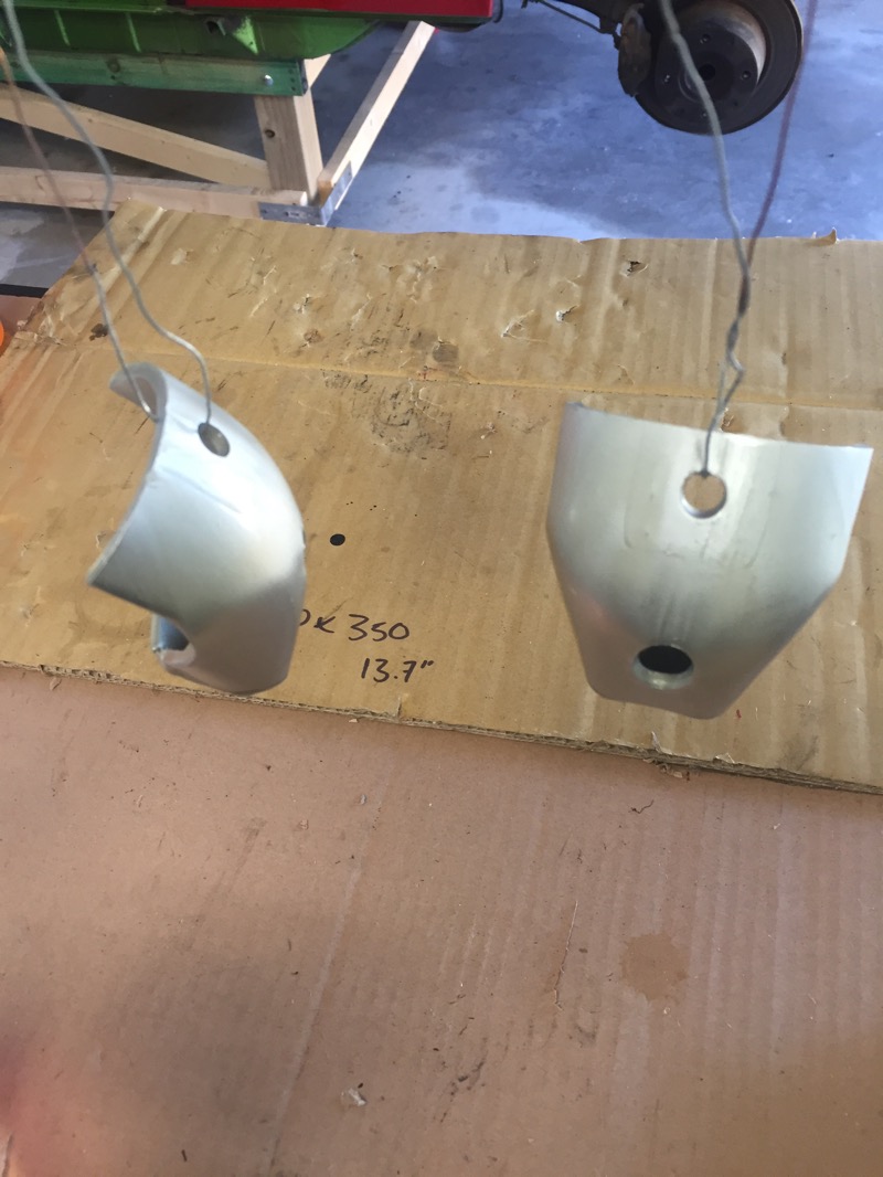

Picked up a zinc plating & passivating kit - have been busy sandblasting & plating (IMG:style_emoticons/default/smile.gif)
