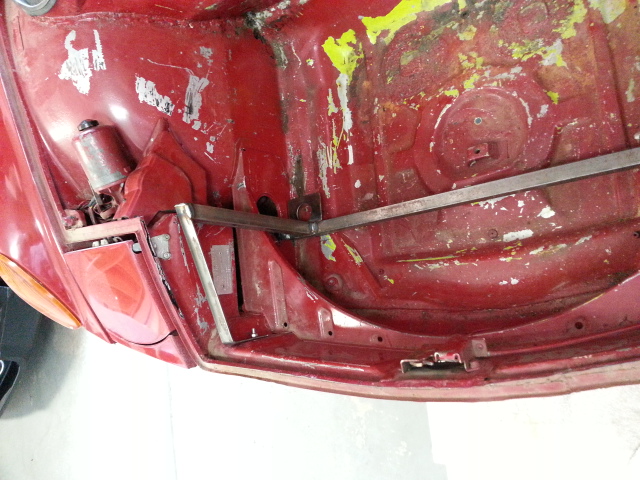

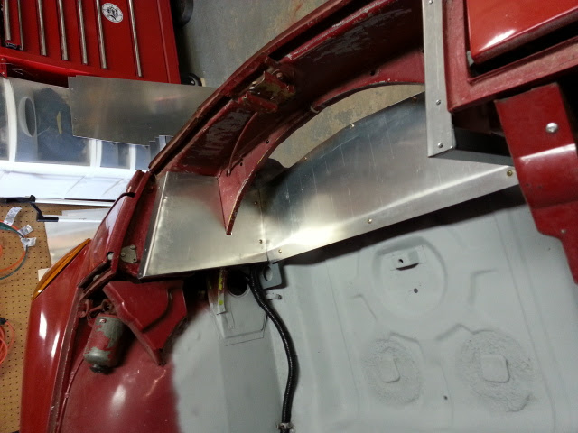

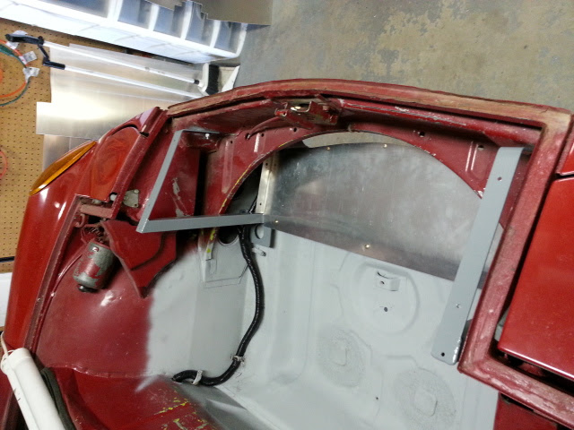

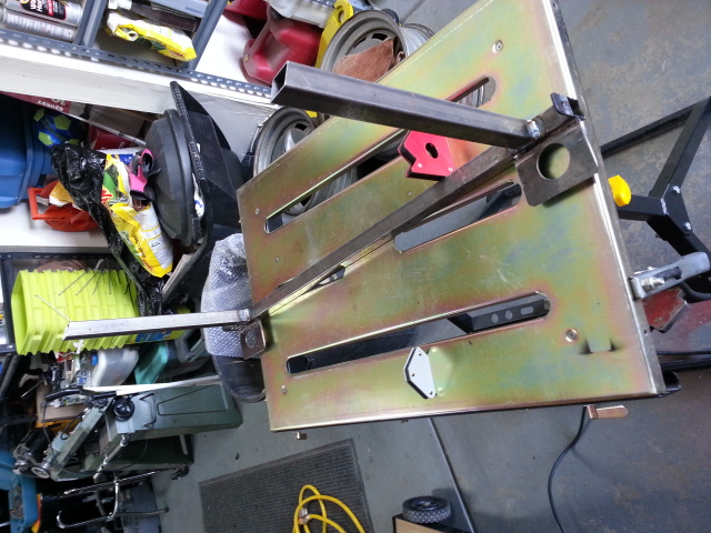

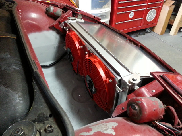

ray (aka: A&P Mech) provided me these additional pics of his celica radiator install. many thanks to ray for sharing these with us (IMG:style_emoticons/default/smile.gif)
and here is his link to the grommets he used. I think the tabs at the top of the radiator have a different OD then the bottom tabs. I will confirm. I plan to make vibration cushions of similar dimension with smooth-on product.

A&P Mech   Jim, you are correct. The top and bottom isolation...   Nov 29 2015, 10:21 AM

A&P Mech   [quote name='jimkelly' post='2270986' date='Nov 2...   Nov 29 2015, 09:02 PM
dakotaewing   Thanks Ray! What were you using for the upper...   Nov 29 2015, 10:07 PM
A&P Mech   You are correct. I made aluminum mount and found a...   Nov 29 2015, 10:22 PM

jimkelly   seems ray welded tabs at the far ends of the lower...   Nov 30 2015, 07:21 AM
A&P Mech   seems ray welded tabs at the far ends of the lowe...   Nov 30 2015, 01:48 PM
