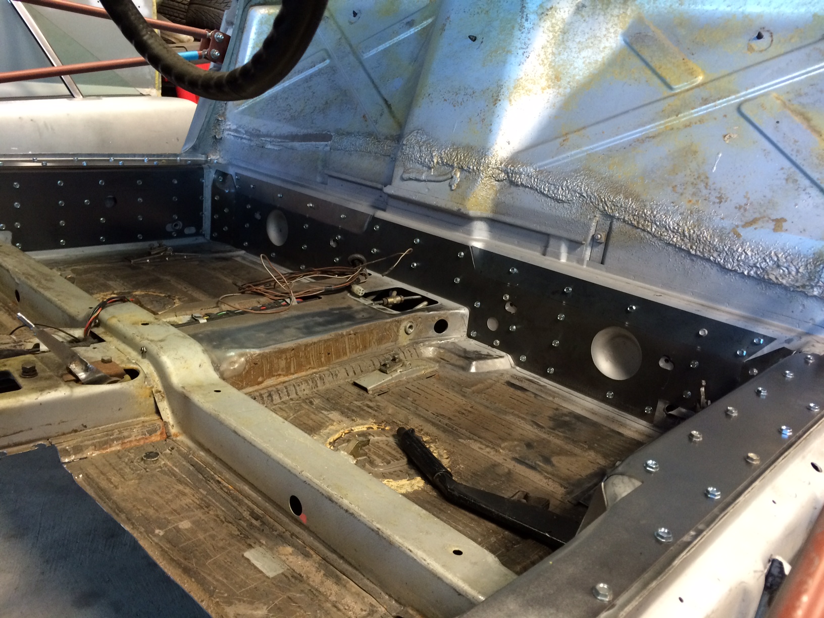

Not too exciting as everyone has seen any number of inner long stiffener kits installed but, hey, it's exciting for me! Kit ready for welding. I went w/Tangerine Racing's door brace kit. Sure, I coulda built my own but it's so nice to have a proven, bolt on solution show up and in 5 minutes, I'm back focused on the car. Thanks Chris Foley!

tygaboy   Not too exciting as everyone has seen any number o...   Nov 29 2015, 08:16 AM

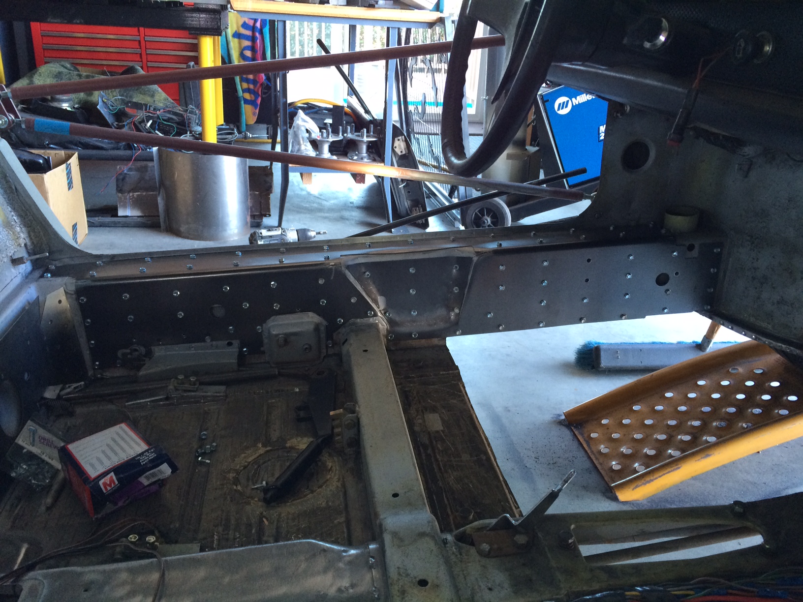

tygaboy   More boring stuff for - Long stiffener kit is in...   Dec 6 2015, 04:35 PM

Cracker   Wow. Super clean install...keep the momentum going...   Dec 6 2015, 07:46 PM
