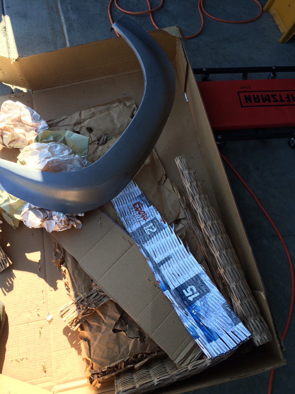

More goodies from Restoration Design! Mmmmm... flares...
And if you're like me, you like your vendors to be consistent and predictable. These guys are: great parts and: BEER CASE packing materials. Just like last time!
Makes me chuckle. I have another RD item arriving tomorrow. We'll see if they can go three for three. For now, I say to our Canadian friends: (IMG:style_emoticons/default/beer3.gif) (IMG:style_emoticons/default/beer3.gif)
