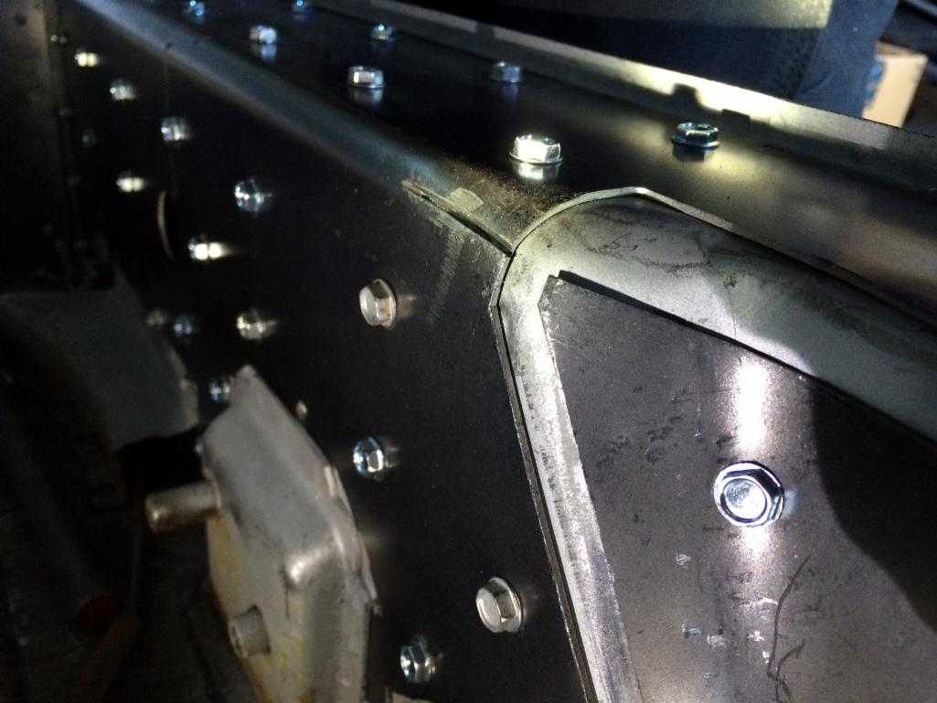

I sliced a relief cut at the corners and bonked down the edge to create a smoother transition. Is this a common practice? I figured it'd make the carpet fit a bit better...
Dave_Darling
post Nov 29 2015, 02:47 PM
914 Idiot
Posts: 15,335
Joined: 9-January 03
Member No.: 121
QUOTE(tygaboy @ Nov 29 2015, 06:19 AM) *
I would be concerned that this would take away some of the needed strength on those corners. I remember reading that the indent for the handbrake handle is one of the weaker spots of the long, and the corners say "stress riser" to me; I'd feel happier about having the second layer of material over them.
--DD

tygaboy   I sliced a relief cut at the corners and bonked do...   Nov 29 2015, 08:19 AM
Dave_Darling   I sliced a relief cut at the corners and bonked d...   Nov 29 2015, 02:47 PM
tygaboy   I sliced a relief cut at the corners and bonked ...   Nov 29 2015, 04:28 PM
