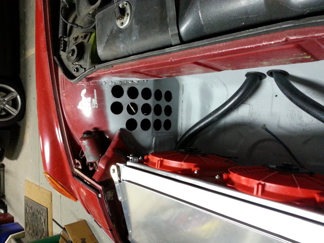

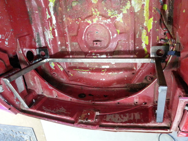

ray (aka: A&P Mech) provided me these additional pics of his celica radiator install. many thanks to ray for sharing these with us (IMG:style_emoticons/default/smile.gif)
and here is his link to the grommets he used. I think the tabs at the top of the radiator have a different OD then the bottom tabs. I will confirm. I plan to make vibration cushions of similar dimension with smooth-on product.
Jim or Ray, can you provide the link for the grommets please?
Also, Ray do you have any more detail images of your mounting frame,
especially where the mount bolts into the body at the base,
and the mounts at the top connecting to the radiator?
Thanks so much for what you have already provided !
Thanks! Thom
The link for the lower vibration mounts is:
http://www.amazon.com/Genuine-Toyota-16535...adiator+Support
There are a few more pictures in my build thread.

jimkelly   ray (aka: A&P Mech) provided me these addition...   Nov 29 2015, 08:14 AM
dakotaewing   ray (aka: A&P Mech) provided me these additio...   Nov 29 2015, 08:10 PM
A&P Mech   Jim, you are correct. The top and bottom isolation...   Nov 29 2015, 10:21 AM

A&P Mech   [quote name='jimkelly' post='2270986' date='Nov 2...   Nov 29 2015, 09:02 PM
dakotaewing   Thanks Ray! What were you using for the upper...   Nov 29 2015, 10:07 PM
A&P Mech   You are correct. I made aluminum mount and found a...   Nov 29 2015, 10:22 PM

jimkelly   seems ray welded tabs at the far ends of the lower...   Nov 30 2015, 07:21 AM
A&P Mech   seems ray welded tabs at the far ends of the lowe...   Nov 30 2015, 01:48 PM
