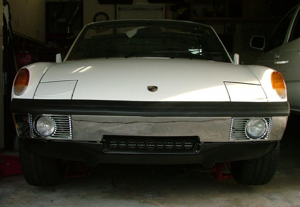

Bought This car in Nov 2013 and unfortunately it had to sit in my trailer until May of this year to get started on it. The picture is how the car looked the way I got it and how it came out of the trailer. Factory P/N steel flares, nice paint job, a not installed 3.0 close to ready to install, Oh, and an in process conversion. Just some cleaning and put it together and yes a lot of learning/ research. Because (a) I have never owned a 914. (b) never done an engine conversion (built a few). © never picked up where someone left off (you know how its easier to put something back together when you take it apart).

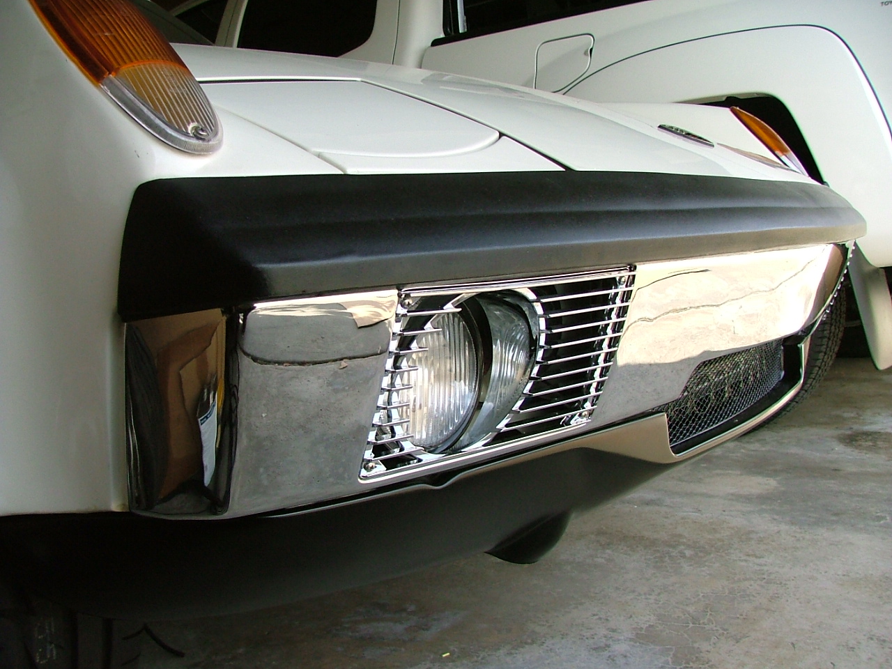

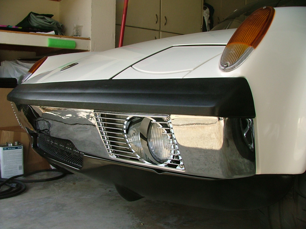

Unfortunately I have not been able to devote much time to the project over the last month but I was able to complete the installation of the front bumper. This was actually no small feat and a culmination of a several month process but dammit I really wanted a chrome front bumper!
The car as I bought it had a fiberglass bumper and lower valance. First of course was finding a decent front bumper that would be able to be chromed. The bumper I found was just ok and it did have a good bumper top. Second was having the bumper modified to accommodate the intake for the front oil cooler PLUS match up to the fiberglass lower valance. Thanks Chris! Then there was the chrome shop and almost 4 months later. Next was finding some sort of mesh screen to go in the intake. Lastly was fitting it all to the car. Trial fit, trail fit, trial fit, and trial fit.
For those looking for an inexpensive solution for the mesh screen I found at the Home Depot that gutter guard worked great and was already painted black, was close to the right size, fairly easy to work with, and like $3.00. How many parts can you buy for $3.00?
Note the PO cut extra holes for the oil cooler intake in the front panel, I just blacked out around it. Attaching the mesh to the fiberglass valance was accomplished with strategically placed tie wraps.
