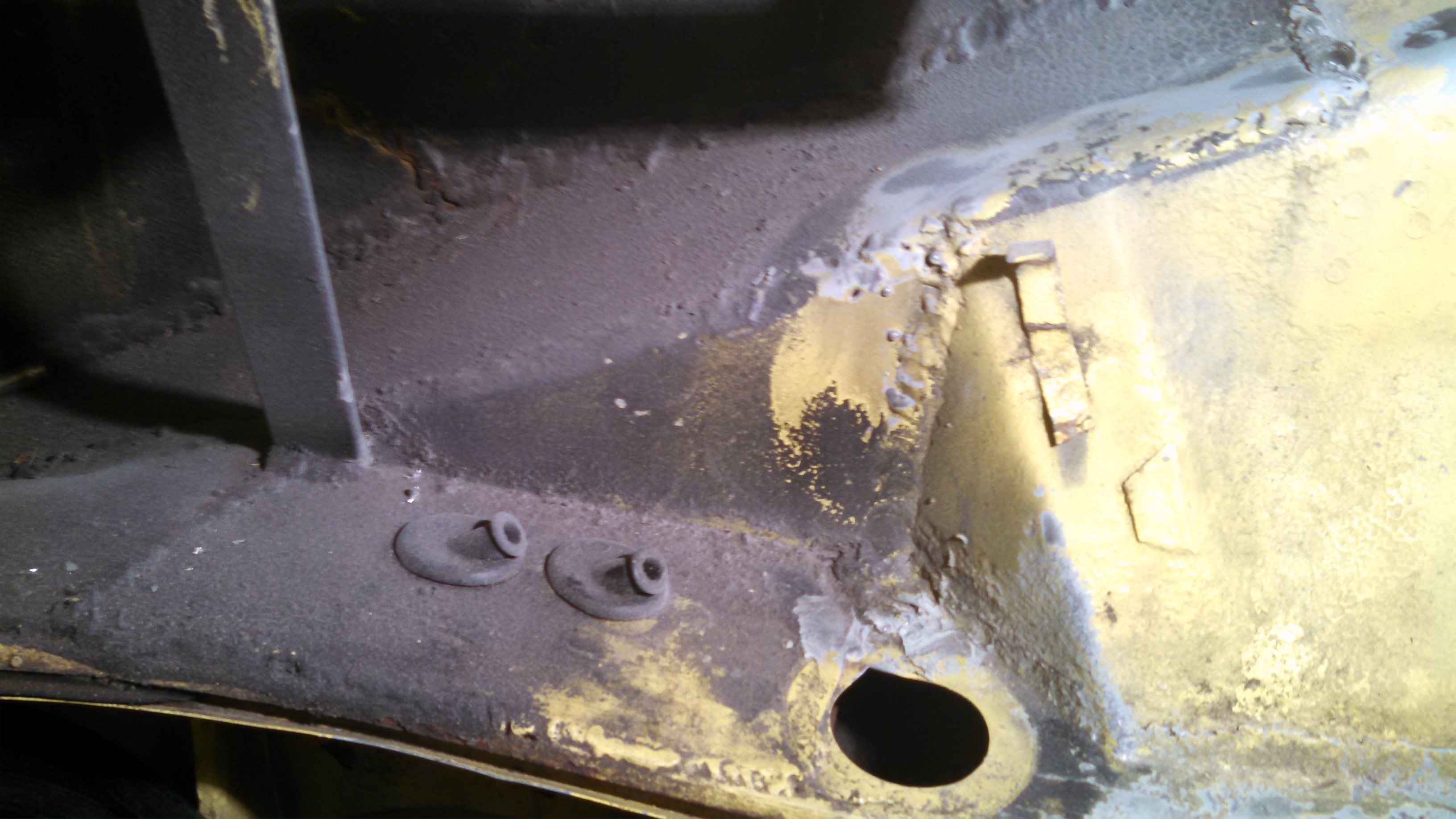

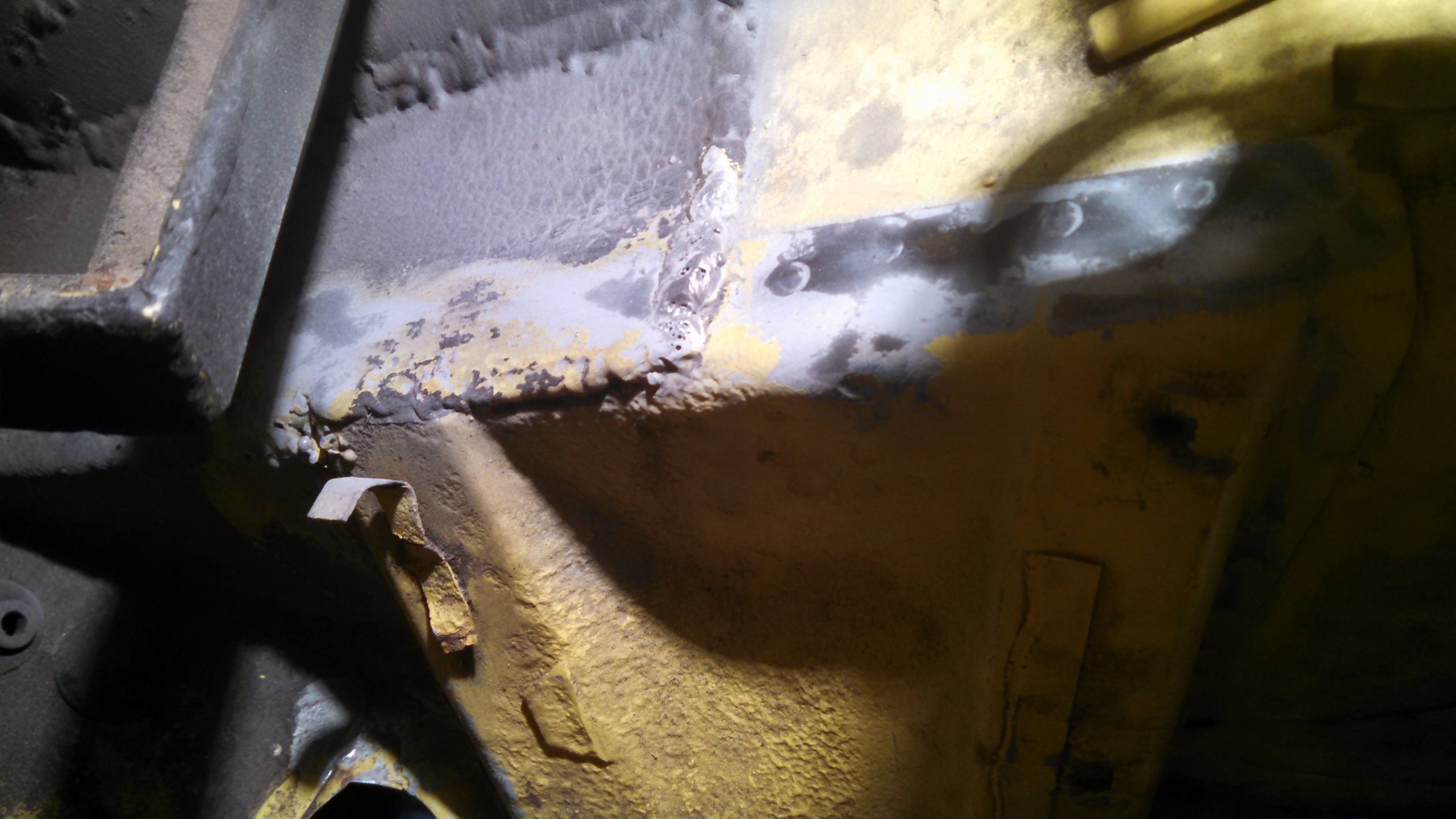

I am so discouraged. I got my suspension console in the mail this week and snuck off to the shop to work on the car for an hour or so. Started to clear the way to cut out the old console and started grinding to get at the welds only to realize that I had "patches" over several sections that I need to get to in order to cut out the welds and remove the console.
Pictures below. Now I am back to thinking that I should just patch and put it back together and save the new console for when I am ready to cut out ALL of this mess.
Any words of encouragement of advice? Attached ImageAttached Image
