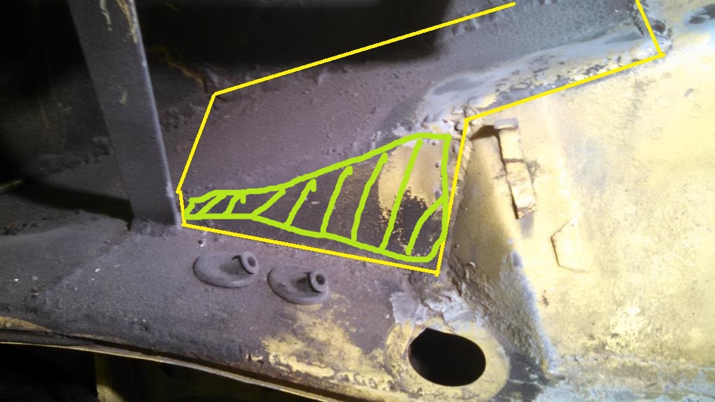

I think that what I have is a home brewed version of that hell hole repair kit, but it was applied over what they thought was a good console, that had started to rust but just was not finished yet.
I suppose I must do something. George at AA suggest grinding off the patch, removing the console and looking. He is optimistic about its potential to not be ruined, but either way it is a win for him. I on the other had could be in a lot of trouble.
I think both your assumption and Georges advise is dead on.
The problem is the PO made no provisions for the removing of the console in the future.
You need to figure out if the part I crayoned in is a cover. I think so looking at the weld over the console flange on the right. But don't assume.

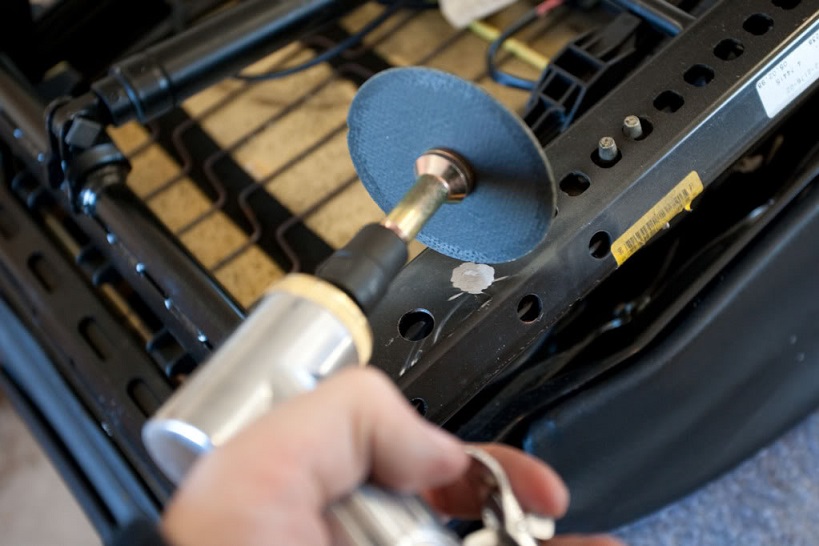

The trick is to become an artist with the cut off wheel in short order. Your going to use the thin edge to grind down JUST the weld, not the panel surfaces.
I'm going to start using a cut off wheel like this also. Gives you way more control.
Please wear a face shield when using the cut off wheel without a guard. They are pretty susceptible to chipping
